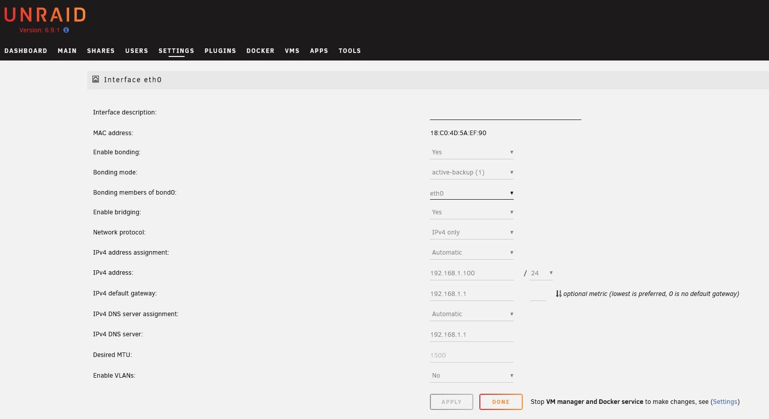

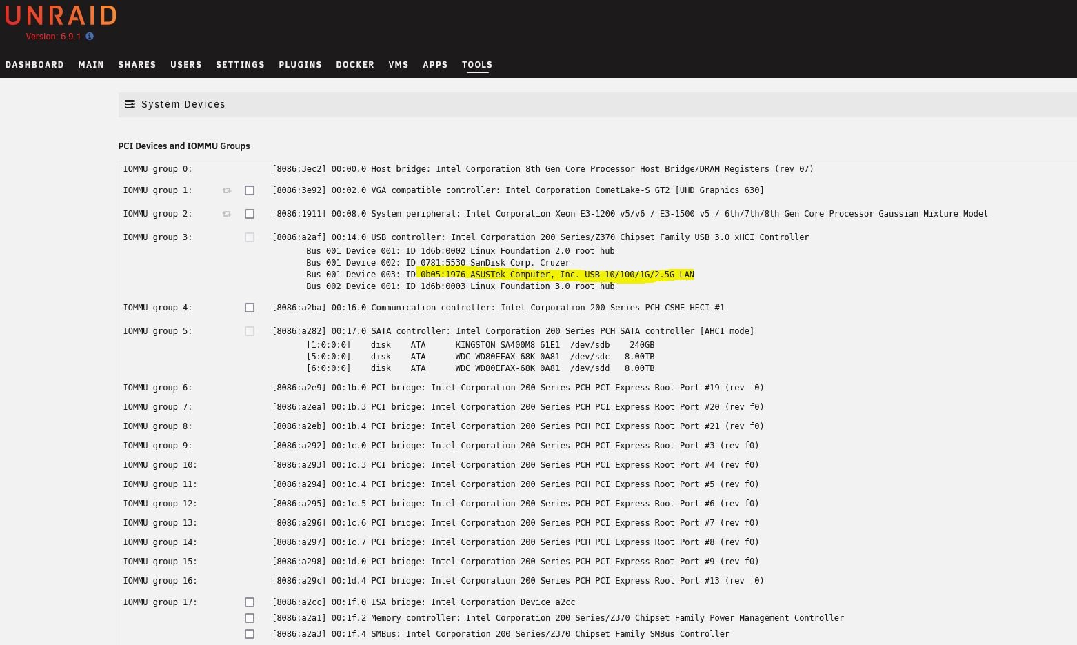

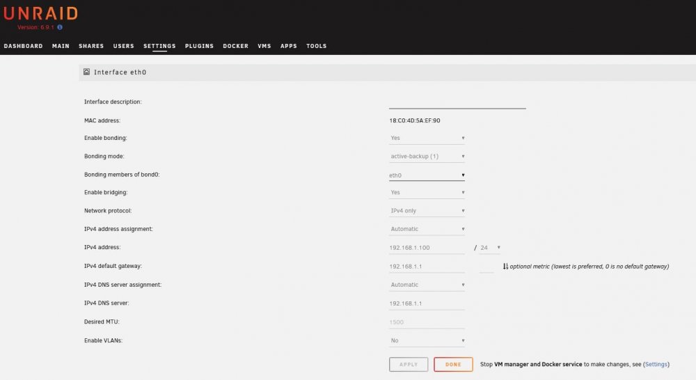

  14. unraid-diagnostics-20210913-1228.zip Attached.
