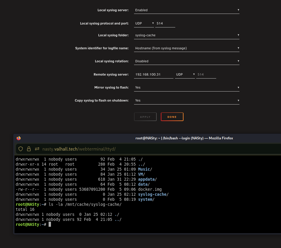

Hmm... well... seems like something not rly working. I had to take the syslog server offline a couple of days ago, but that should nethertheless write it locally if enabled, right?
Unraid 7.2.3 - Randomly freezing - kills all remote connections
It is and I thought it would have been added to the diagnostics. Where is it usually being stored? I have also set 'write to flash: true'
hi all, I for a couple of days now experience freezes when I am trying to interact with maybe radarr or overseer.. I also had this when I was starting a VM. Just before the Windows boot logo disappeared, the Server and UI froze. I am unable to SSH into the server if that happens, so I painfully have to hard kill the server. I tried to close tabs and wait for a while, but it didn't came back. Is my rig dying or just the stick having hickups? II found these lines interesting. Feb 4 19:04:53 NASty move: Action ended at: 19:04:53 Feb 4 19:04:53 NASty move: Elapsed time: 0 sec Feb 4 19:04:53 NASty move: ****************************************************************** WE ARE DONE ! **************************************************************** Feb 4 19:10:16 NASty emhttpd: read SMART /dev/sdh Feb 4 19:10:16 NASty emhttpd: read SMART /dev/sdg Feb 4 19:10:16 NASty emhttpd: read SMART /dev/sdd Feb 4 19:10:16 NASty emhttpd: read SMART /dev/sdf Feb 4 19:18:13 NASty winbindd[2704]: [2026/02/04 19:18:11.659256, 0, traceid=6164] ../../source3/winbindd/winbindd_samr.c:71(open_internal_samr_conn) Feb 4 19:18:13 NASty winbindd[2704]: open_internal_samr_conn: Could not connect to samr pipe: NT_STATUS_CONNECTION_DISCONNECTED Feb 4 19:31:45 NASty emhttpd: spinning down /dev/sdh Feb 4 19:33:35 NASty emhttpd: spinning down /dev/sdg Feb 4 19:35:08 NASty winbindd[2704]: [2026/02/04 19:35:08.248834, 0, traceid=6200] ../../source3/winbindd/winbindd_samr.c:71(open_internal_samr_conn) Feb 4 19:35:08 NASty winbindd[2704]: open_internal_samr_conn: Could not connect to samr pipe: NT_STATUS_CONNECTION_DISCONNECTED Feb 4 19:35:42 NASty emhttpd: spinning down /dev/sdd Feb 4 19:42:24 NASty sshd-session[3014530]: Connection from 192.168.1.100 port 38368 on 192.168.200.2 port 8908 rdomain "" Feb 4 19:42:48 NASty init: Switching to runlevel: 0 Feb 4 19:42:49 NASty shutdown[3014738]: shutting down for system haltU can check the full log here: nasty-diagnostics-20260204-2105.zip
