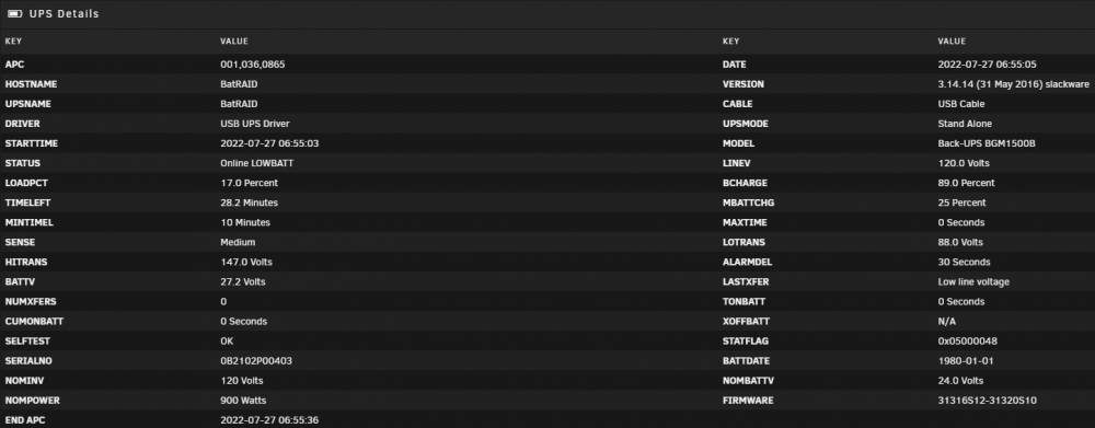

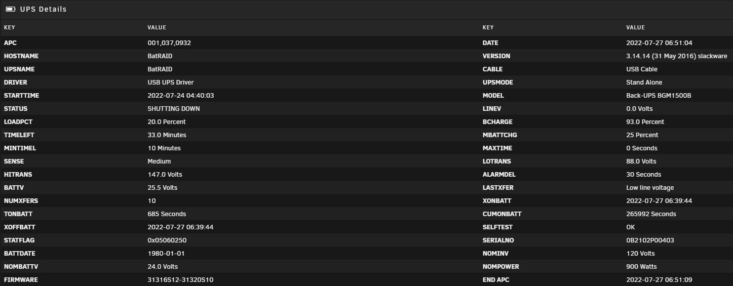

  18. Other than the PC and server, there's not much on this circuit. There is a laser printer, so I printed a test page while watching the UPS's line in voltage display. During the warmup and printing, it dropped as low as 117V. Without the printer running, it reads 121 or 122. When I get a chance, I can get a multimeter out and measure the RMS voltage that way. The battery shows fully charged now with a voltage of 27.9. The mode is "on battery". Is it possible that the 100W (or maybe a little more) load of the PC and server caused the battery voltage to read lower when the battery really was supplying power? I don't think the problem is that my mains power is causing the UPS to be in battery mode. Ever since I set up the UPS, Unraid shows it as "on battery" whenever the UPS is fully charged, even though the display on the UPS itself indicates it's "online" and not using the battery. The link I referenced at the end of the first post seems to suggest APCUPSD has an issue reading the status of this UPS.
  19. Yes, I'm using the cable that came with the UPS. When unplugging the USB cable from the server, this is all I got in the system log: When reconnecting it to a different USB port, I got a flurry of entries: The end result is the same though--APCUPSD thinks the UPS is on batteries. I tried several USB ports, including both 3.0 and 2.0 ports, and APCUPSD showed on battery for all of them. I simulated a power failure by unplugging the UPS from the wall outlet. For some reason, the server initiated a shutdown well before I would have expected it. My PC, which is monitoring my server's APCUPSD status, did not initiate a shutdown even though it's APCUPSD settings should shut it down sooner. I took a couple screenshots during the process; the first is when I disconnected the power, and the second is after I plugged it back in and the server had rebooted. The voltage did indeed drop, and the battery's display indicated it was disconnected from mains power and discharging.

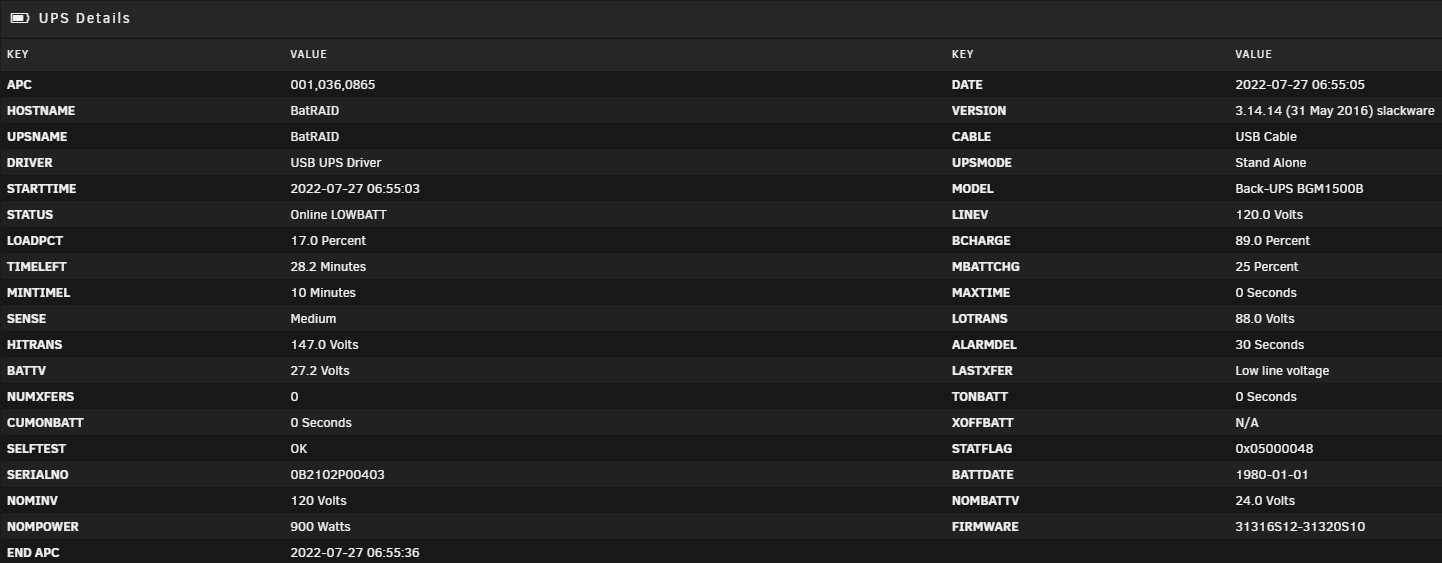

  20. Whenever my UPS (APC BGM1500) gets to 100%, Unraid's UPC monitor shows my UPC as "On Battery" and sends out a power failure alert. Fortunately, this doesn't impact my actual protection, as I have shutdown of my server (and another connected PC) based off of battery percentage and runtime remaining. However, I want to get email notifications for actual power failures, but this issue is leading to many nuisance notifications and is preventing me from getting a notification when power is actually lost. Here's all of the log entries from or mentioning apcupsd. Today, the 26th, there where actual power failures, though I don't know the exact timings. Note that there are a couple "Power failure" entries prior to today; no actual power failure occurred during these times, and that the last entry is also for a power failure. For today's entries, I suspect all of the "Power is back" entries actually correspond to power returning, but the subsequent "Power failure" entries occurred whenever the UPS reached 100%. Currently, Unraid is displaying "On Battery" while the LCD on my UPS says it's online and the "On Battery" LED is not illuminated. Is there any configuration I can do in Unraid to correct this behavior? I've searched both APCUPSD's and BGM1500's manuals and haven't been able to find something related I can change. Edit: I only found one other reference to a similar issue online: https://forum.netgate.com/post/1032036. The link doesn't seem to always take you to the right spot, so it's the post from March 12 at 1:40 PM. It seems APCUPSD might be seeing the status as "unknown" once it reaches 100% for some reason.
