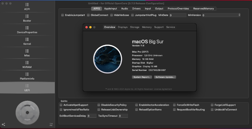

  5. Thanks for your fast replies! I've tried it on a different vm and then it's working. I am currently running Big Sur, and used OpenCore Configurator 0.7.3 to set it to an Mac Pro 2013 like in the video.

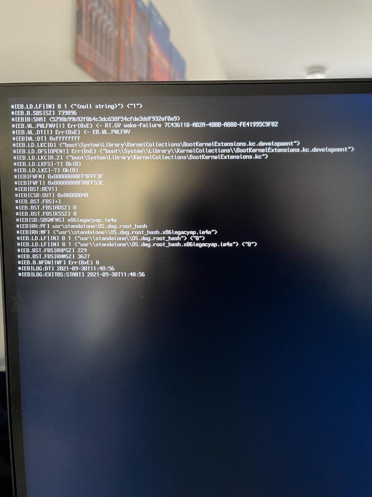

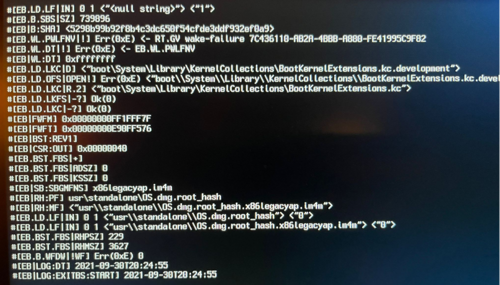

  7. I've just bougth a second hand RX 580 and it doesn't work out of the box. Have to spend some time for troubleshooting. When I'm using VNC it works flawless. But when I change to my RX 580 it doesn't work. It's stuck before loading the apple logo etc.

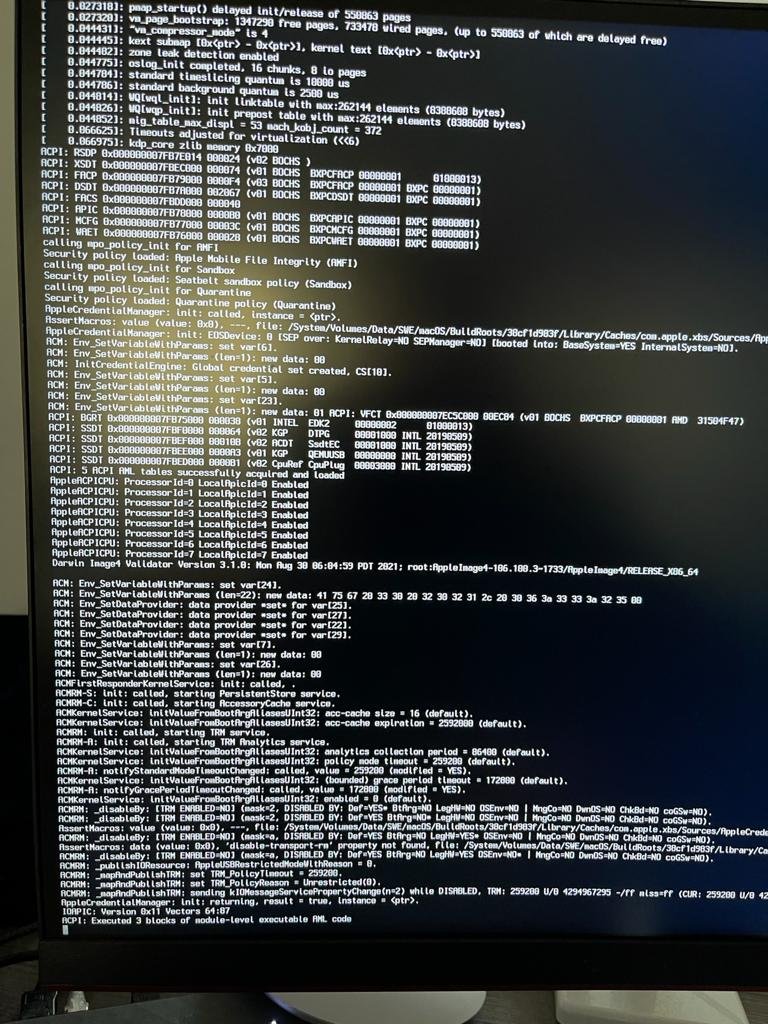

  10. Hi, I am trying to set this up with a 3070TI. The VM boots, I can see the disk I need to boot in. When I click the disk it's loading till the line: ACPI: Executed 3 blocks of module-level executable AML code. Ater there it's stuck. When I boot the VM, this gets in the log: 2021-09-23T14:21:36.937949Z qemu-system-x86_64: warning: host doesn't support requested feature: CPUID.01H:ECX.pcid [bit 17] 2021-09-23T14:21:36.939104Z qemu-system-x86_64: warning: host doesn't support requested feature: CPUID.01H:ECX.pcid [bit 17] 2021-09-23T14:21:36.939806Z qemu-system-x86_64: warning: host doesn't support requested feature: CPUID.01H:ECX.pcid [bit 17] 2021-09-23T14:21:36.940587Z qemu-system-x86_64: warning: host doesn't support requested feature: CPUID.01H:ECX.pcid [bit 17] 2021-09-23T14:21:36.941392Z qemu-system-x86_64: warning: host doesn't support requested feature: CPUID.01H:ECX.pcid [bit 17] 2021-09-23T14:21:36.942212Z qemu-system-x86_64: warning: host doesn't support requested feature: CPUID.01H:ECX.pcid [bit 17] Is there some way to fix this?
