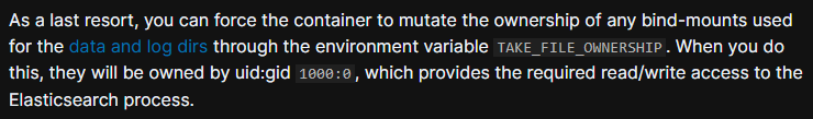

  9. Ok, well I tried the alternative elasticsearch template by d8sychain and got it working by adding this environment variable. Not sure what the implications are, clearly something weird going on with my permissions. It didn't work with this template.
  10. Hi, using the default settings, any idea what would be causing permission related issues? mkdir: cannot create directory '/config/data': Permission denied mkdir: cannot create directory '/config/logs': Permission denied mkdir: cannot create directory '/config/jvm.options.d': Permission denied chown: changing ownership of '/config': Operation not permitted cp: cannot create regular file '/config/elasticsearch.yml': Permission denied cp: cannot create regular file '/config/jvm.options': Permission denied cp: cannot create regular file '/config/log4j2.properties': Permission denied cp: cannot create regular file '/config/my-plugins.txt': Permission denied comm: /config/my-plugins.txt: No such file or directory comm: /config/my-plugins.txt: No such file or directory Exception in thread "main" java.nio.file.NoSuchFileException: /config/jvm.options at java.base/sun.nio.fs.UnixException.translateToIOException(UnixException.java:92) at java.base/sun.nio.fs.UnixException.rethrowAsIOException(UnixException.java:106) at java.base/sun.nio.fs.UnixException.rethrowAsIOException(UnixException.java:111) at java.base/sun.nio.fs.UnixFileSystemProvider.newByteChannel(UnixFileSystemProvider.java:218) at java.base/java.nio.file.Files.newByteChannel(Files.java:375) at java.base/java.nio.file.Files.newByteChannel(Files.java:426) at java.base/java.nio.file.spi.FileSystemProvider.newInputStream(FileSystemProvider.java:420) at java.base/java.nio.file.Files.newInputStream(Files.java:160) at org.elasticsearch.tools.launchers.JvmOptionsParser.readJvmOptionsFiles(JvmOptionsParser.java:167) at org.elasticsearch.tools.launchers.JvmOptionsParser.jvmOptions(JvmOptionsParser.java:128) at org.elasticsearch.tools.launchers.JvmOptionsParser.main(JvmOptionsParser.java:95) ** Press ANY KEY to close this window **
  11. Hi, Im try to set up this container with the latest version 8.2.2. I'm getting the following error, looks like it's permission related but I have no idea why the default template wouldn't have the required permissions? ElasticsearchUncaughtExceptionHandler","elasticsearch.node.name":"b046ed08a40e","elasticsearch.cluster.name":"docker-cluster","error.type":"org.elasticsearch.bootstrap.StartupException","error.message":"java.lang.IllegalStateException: failed to obtain node locks, tried [/usr/share/elasticsearch/data]; maybe these locations are not writable or multiple nodes were started on the same data path?","error.stack_trace":"java.lang.IllegalStateException: failed to obtain node locks, tried [/usr/share/elasticsearch/data]; maybe these locations are not writable or multiple nodes were started on the same data path?\nLikely root cause: java.nio.file.NoSuchFileException: /usr/share/elasticsearch/data/node.lock\n\tat java.base/sun.nio.fs.UnixException.translateToIOException(UnixException.java:92)\n\tat java.base/sun.nio.fs.UnixException.rethrowAsIOException(UnixException.java:106)\n\tat java.base/sun.nio.fs.UnixException.rethrowAsIOException(UnixException.java:111)\n\tat java.base/sun.nio.fs.UnixPath.toRealPath(UnixPath.java:825)\n\tat org.apache.lucene.store.NativeFSLockFactory.obtainFSLock(NativeFSLockFactory.java:94)\n\tat org.apache.lucene.store.FSLockFactory.obtainLock(FSLockFactory.java:43)\n\tat org.apache.lucene.store.BaseDirectory.obtainLock(BaseDirectory.java:44)\n\tat org.elasticsearch.env.NodeEnvironment$NodeLock.<init>(NodeEnvironment.java:222)\n\tat org.elasticsearch.env.NodeEnvironment$NodeLock.<init>(NodeEnvironment.java:197)\n\tat org.elasticsearch.env.NodeEnvironment.<init>(NodeEnvironment.java:276)\n\tat org.elasticsearch.node.Node.<init>(Node.java:404)\n\tat org.elasticsearch.node.Node.<init>(Node.java:291)\n\tat org.elasticsearch.bootstrap.Bootstrap$5.<init>(Bootstrap.java:234)\n\tat org.elasticsearch.bootstrap.Bootstrap.setup(Bootstrap.java:234)\n\tat org.elasticsearch.bootstrap.Bootstrap.init(Bootstrap.java:358)\n\tat org.elasticsearch.bootstrap.Elasticsearch.init(Elasticsearch.java:166)\n\tat org.elasticsearch.bootstrap.Elasticsearch.execute(Elasticsearch.java:157)\n\tat org.elasticsearch.common.cli.EnvironmentAwareCommand.execute(EnvironmentAwareCommand.java:81)\n\tat org.elasticsearch.cli.Command.mainWithoutErrorHandling(Command.java:112)\n\tat org.elasticsearch.cli.Command.main(Command.java:77)\n\tat org.elasticsearch.bootstrap.Elasticsearch.main(Elasticsearch.java:122)\n\tat org.elasticsearch.bootstrap.Elasticsearch.main(Elasticsearch.java:80)\nFor complete error details, refer to the log at /usr/share/elasticsearch/logs/docker-cluster.log\n"} uncaught exception in thread [main] java.lang.IllegalStateException: failed to obtain node locks, tried [/usr/share/elasticsearch/data]; maybe these locations are not writable or multiple nodes were started on the same data path? Likely root cause: java.nio.file.NoSuchFileException: /usr/share/elasticsearch/data/node.lock at java.base/sun.nio.fs.UnixException.translateToIOException(UnixException.java:92) at java.base/sun.nio.fs.UnixException.rethrowAsIOException(UnixException.java:106) at java.base/sun.nio.fs.UnixException.rethrowAsIOException(UnixException.java:111) at java.base/sun.nio.fs.UnixPath.toRealPath(UnixPath.java:825) at org.apache.lucene.store.NativeFSLockFactory.obtainFSLock(NativeFSLockFactory.java:94) at org.apache.lucene.store.FSLockFactory.obtainLock(FSLockFactory.java:43) at org.apache.lucene.store.BaseDirectory.obtainLock(BaseDirectory.java:44) at org.elasticsearch.env.NodeEnvironment$NodeLock.<init>(NodeEnvironment.java:222) at org.elasticsearch.env.NodeEnvironment$NodeLock.<init>(NodeEnvironment.java:197) at org.elasticsearch.env.NodeEnvironment.<init>(NodeEnvironment.java:276) at org.elasticsearch.node.Node.<init>(Node.java:404) at org.elasticsearch.node.Node.<init>(Node.java:291) at org.elasticsearch.bootstrap.Bootstrap$5.<init>(Bootstrap.java:234) at org.elasticsearch.bootstrap.Bootstrap.setup(Bootstrap.java:234) at org.elasticsearch.bootstrap.Bootstrap.init(Bootstrap.java:358) at org.elasticsearch.bootstrap.Elasticsearch.init(Elasticsearch.java:166) at org.elasticsearch.bootstrap.Elasticsearch.execute(Elasticsearch.java:157) at org.elasticsearch.common.cli.EnvironmentAwareCommand.execute(EnvironmentAwareCommand.java:81) at org.elasticsearch.cli.Command.mainWithoutErrorHandling(Command.java:112) at org.elasticsearch.cli.Command.main(Command.java:77) at org.elasticsearch.bootstrap.Elasticsearch.main(Elasticsearch.java:122) at org.elasticsearch.bootstrap.Elasticsearch.main(Elasticsearch.java:80) For complete error details, refer to the log at /usr/share/elasticsearch/logs/docker-cluster.log ** Press ANY KEY to close this window **
