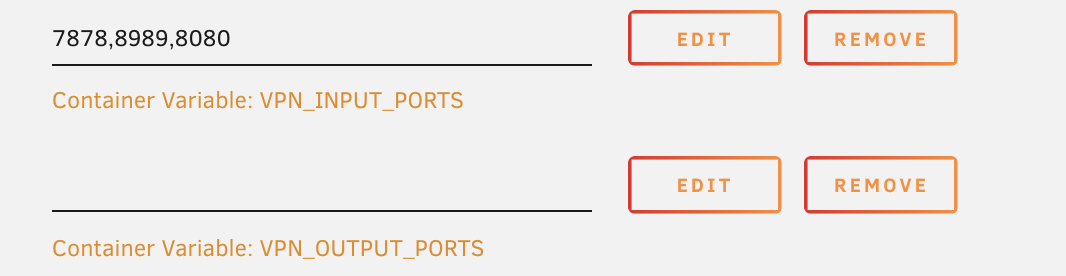

  3. No issues starting them, that was just the screenshot. I managed to get the WebUI up by adding the WebUI ports into delugeVPN . I can now log in to Sonarr and Radarr, however however I have no idea what to put in the output ports. See screenshot.
  4. Hi there, a big NOOB here. I have just set up my first UNRAID, and installed binhex (delugevpn, sonarr, radarr, sabnsbd) with the intention of running sonarr/radarr/sab via delugevpn. I followed videos (the most recent ones) from https://www.youtube.com/c/SpaceinvaderOne/ Delugevpn works but regardless of how many times i redo this i can never get sonarr or radarr webUI to run,. I understand it won't be available via the unraid interface and i have to type the IP in (for me an example is 10.0.0.19:7878) however I receive this error the site can't be reached.... My delugevpn template has been updated and when i download ubintu via torrent it seems to work. I use the curl command to confirm my IP is running via my PIA vpn, but it appears I can't run anything other container through it. I also include a screenshot of (1 - deluge, 2 - Sonarr,) Any advice or assistance would be great. If I need logs, please let me know specifically what i need and where from and I will upload them. Cheers! Screen Recording 2021-10-17 at 8.31.31 pm.mov Screen Recording 2021-10-17 at 8.32.50 pm.mov

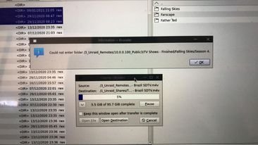

  6. Thanks for your advice and assistance. With it, and a bit of googling and youtubing was able to finally mount them as smb shares and install Krusader. Just attempted a file transfer from smb to a unraid share. Seems to work but getting some 'could not enter folder' errors. Not sure what this is from. I did a bit of googling but unable to find anything. Have you come across this before?

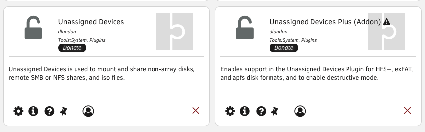

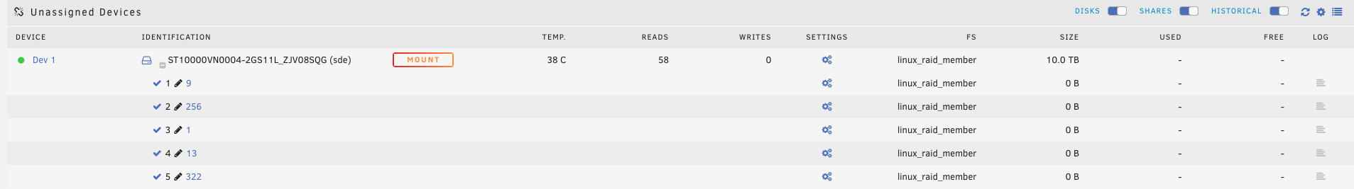

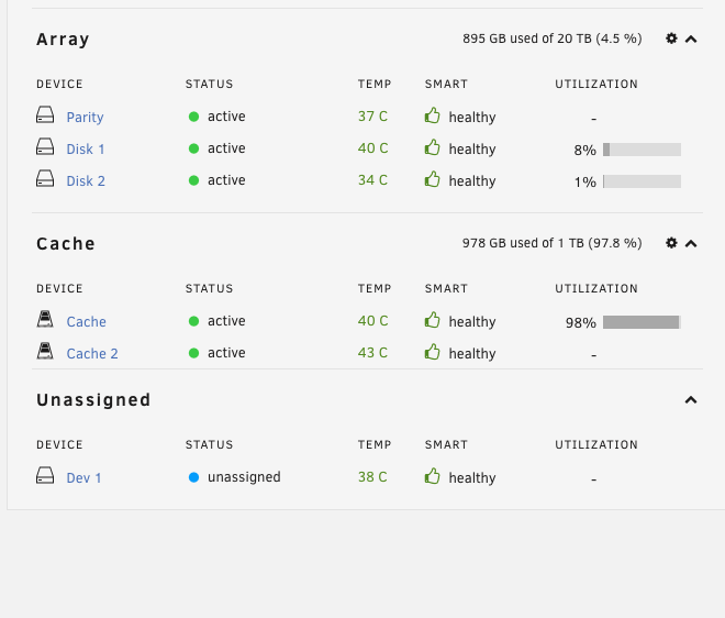

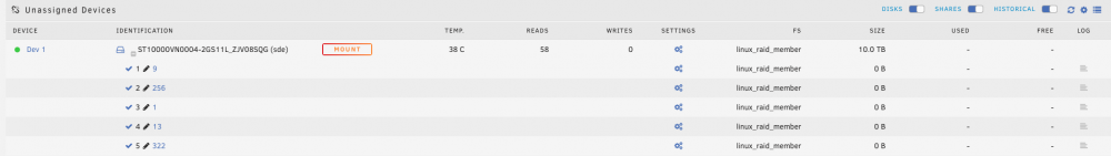

  7. I have 3 drives sorry (in the QNAP) and about 8tb full each. So I think the current approach will take weeks. I just moved 5 movie folders across and it took 2 hours. There are about 600 in that drive. I have placed one of the drives in the Unraid server and this is what i see. I note it has FS as linux_raid_member (is this what you are after?). When I select Mount it goes to mounting for a split second and then just goes back to mount.. I am unsure if i am doing it incorrectly or if it was successful and I haven't realised. I include a second screenshot of my dashboard. Note: If this drive format isn't going to work the way it is, do you think plugging in a external drive to QNAP - dumping 8tb on to it (I would need to confirm with you what format the external drive should be for unraid to read/mount) and then plug this via usb into my unraid server and dump across that way? Thanks again for assisting.
  8. The file type is 'thin volume' and i can see RAID Group 1 in the dashboard of my qnap when i hover the mouse. I have installed these but not sure if they are the correct ones...
