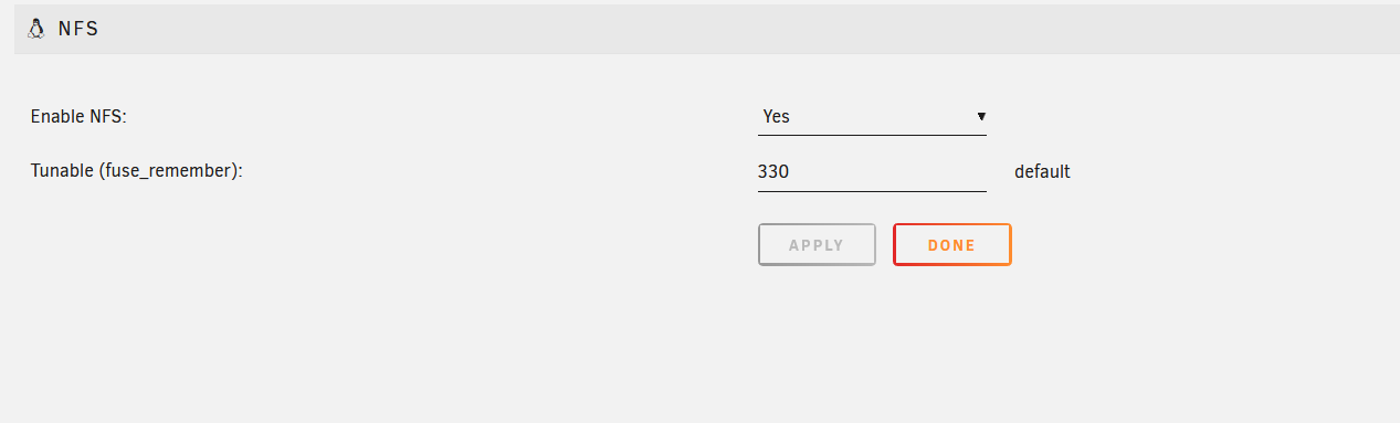

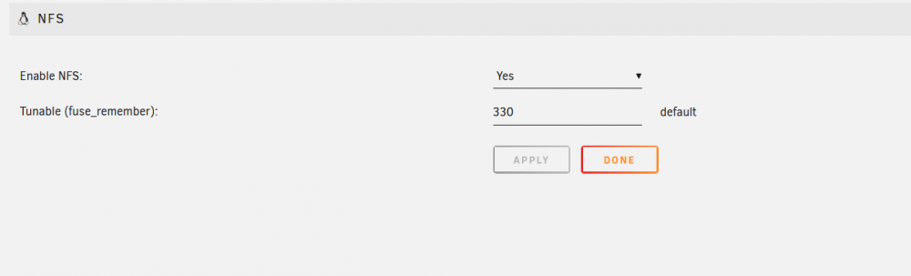

  11. Hi Mate How do I change to NFSv4, all i see is this: (see screenshot)
  12. That is my mounted share ip address. It works so unsure of why the error occurs.
  13. HI all. my sys log is filling up to 100% and requires constant restarts quickly. This is the command: du -xh --max-depth=1 /var/log/ | sort -rh | head -n 10 59M /var/log/ 20K /var/log/samba 12K /var/log/libvirt 8.0K /var/log/pkgtools 4.0K /var/log/nginx 0 /var/log/swtpm 0 /var/log/pwfail 0 /var/log/plugins 0 /var/log/nfsd my Syslog has the same error over and over: Dec 8 15:52:50 Tower kernel: NFS: server 10.253.0.1 error: fileid changed Dec 8 15:52:50 Tower kernel: fsid 0:68: expected fileid 0x350000001dc4ce, got 0x350000001dcc22 Any ideas? Diagnostic attached tower-diagnostics-20211208-1933.zip
