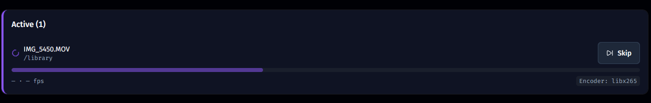

  7. Hi, I wanted to try the new black bars settings (thanks again !) in x265 (CPU) but realize that it just does nothing... I've even tried previous images, including the first one I tried (2.13.0 which I'm almost sure was working) but cannot get any encoding to work... I have verified all my settings, tried from fresh images, still the same behavior : when I click Encode now it goes to the queue and shows the name of the file with no progress at all : My Unraid CPU does absolutely nothing, and even the Test Encode gives an error : Encoder logs : Container logs : EDIT : forgot to post the Diagnostic Report : x265-butler diagnostics report
