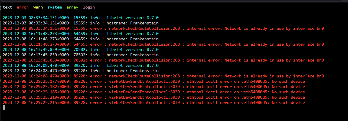

I deleted the new libvirt.img file and made sure VM Manager was set to point to the original location. I disabled Docker and VM then I rebooted. When it came back online, I confirmed that the VM Manager location was the same and it was. I started Docker and VM. When I checked VM, there were still no VMs listed. I looked at the libvirt log and I see an error about the Network interface being already in use by interface br0 - I don't know where this is coming from because in VM Manager, the Default network source is virbr0 I see this under Libvirt volume info - Should I check Correct file system errors and click 'scrub'?

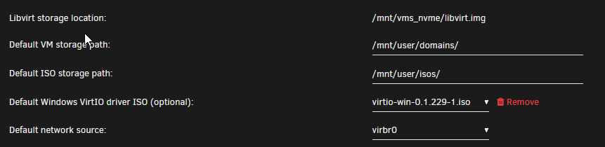

Adding some information from the libvirt log I see the Network error but in the VM Manager the Default Network Source is virbr0
Using 6.12.6, I lost all of my virtual machines by specifying a different location for libvirt storage. Can they be restored and if so, how?
Hello, My goal was to move the Libvirt storage location from /mnt/vms_nvme/libvirt.img to a new larger NVME - /mnt/vms2_nvme/libvirt.img. I did not delete the image file from the original location or delete any other files. I disabled VM using VM Manager and updated the location to /mnt/vms2_nvme/libvirt.img and then I enabled VM. When I checked VM's there was nothing there and then I thought it was because there was no libvirt.img file in the new location. I wanted to go back to the original location and when I did that, there were still no VM's listed. Is there a way I can restore my original setup? I have attached the diagnostics for your review. Thanks in advance for anyone who can help. frankenstein-diagnostics-20231208-1141.zip

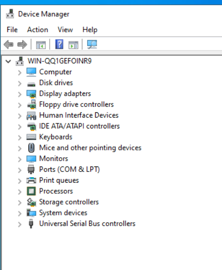

Unable to get a network connection installed to Win 2022 server after new vm setup

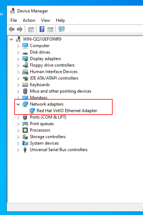

I was able to test this on a Windows 2016 server that had the same issue. I generated a mac address and then made the network changes: I was able to Update this with no problem. I checked the Device Manager on the vm and the network connection was there and working fine! Thanks for your help!!! Rick

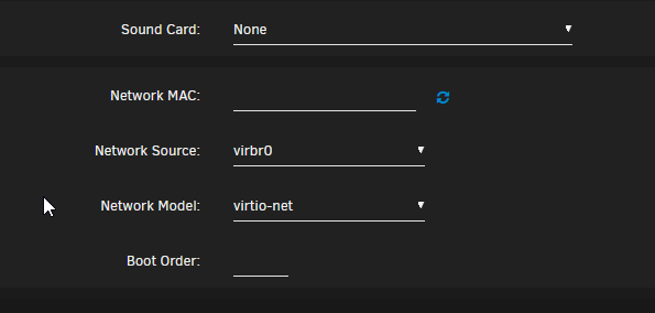

It's working! I was able to change my settings - It didn't seem to 'stick' until I generated a mac address and then when I updated, it saved the setting. Do you think that by creating the new vm and pointing to the existing disk, something was 'reset'? Since it is working, I can do some experimenting now and determine what made it work - if I can.
No matter what combination I try - Network source to bro - makes no difference. After I click update, the settings go back to this:
