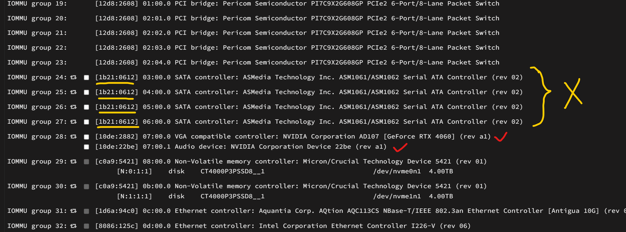

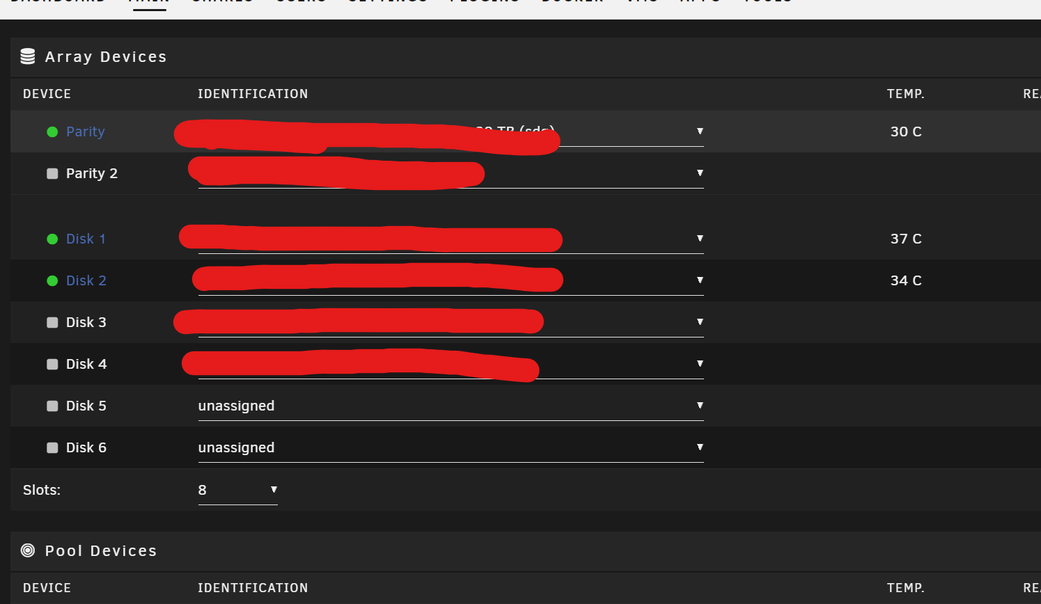

  1. But even I don't check boxes the 24 25 26 27 , the ASMedia sata card will auto passthrough to my vm, My unraid can't use those drives.
  2. Hi guys, Does anybody know how to disable ASMedia ASM1061/ASM1062 passthrough to my vm instead force the card stay with unraid system. Because I need to enable my vt-d to allow my graphic card passthrough to my vm, but I don't want my ASM1061/ASM1062 sata card passthrough, if it passthrough then All my Hard drive are missing. Any one have idea?
  3. I tried, but still not working if I use vt-d then the pcie card passthrough automatically, If I disable vt-d then all my hard drive linked to this pcie sata card are missing.
  4. Hi guys, I just install StarTech 8P6G-PCIE-SATA-CARD 8 Port SATA PCIe Card to my unraid in pcie slot 2. However it auto passthrough to vm when vt-d enable, But if I vt-d disable all my drive came back. I have to make my vt-d enable because I need to use my GPU on pcie slot 1 with my vm. In case, is there any way I can leave vt-d enable, and disable my pcie slot 2 (the sata card) to passthrough? OR is there any way I can disable vt-d, let my pcie slot 2 sata card stay with my unraid, and only passthrough my pcie slot 1 GPU to my vm?
