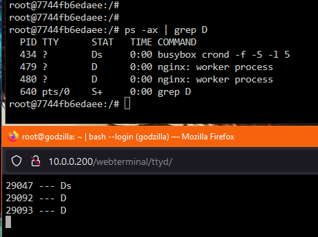

Random Freeze/Lockout since 6.12.10
also guys monitor CPU load average in top and if processes get stuck with: unraid CLI: while [ 1 -eq 1 ]; do ps -ax | awk '{ print $1,"---", $3 }' | grep D | grep -v PID && sleep 2 && clear; done to monitor waiting processes PROCESS STATE CODES D uninterruptible sleep (usually IO) if lines appear and do not disappear, these processes build up and bring the system down, at least in my case. And with knowing which processes you can tell what docker is the reason - if it is a docker and if it is processes with status D.
Random Freeze / 6.12.10 / Docker Server Error + CLI unresponsive
to close this topic for now: a lot of processes between nextcloud-nginx and swag-nginx waiting for each other until everything is overwhelmed and unresponsive = CPU load avg rises into oblivion. And they were not killable! unraid CLI: while [ 1 -eq 1 ]; do ps -ax | awk '{ print $1,"---", $3 }' | grep D | grep -v PID && sleep 2 && clear; done to monitor waiting processes PROCESS STATE CODES D uninterruptible sleep (usually IO) I am trying do ditch nextcloud docker and all associated (postgres, swag, redis) and start anew with nextcloud-AIO. So not a specific fix since I have no clue why this happens. Also I want to change way too much around the whole infrastructure... switch, router, firewall etc. So I try nextcloud-AIO instead of fixing this (tried 15h+ I am not willing to invest more time since I do not see any light). ¯\_(ツ)_/¯ Wish me luck on my further journey.
to summarise many hours searching: Main issue is that nextcloud and swag docker are opening nginx processes again and again when communicating ,which all are waiting and nothing happens = load average rises. In this SYSLOG nextcloud stopped responding pretty exact at 21:45:00. Is it normal that everytime I start a docker-container that eth0=vethXYZ gets renamed? Like: May 22 21:16:00 godzilla kernel: eth0: renamed from veth2b5dd4d May 22 21:16:00 godzilla kernel: IPv6: ADDRCONF(NETDEV_CHANGE): vethca560dc: link becomes ready May 22 21:42:00 godzilla kernel: br-5d08daaed772: port 1(vethca560dc) entered disabled state May 22 21:42:00 godzilla kernel: veth2b5dd4d: renamed from eth0 May 22 21:42:00 godzilla rsyslogd: cannot connect to 10.0.0.200:514: Connection refused [v8.2102.0 try https://www.rsyslog.com/e/2027 ] May 22 21:42:00 godzilla kernel: br-5d08daaed772: port 1(vethca560dc) entered disabled state May 22 21:42:00 godzilla kernel: device vethca560dc left promiscuous mode May 22 21:42:00 godzilla kernel: br-5d08daaed772: port 1(vethca560dc) entered disabled state May 22 21:42:01 godzilla kernel: br-5d08daaed772: port 1(vethdd22d09) entered blocking state May 22 21:42:01 godzilla kernel: br-5d08daaed772: port 1(vethdd22d09) entered disabled state May 22 21:42:01 godzilla kernel: device vethdd22d09 entered promiscuous mode May 22 21:42:01 godzilla kernel: br-5d08daaed772: port 1(vethdd22d09) entered blocking state May 22 21:42:01 godzilla kernel: br-5d08daaed772: port 1(vethdd22d09) entered forwarding state May 22 21:42:01 godzilla kernel: eth0: renamed from veth777bb11 May 22 21:42:01 godzilla kernel: IPv6: ADDRCONF(NETDEV_CHANGE): vethdd22d09: link becomes ready May 22 21:44:27 godzilla kernel: br-5d08daaed772: port 1(vethdd22d09) entered disabled state May 22 21:44:27 godzilla rsyslogd: cannot connect to 10.0.0.200:514: Connection refused [v8.2102.0 try https://www.rsyslog.com/e/2027 ] May 22 21:44:27 godzilla kernel: veth777bb11: renamed from eth0 May 22 21:44:27 godzilla kernel: br-5d08daaed772: port 1(vethdd22d09) entered disabled state May 22 21:44:27 godzilla kernel: device vethdd22d09 left promiscuous mode May 22 21:44:27 godzilla kernel: br-5d08daaed772: port 1(vethdd22d09) entered disabled state May 22 21:45:39 godzilla kernel: br-5d08daaed772: port 1(veth47ec6af) entered blocking state May 22 21:45:39 godzilla kernel: br-5d08daaed772: port 1(veth47ec6af) entered disabled state May 22 21:45:39 godzilla kernel: device veth47ec6af entered promiscuous mode May 22 21:45:39 godzilla rsyslogd: cannot connect to 10.0.0.200:514: Connection refused [v8.2102.0 try https://www.rsyslog.com/e/2027 ] May 22 21:45:39 godzilla kernel: eth0: renamed from veth7c4d745 May 22 21:45:39 godzilla kernel: IPv6: ADDRCONF(NETDEV_CHANGE): veth47ec6af: link becomes ready May 22 21:45:39 godzilla kernel: br-5d08daaed772: port 1(veth47ec6af) entered blocking state May 22 21:45:39 godzilla kernel: br-5d08daaed772: port 1(veth47ec6af) entered forwarding state May 22 21:45:53 godzilla kernel: br-5d08daaed772: port 2(veth62fab02) entered blocking state May 22 21:45:53 godzilla kernel: br-5d08daaed772: port 2(veth62fab02) entered disabled state May 22 21:45:53 godzilla kernel: device veth62fab02 entered promiscuous mode May 22 21:45:53 godzilla kernel: eth0: renamed from veth018449d May 22 21:45:53 godzilla kernel: IPv6: ADDRCONF(NETDEV_CHANGE): veth62fab02: link becomes ready May 22 21:45:53 godzilla kernel: br-5d08daaed772: port 2(veth62fab02) entered blocking state May 22 21:45:53 godzilla kernel: br-5d08daaed772: port 2(veth62fab02) entered forwarding state What I found so far: 1. first issue I found was nginx worker process conf inside docker appdata was set to 56 - deleted is now 12 (6C/12T) 2. nginx processes are waiting indefinetly inside nexctloud & nginx after nextcloud gets started and used 3. nextcloud busybox crond is waiting indefinetly - still don't know why 4. nextcloud and swag have a huge amount of established connections I have a huge issue between nc and swag, yes - But what makes my head hurt the most is: I still don't see any reason for the array to stop responding, even over screen TTY I am currently trying to configure nextcloud as default as possible and try again. But this all feels so bad tbh
since the whole array is not responding when this happens I can not point the syslog server to a share (which is the only option beside writing to unraidUSB) I am currently trying to find a way to mirror /var/log/* to an unassigned SSD - I can pull out and connect to WinPC and post whatever is needed. Unfortunately all tutorials and posts I can find are outdated. Still searching how to mirror /var/log/* to the UD-SSD. When I figure that out I will start all dockers again to force the issue again and have updated logs. currently unraid is running fine with docker enabled but no dockers running.
