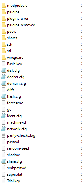

Ahh so your saying only have one .key file in the config? not both which would make sense, i believe it has both in it just because thats what i copied over

So your saying just copy over the Basic.key and it should be fine? as in all my shares/data on the drives would be good and not deleted? as for the apps/plugins all were from CA as far as i know, see picture for reference.

I don't believe i have a backup(stupid me), i can get into the drive completely but as i stated when i attempt to copy the whole config folder over it always stops working when it tries to copy "unraid-api.tgz", im compeletly okay with having to re add my plugins etc if need be on a new usb/the same one but i just dont want to have to re buy an unraid key again, if i just need to copy the key file over for it to work im happy with that, ideally id like to just copy it all but it doesnt seem to allow me too.
