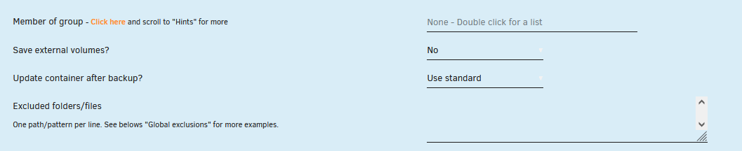

  7. Yes, but I believe the issue is on my side. As requested many times, the plugin now changes the files ownership from root:root to nobody:users. I dont know why but this seems to be an issue? But I cant confirm the issues, I can read them via SMB/Windows. Yea, if you initially have NO groups set at all, there will be no list. Some kind of misleading here. Just type something in and you will have a list for any other container now. Can you confirm that?

  20. Please add the mentioned volume path in the exclusion list directly inside its container config.
