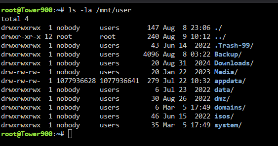

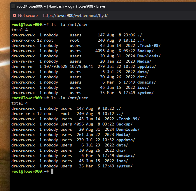

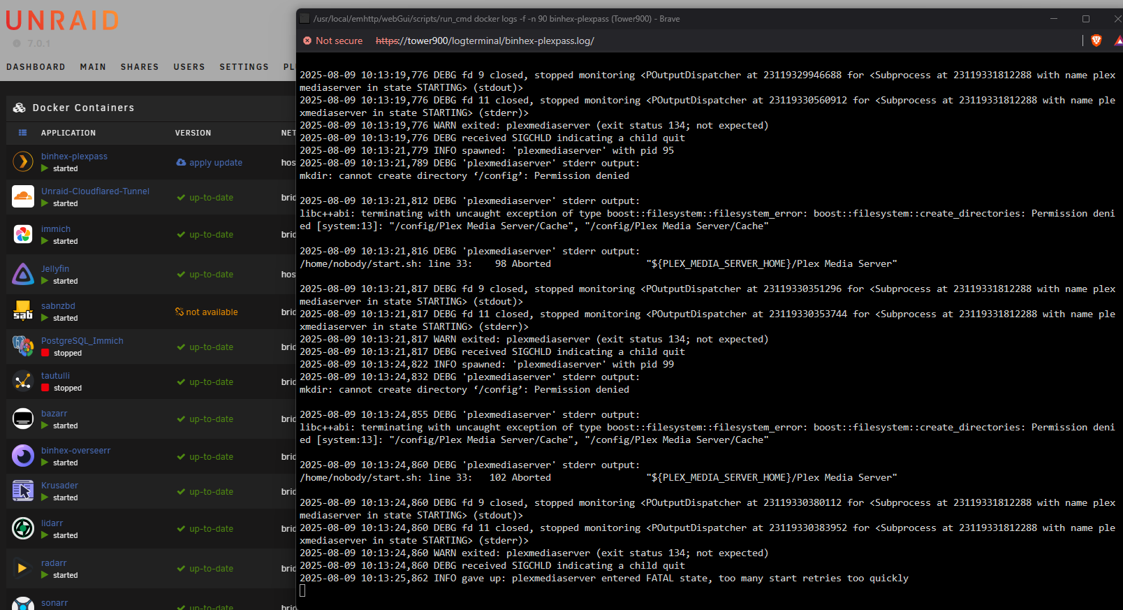

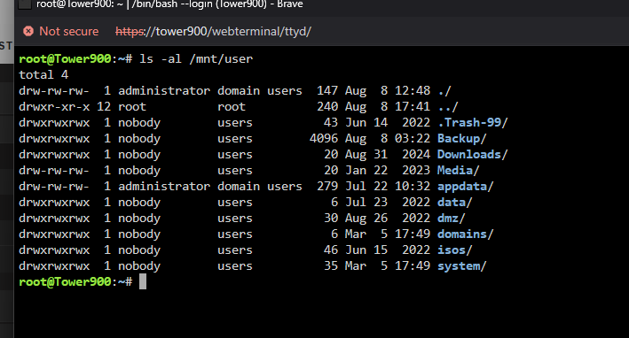

  1. After doing the two permission reset on Appdata and Media, this is the current status of the ls -la /mnt /usr command: Had to delete the Codec folder from Plex so that it could re-create the folder and download the codecs in order to play media, but at least it's working again.
  2. Did a new Permissions on the Media and Appdata shares after the Shares became available again and showed up (removing from Domain and setting shares to workgroup seems to have brought them back). After resetting permissions, it appears that the dockers are working correctly, but I can't browse to the UNRAID server via UNC path, not that I care about that too much. Trying to figure out if I should upgrade back to the latest version and restore my appdata backups from a couple days ago before everything got screwed up or just leave it alone. I have the Appdata backup plugin schedule disabled for now so it won't backup this screwed up state of my dockers. At this point, at least Plex is back up and running, I'm sure I'll run into more issues. Wish I could have some sort of snapshot of all settings that I can revert to if something goes awry like this. Restoring from backup didn't seem to do what I expected it to. Oh well, might have to pay for a professional support session to get everything working the proper way again.

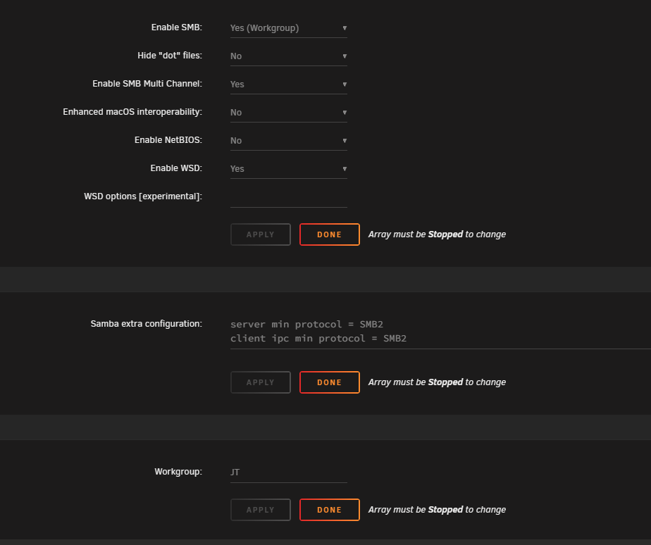

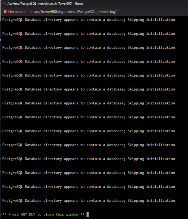

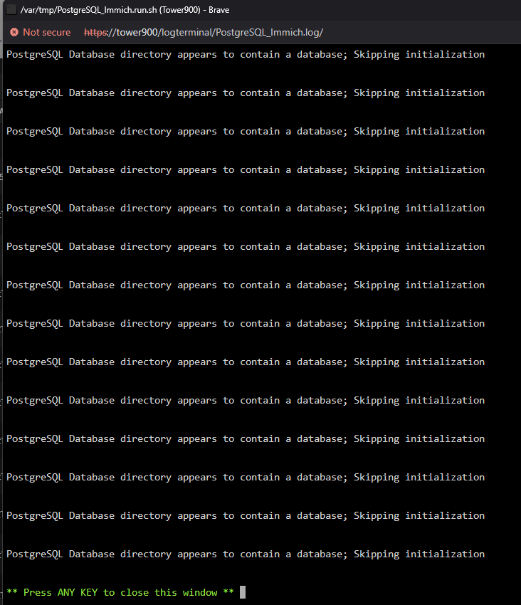

  3. I just reverted back to a workgroup and selected the shares to be shared out with Work Group instead of Domain and did the command again: When viewing docker logs for Plex and PostgreSQL_Immich, I have errors about not having permissions still: Thanks for the help so far though
  4. Thanks Frank1940, I took a look at the thread that you referenced, I believe all of my docker containers were obtained through the community apps and are docker aware. I didn't modify any permissions manually and the PUID and PGID's appear to be 99 and 100, as the defaults reference. Just not sure why the shares aren't showing up anymore. Well, obviously, we know why, because the groups don't have access permissions anymore, just don't know what took them away. As for rebooting to reset them, I've given that a try a few times and the shares are still inaccessible. As in, just gone. Attempting to add them back manually gives me an error in the logs that it already exists. So, the only thing I can think to try is to disable docker service completely and restart the system to see if something is messing with the access permissions.
  5. Well, that's certainly odd then. Anyway to reset permissions back to normal? I don't have anything crazy installed on UNRAID, no VM's, just some docker containers. Everything has been running fine for months until I stupidly tried to change the permissions with the Docker Safe permissions tool today. Been downhill from there. Strangely, I setup JellyFin a couple months ago and that docker is still working and I'm able to watch shows / movies with it right now, but I can't bring up plex at all. Should I try stopping and disabling Docker service, try to reset permissions somehow and reboot?

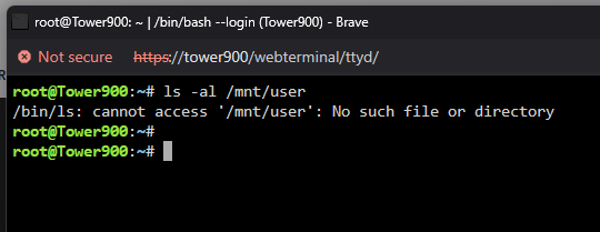

  6. Yes, sorry. Was replying back to itimpi about the disk checks. After starting the array the command shows:

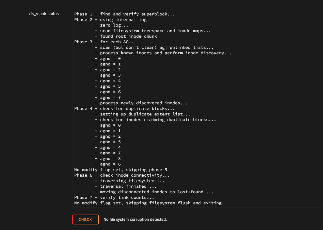

  7. Checked all three data disks, none had errors.
  8. Thanks @itimpi, I did attach the diagnostics shortly after the initial post. I can try to run a filesystem check and get back to you. I can say that a parity check was done within the last month and there were no issues and I haven't been alerted of any file system problems as of late.
  9. Had some issues accessing some new files created by Sonarr / Radarr via UNC path from Windows 11 client to my UNRAID server (7.14, domain joined). I attempted to run Docker Safe permissions and let it complete. All shares were gone. Tried to do regular "New Permissions" but there were no shares to select. Restarted system, all dockers were not running properly. Shut down the system and restored from a backup that I had from last month (UNRAID v7.01). Started up the system and still had no shares. Tried a reboot, still no shares. Removed from domain and re-joined, restarted again, still nothing. Please give me some advice on how to get the system back up and operational. Attaching diagnostics. tower900-diagnostics-20250808-1241.zip
