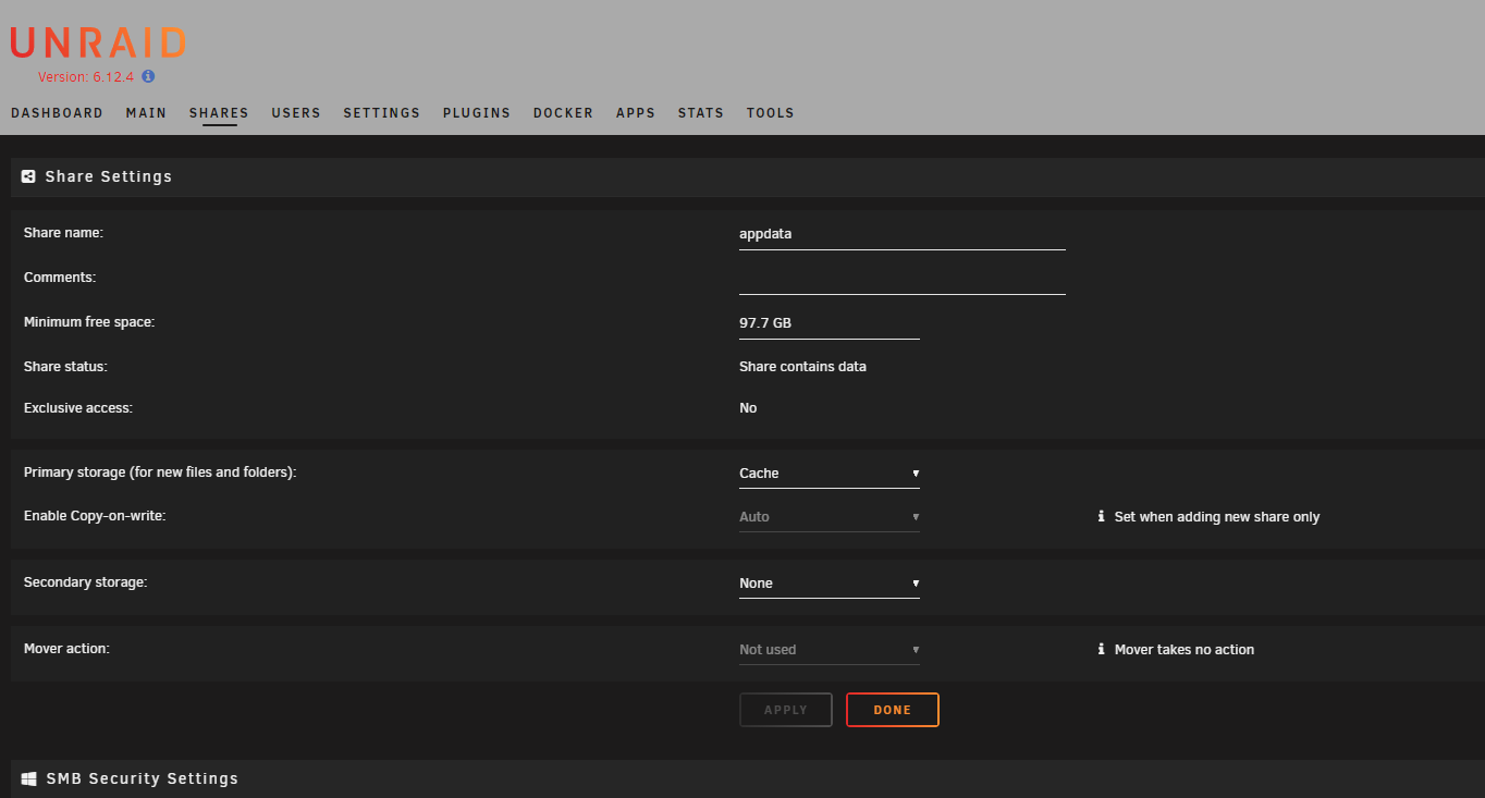

  1. Not really sure what the difference is, as long as it works, I'll leave it as it is. I guess my bigger question is now that my system has been restored from my backup config, and I had to re-add my cache drive, is there something that I need to do to fix any remnant configurations that may have been looking for my "old" cache drive? I don't know why all my plex metadata was lost overnight after I got my config folder restored. I might have to go back and revisit all the videos and tutorials that I initially referenced and make sure that I have everything setup properly. Obviously, I want to use my cache drive for downloading new files and have them get moved to the array afterwards, but I don't want it moving things from my docker containers.

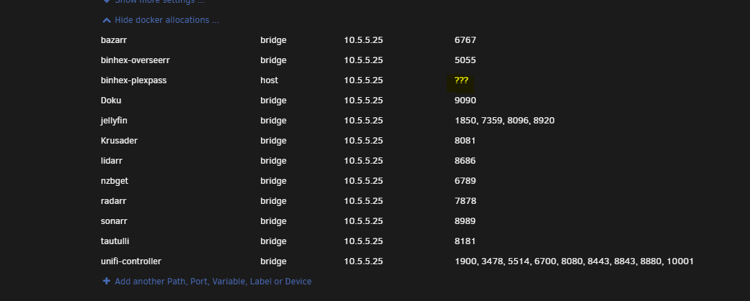

  2. Never mind, I think this version of plex doesn't have any port mappings. I had actually tried to specify an additional port because I didn't see any, but I looked it up and apparently it's normal to not have a port listed due to being host mode. Hopefully I'm all good now. Thanks!

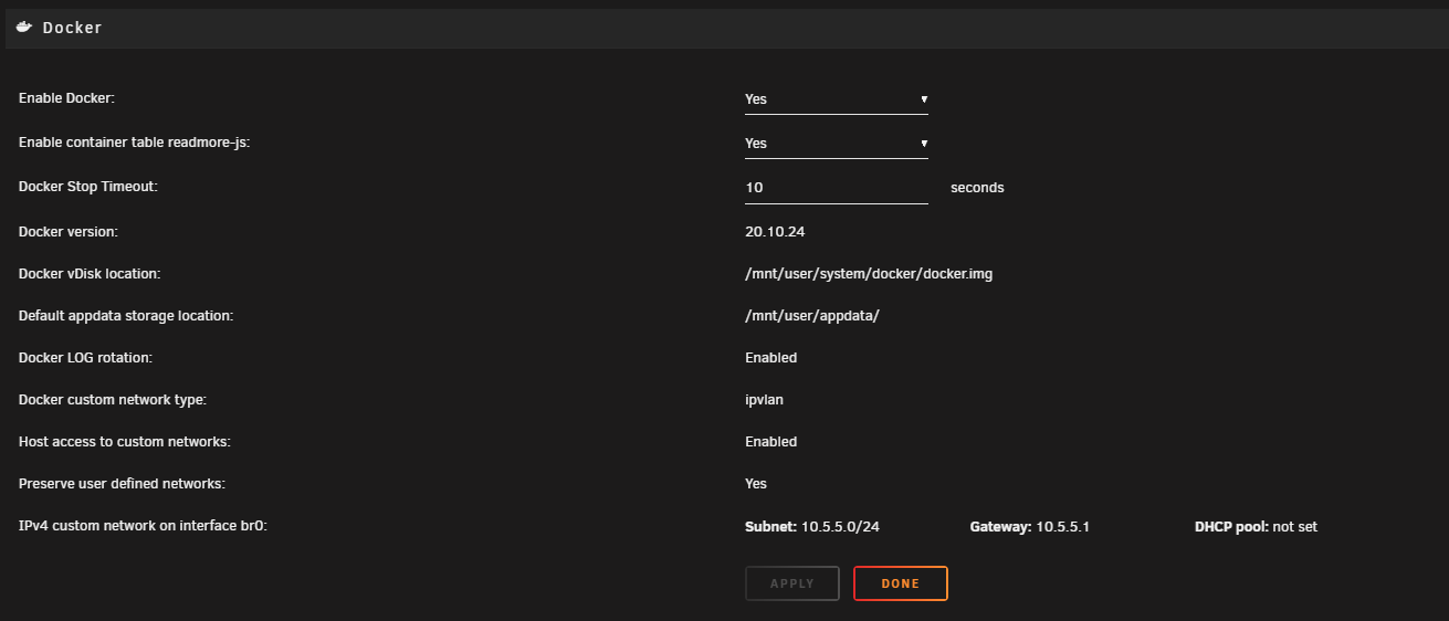

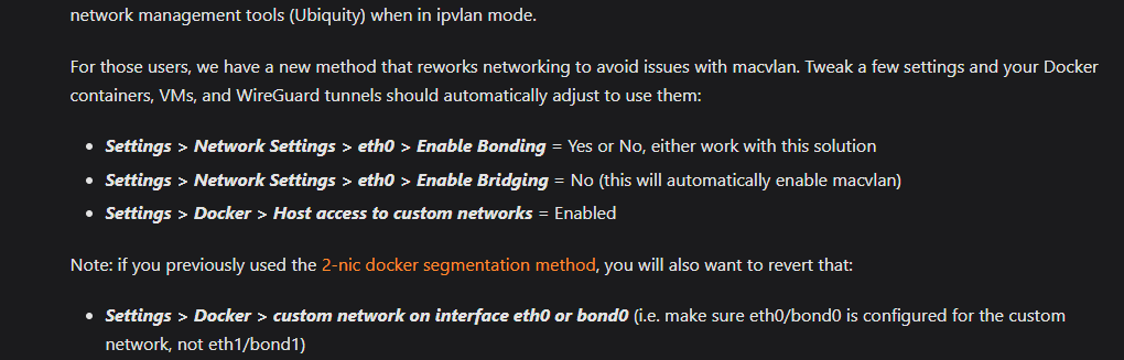

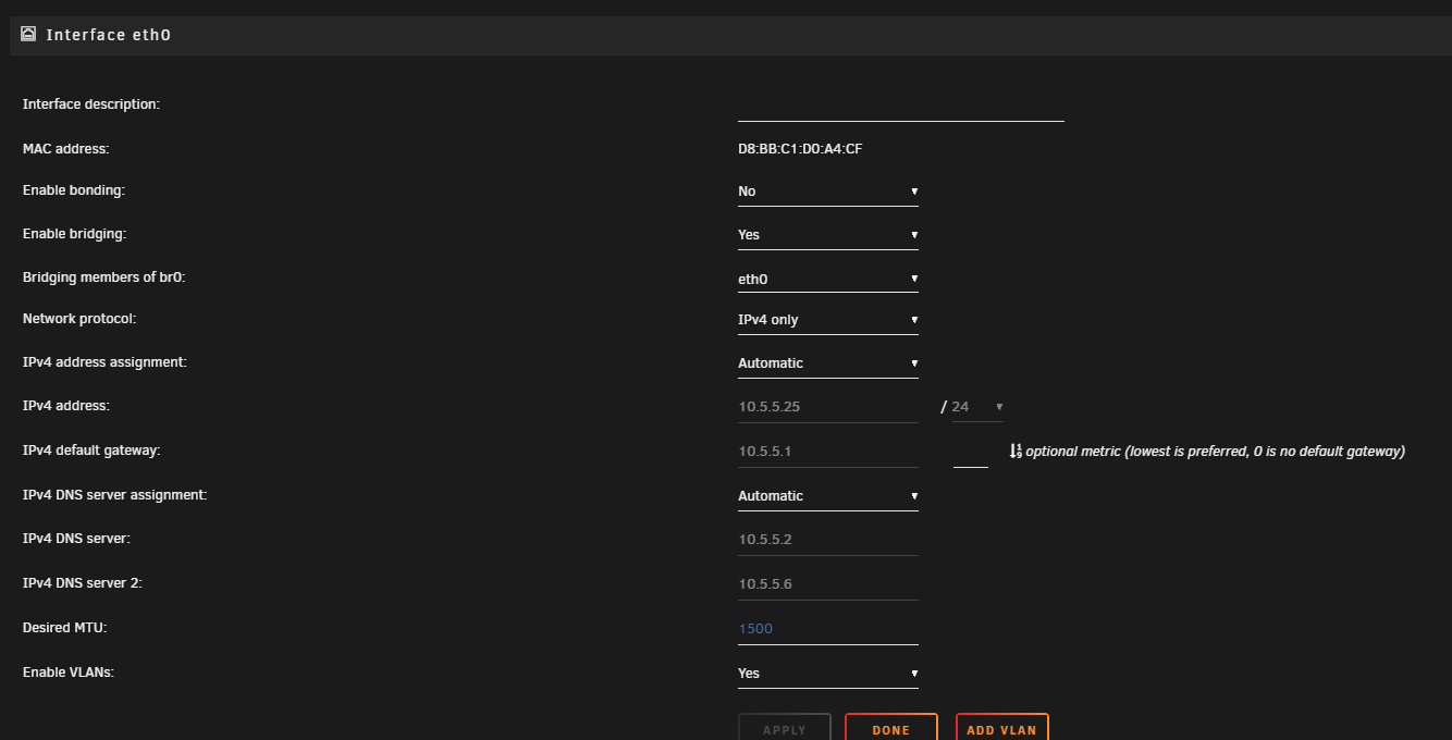

  3. I didn't think I had bonding turned on, the release notes state it can be enabled or not: Currently, I show it turned off: Docker settings screen: Plex still doesn't have a port mapping for whatever reason:

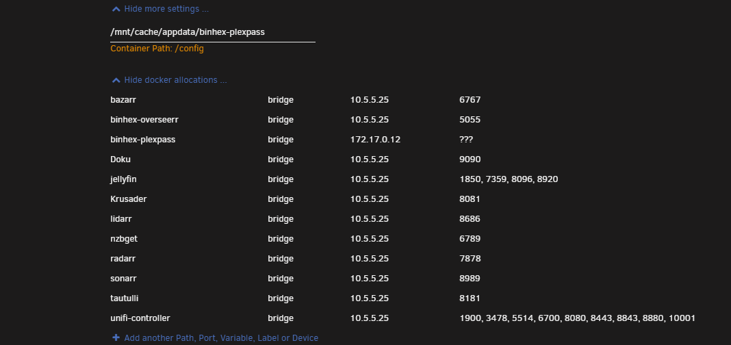

  4. The scrub of the cache result ended with: UUID: 81ca06e9-368b-43a7-a135-0fb513da41b4 Scrub started: Mon Nov 20 09:21:18 2023 Status: finished Duration: 0:00:09 Total to scrub: 27.73GiB Rate: 3.08GiB/s Error summary: no errors found When I attempt to switch to ipvlan, for some reason my plex container doesn't get configured with an IP. I switched from "host" to "bridge" and it never gets the host address for some reason, I'm not sure why: I guess I'll have to switch back to macvlan for now to get my server back up for the time being.
