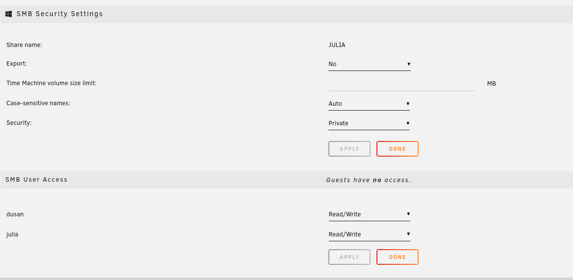

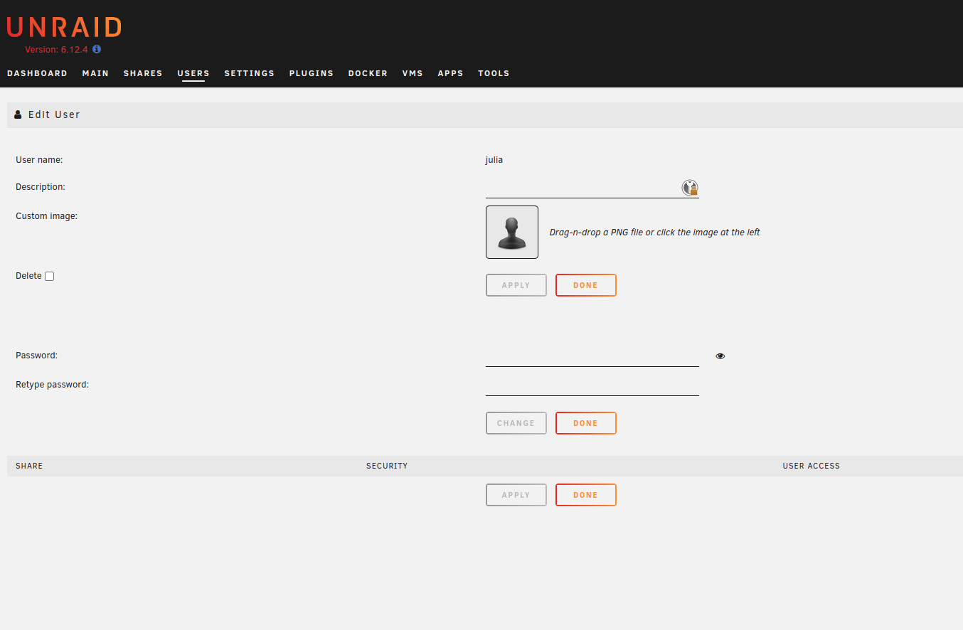

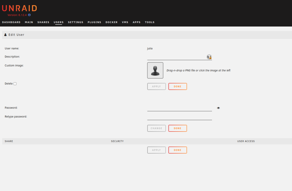

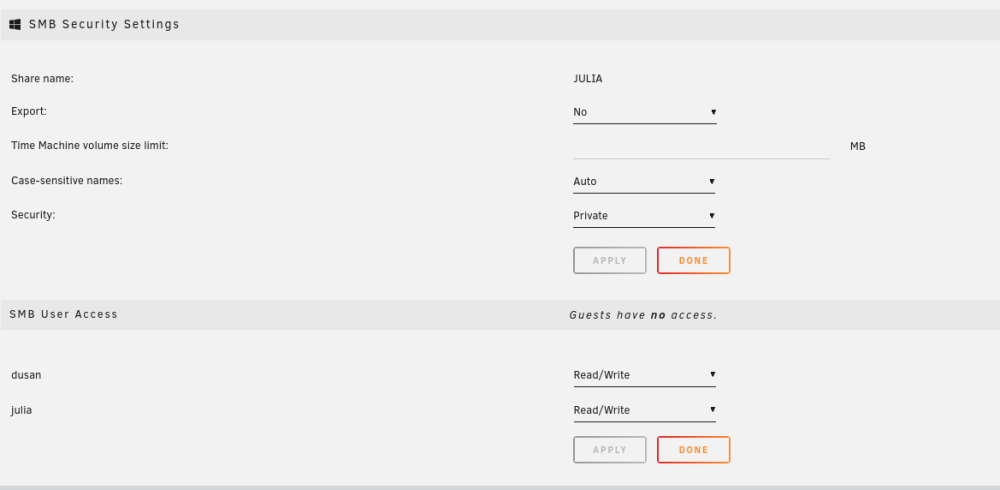

  8. Hi there. I have problem. I connect server from windows, but no shares are listed. I found there are also not any shares listed in user card. Any suggestion what I overlooked? Thx in advance.
