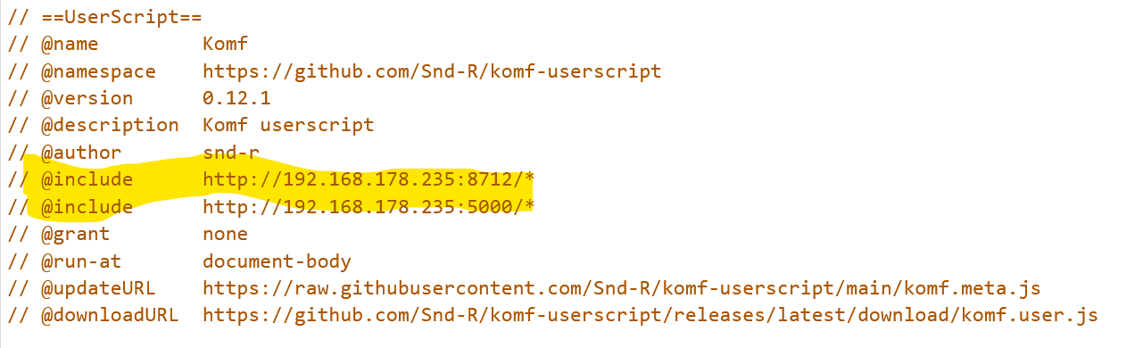

  5. Hi Ollebro, I ran into maybe the same Issue. The Userscript is configured to try to connect to Komf on localhost and 'forgets' your settings when you restart the script. So i recommend changing the adress in the Script itself (note that after updating your Script you will have to set this again) In Tampermonkey use Find and search for localhost. use find next next to the search bar until you see this: In Line 19787 replace http://localhost... with your Komf server adress. (192.168.1.4:8085) You can skip the http:// it worked without in my case. That should keep the Script from forgetting your komf adress (until the next script update) Also make sure you've set your komga and kavita adresses to let the script be active there. Good Luck, Have Fun
