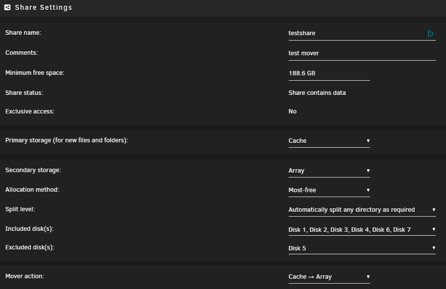

So it seem to work now. And it was not the missing dataset but I will fix that anyway. changed from: to and now mover picked the empty disk. So it seems like mover does not like it when a disk is missing in included.

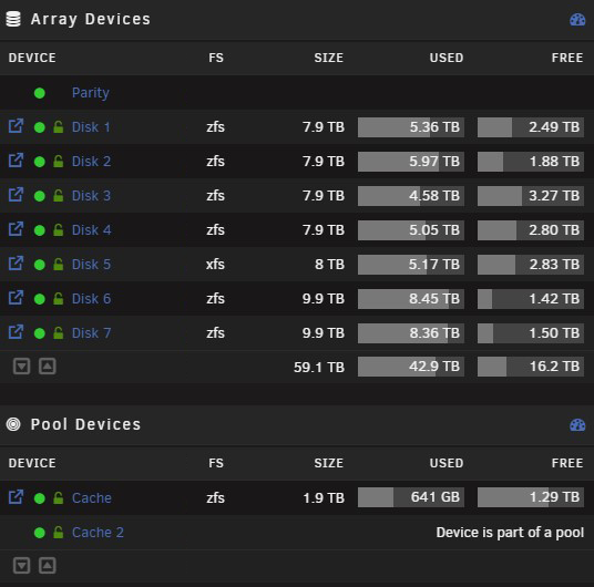

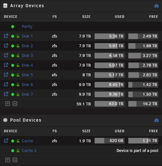

I am on the latest branch 6.12.4 invoked mover to have cache cleared created testshare and enabled mover logging: copied ~20GB to the folder over SMB invoked mover again before: and after (images croped for visibility) so it went again to disk 4 instead of most free disk 3 mover logs: Sep 28 11:16:02 unraid shfs: /usr/sbin/zfs create 'cache/testshare' Sep 28 11:24:12 unraid emhttpd: shcmd (1409): /usr/local/sbin/mover |& logger -t move & Sep 28 11:24:12 unraid move: mover: started Sep 28 11:24:12 unraid shfs: /usr/sbin/zfs unmount 'cache/Backup-Repository' Sep 28 11:24:12 unraid shfs: /usr/sbin/zfs destroy 'cache/Backup-Repository' Sep 28 11:24:12 unraid root: cannot destroy 'cache/Backup-Repository': dataset is busy Sep 28 11:24:12 unraid shfs: retval: 1 attempting 'destroy' Sep 28 11:24:12 unraid shfs: /usr/sbin/zfs mount 'cache/Backup-Repository' Sep 28 11:24:12 unraid shfs: /usr/sbin/zfs unmount 'cache/bootcds' Sep 28 11:24:12 unraid shfs: /usr/sbin/zfs destroy 'cache/bootcds' Sep 28 11:24:12 unraid root: cannot destroy 'cache/bootcds': dataset is busy Sep 28 11:24:12 unraid shfs: retval: 1 attempting 'destroy' Sep 28 11:24:12 unraid shfs: /usr/sbin/zfs mount 'cache/bootcds' Sep 28 11:24:12 unraid move: error: move, 380: No such file or directory (2): lstat: /mnt/cache/data/media/down/mega/B/folder Sep 28 11:24:12 unraid move: skip: /mnt/cache/data/down/folder/nextfolder/file1.mp4 Sep 28 11:24:12 unraid move: skip: /mnt/cache/data/down/folder/nextfolder/file2.mp4 Sep 28 11:24:12 unraid move: skip: /mnt/cache/data/down/folder/nextfolder/file3.mp4 Sep 28 11:24:12 unraid move: skip: /mnt/cache/data/down/folder/nextfolder/file3.mp4 ... Sep 28 11:24:13 unraid shfs: /usr/sbin/zfs unmount 'cache/downloads' Sep 28 11:24:13 unraid shfs: /usr/sbin/zfs destroy 'cache/downloads' Sep 28 11:24:13 unraid root: cannot destroy 'cache/downloads': dataset is busy Sep 28 11:24:13 unraid shfs: retval: 1 attempting 'destroy' Sep 28 11:24:13 unraid shfs: /usr/sbin/zfs mount 'cache/downloads' Sep 28 11:24:14 unraid move: file: /mnt/cache/testshare/file.iso Sep 28 11:24:14 unraid move: file: /mnt/cache/testshare/file2.iso Sep 28 11:24:14 unraid move: file: /mnt/cache/testshare/file3.mp4 ... Sep 28 11:26:39 unraid shfs: /usr/sbin/zfs unmount 'cache/testshare' Sep 28 11:26:39 unraid shfs: /usr/sbin/zfs destroy 'cache/testshare' Sep 28 11:26:39 unraid move: mover: finished
