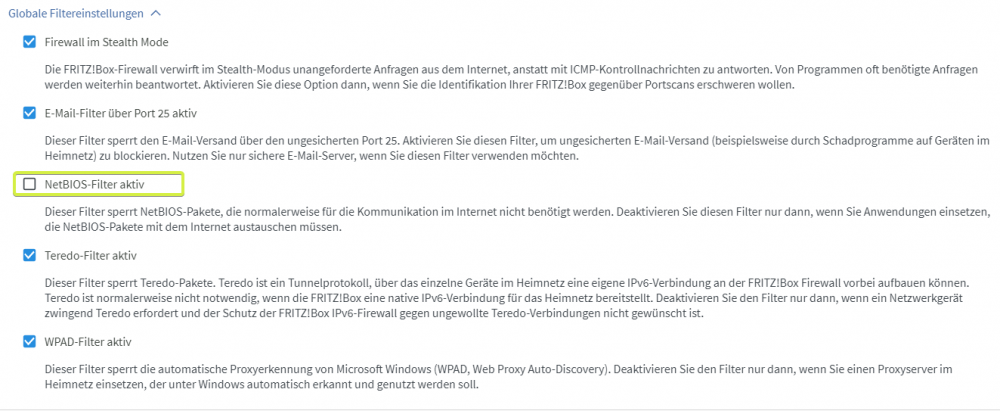

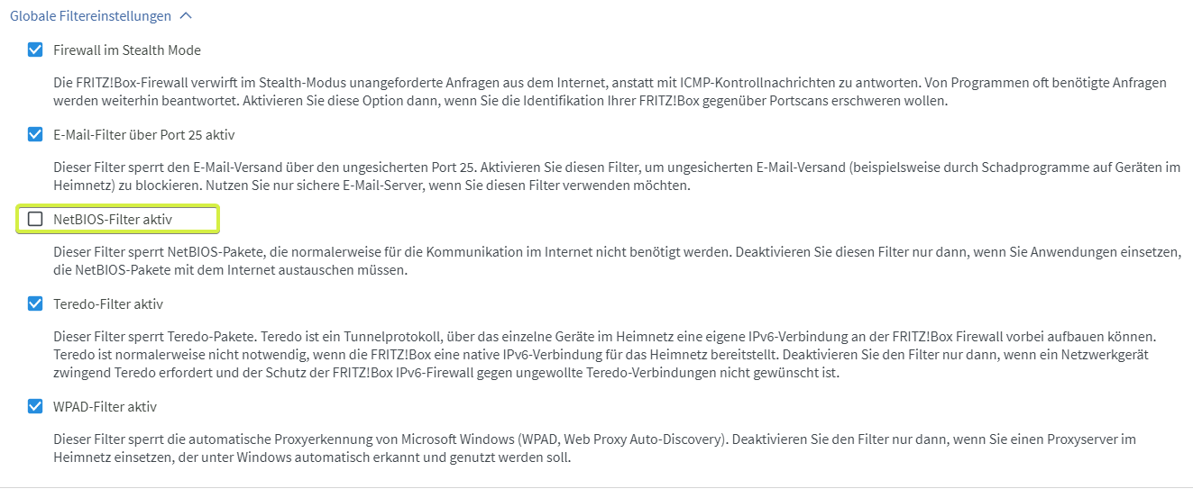

  1. I found the solution. i don't understand why it worked on server 1 and not on unraid. but after i disabled the "netbios" filter in my fritzbox. it works now without problems.

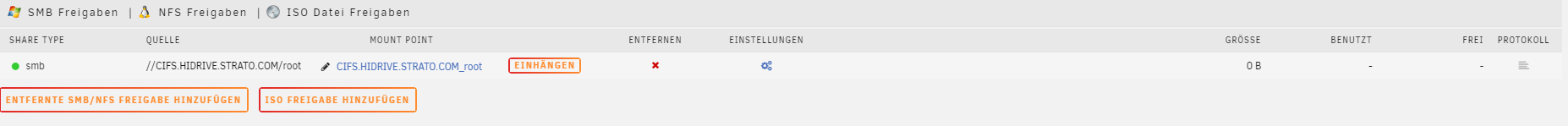

  4. the command i use: mount -t cifs -v -o rw,noserverino,nounix,iocharset=utf8,file_mode=0777,dir_mode=0777,credentials='/tmp/stratocreds' '//CIFS.HIDRIVE.STRATO.COM/root' /mnt/strato happens in under a second

  6. Saw249 joined the community
