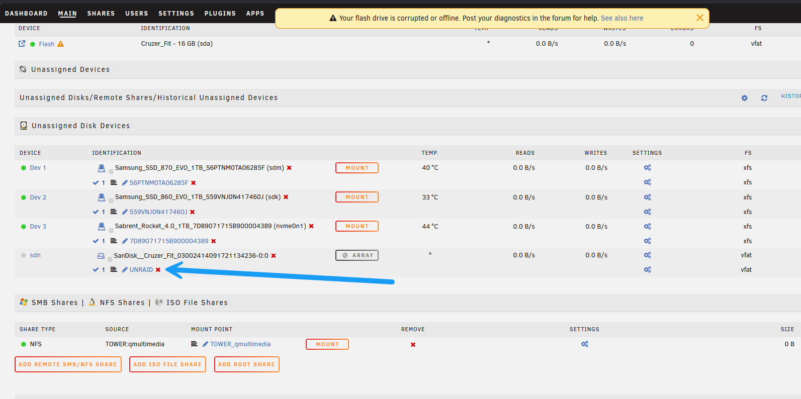

  5. I agree with you.. I took a look on Amazon and not sure which to get because it does not really say MLC. I searched: mlc usb flash drive 16g - I'm in the US. If you can point me to one I should get or a few.. also, am I going to have a problem if I switch again to another USB drive with Unraid? Can you switch again without needing any assistance from support?
  6. I had purchased a pack of 10, that is why i replaced with the same. As for internal boot, just don't update the bios often, i guess. But i would imagine, it will still prevent this type of issue.
  7. Hey Jorge! tower-diagnostics-20260501-0854.zipI was just venting, i didn't need assistance itself but here is the file. What a week! When I first had problems, i thought it was LSI controller and went and changed that out, in the process of that, the data connector on the 14tb drive literally broke off which further complicated everything because I had to replace the drive (but i have spares thank god) lol. To get my new USB workling, i created a new 7.2.3 boot and copied my /config from the old usb over (i was able to read it without issue)

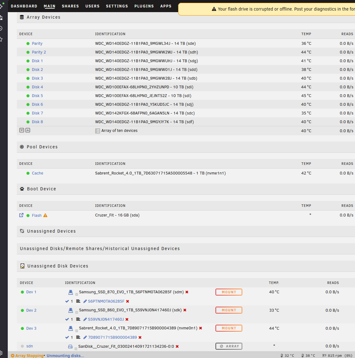

  8. Had a CMOS battery fail which crashed the whole server. Replaced battery and got server back up, it did the partity rebuild 26 hours and done. The next morning the USB boot drive fails. Replaced it and back up and running but now It once again needs to do the whole unclean shutdown and parity rebuild again. I know USB's boot is soon to be replaced and hopefully this will resolve a good amount of these types of issues but arghhhhhh. This puts more wear and tear on the drives and stressing me out waiting for it to finish again - Worried if a storm or power fail and UPS runs out of juice, another unclean shutdown. I was in a VM and the whole remote desktop closed and the server main showed this: (2 screens to fit it in) But it was not shutting down and kind of stuck which is what was the problem.
