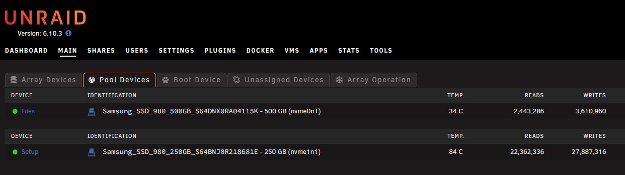

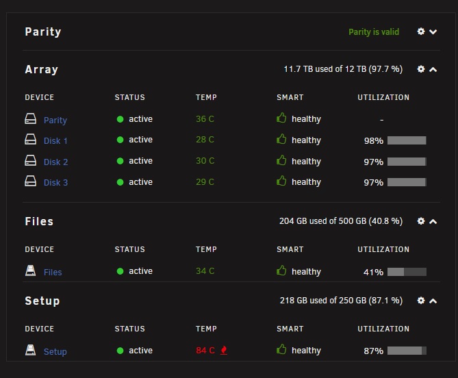

  4. Thanks for your comment. Had no idea about this. Found more information on Samsung's forum: https://us.community.samsung.com/t5/Monitors-and-Memory/SSD-980-heat-spikes-to-84-C-183-F/m-p/2161229.

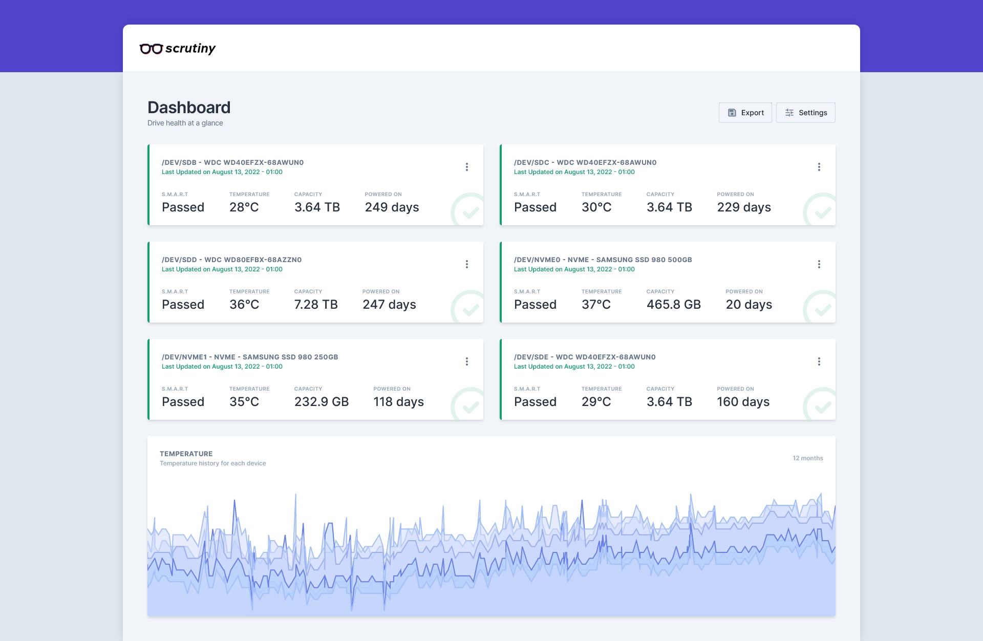

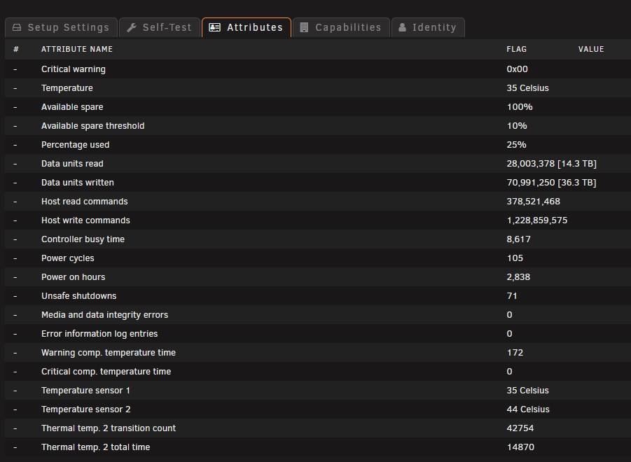

  5. Hey guys. Sometimes I get an unRAID warning about one of my two cache ssds reaching high temperatures (84ºC) [see first two images]. However, on the disk attributes page, temperature is normal (35ºC) [see image 3]. Scrutiny also doesn't show any high temperature for the disk [see image 4]. Is it "bad temperature reporting" by unRAID? Is my disk really reaching that temperature of 84ºC? And why?! Both SSDs are the same exact model (Samsung 980 M2 SSD), except the size (one is 250gb and the other one is 500gb). Only the 250gb SSD reaches >80ºC temperatures. I've attached a report. Thank you guys for your inputs and thoughts. image 1: image 2: image 3: image 4: core-diagnostics-20220813-2226.zip

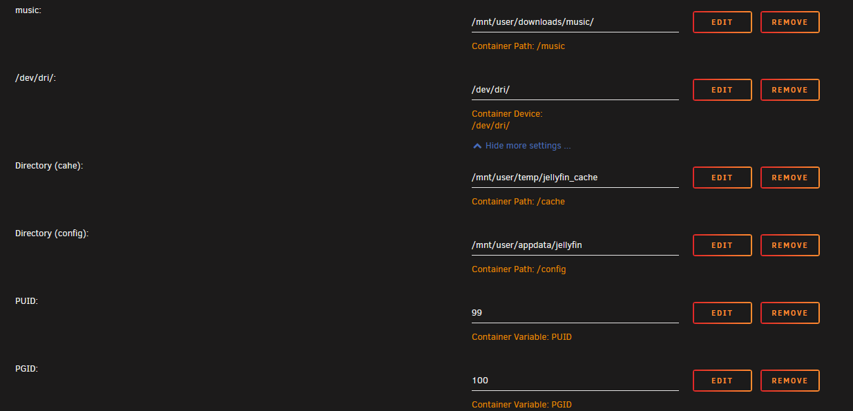

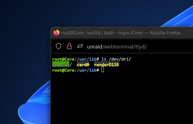

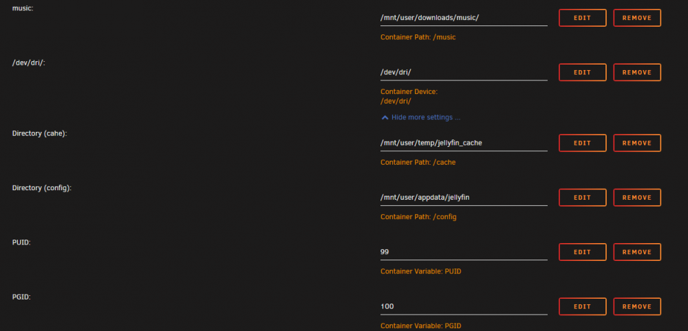

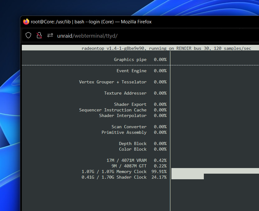

  7. Yes, 10.8.1 has been released. They fixed the problem but my unRAID server doesn't seem to have the OpenCL drivers. How can I install them?
  8. I've installed both containers (yours and the official one) and I repeat every step on both of them. I can't play these DoVi profile 5 files and according to the logs, the problem is OpenCL related. I think I have all AMD drivers configured properly (for example, in Plex, I can hardware transcode with no problem). Thank you for replying!
