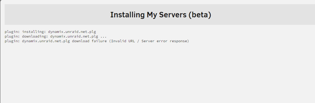

  11. fixet https://wiki.unraid.net/My_Servers Community Applications plugin wasent installed
