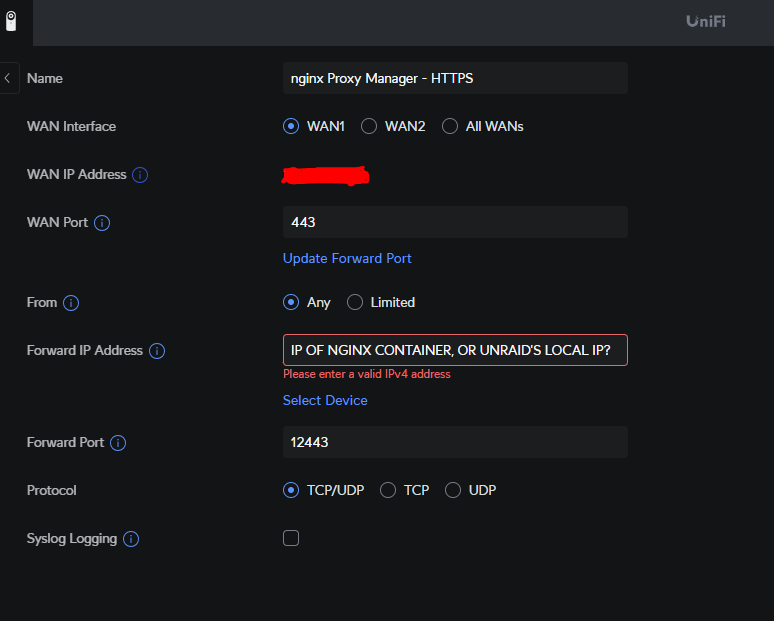

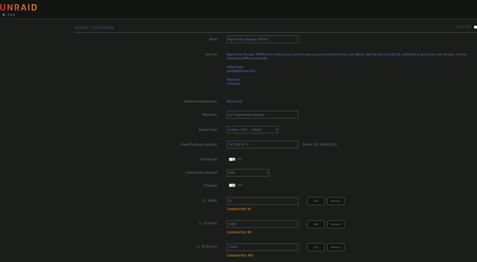

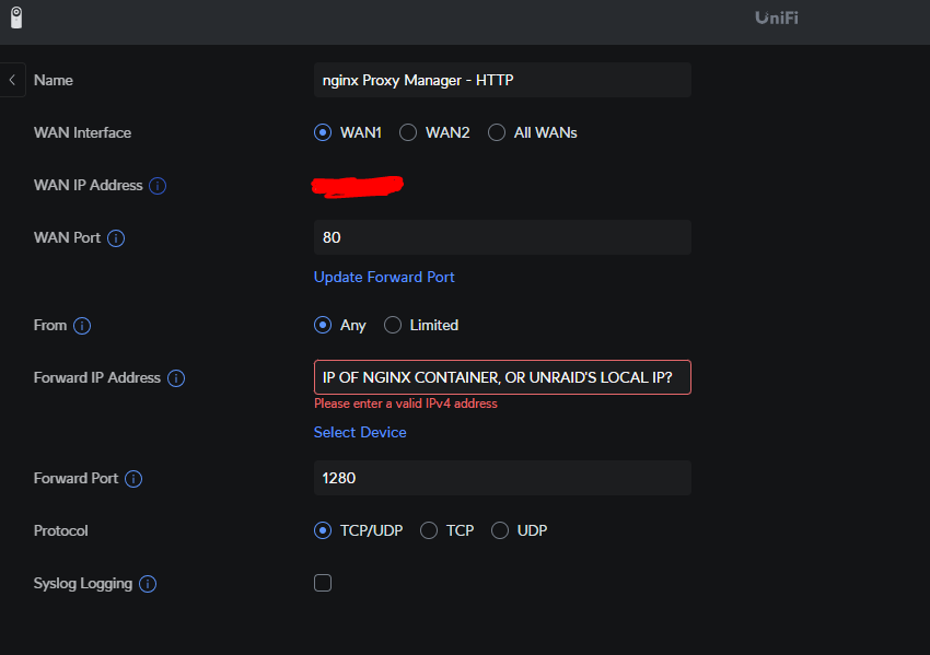

  1. Sorry for the delay; didn't see a notification that there was a new reply. I THINK I have them setup correctly. I was able to get nginx-Proxy-Manager-Official on its own IP address separate from my unRAID server. I was also able to specify different ports instead of the container's default of 80 and 443. In the router, I have the port forwards set for nginx-Proxy-Manager-Official's IP address, with Port 80 and 443 forwarded to the ports I specified in its container. So long as there are no issues or exposures with the way I did that, I should be good to go!

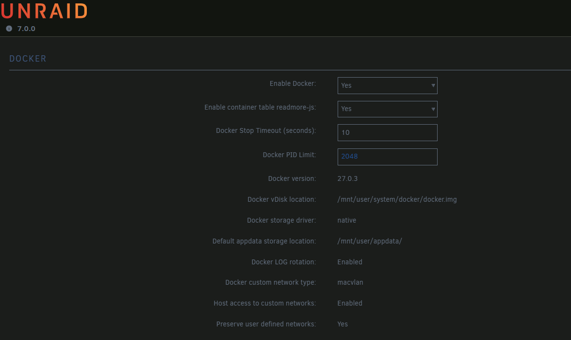

  2. Thanks for the tips. I went ahead and set up my Port Forwards properly. Something clicked a couple of hours ago and I figured some of the other stuff out. One of the biggest problems was unrelated to what I typed. Basically, I have been remoted into my network via Wireguard (Unifi VPN Server) and working on all this. But, my laptop wasn't using my pihole's IP for DNS, despite it being manually set in the laptop settings, and on the VPN Server DNS settings. Flushing DNS and rebooting the laptop didn't fix. But, I removed and re-added it to the VPN Server, and it started resolving through the pihole! My final follow-up question; since I use macvlan on unRAID, each docker container on br0.1 will have its own IP address. If I manually set the Nginx-Proxy-Manager-Official container to the same IP as my unRAID server, I'll get an IP conflict in Unifi. Think I'll be fine with seperate IP addresses for containers like Nginx-Proxy-Manager-Official and the ‘arrs, so long as they are all on the same br0.1 network? Thanks again for your help.
  3. Hi, I’m trying to get my containers properly setup on Docker. I just don’t know if I’m doing it right. The problems I face are not knowing the proper Docker Network types to use per container, not knowing why some containers get an IP in a different range (192 vs 172), why some using Bridge don’t show an IP, and why some port forwarding doesn’t seem to work. I’ve looked some of this info up, but I always find folks posting differing opinions on the matter. I'll describe my networking situation and obstacles below. For any examples of IPs and ports, I’ll be using ones I don’t plan to implement for privacy reasons. Let’s say I have my Unifi devices/controller on a subnet 192.168.40.xx, and unRAID on a different subnet of 192.168.120.xx. I have a custom network in Docker called br0.1 (192.168.40.xx). I have been trying to use the custom network, which is on the same IP range as my Unifi devices. In the Network Settings, “Enable Bonding” is NO, “Enable Bridging” is YES, and "Docker Custom Network Type" is macvlan. For my router, I currently have a UDM SE, and it acting as the primary/only DHCP server for my network. For now, the following containers I want to use are: Nginx-Proxy-Manager-Official binhex-official-pihole binhex-plexpass The ‘arrs I want binhex-official-pihole to be able to point to Nginx-Proxy-Manager-Official so that I can get local SSL certificates, and eventually setup a reverse proxy using my registered domain. I’m unsure if pihole and Ngnix need to be on the same subnet or network type in unRAID. For actual pihole and Nginx steps, I've been trying to follow the "Secure Local Domains Easily with Pi-hole & Nginx Proxy" YouTube video by TechDox, and the second half of the "Use a Reverse Proxy Server for Local SSL Certificates on all Home Lab Services!" YouTube video by WunderTech. Nginx-Proxy-Manager-Official won’t start if I have the Network Type set to Bridge, but it will start if I have the Network Type set to br0.1. It says on Community Apps that the custom network is recommended, anyway. However, I’ve read that the custom networks like the one I have with br0.1 cannot see other containers on a different network type. If I am trying to have pihole local records setup with nginx for generating local SSL certs, and eventually get a reverse proxy setup with my registered domain, should both containers be on br0.1? Another obstacle I have for Nginx-Proxy-Manager-Official; I have to forward ports 80 and 443 from my UDM SE. But I read that unRAID should absolutely NOT have its own ports of 80 and 443 forwarded. When using br0.1, I can give Nginx-Proxy-Manager-Official its own IP. If it is not supposed to use br0.1, does it still get its own IP or will it share an IP with unRAID? I'm not sure if it SHOULD have the same IP as unRAID or not. Also, depending on the correct option, do I change the port numbers for 80 and 443 on the Nginx-Proxy-Manager-Official container to something like 1280 and 12443, then forward those in the UDM SE? I’ve attached screenshots of an example from my UDM to see if that would be correct way to enter it. Moving onto binhex-plexpass; I have that container set as Host, which from what I’ve read is the proper Network Type. But if I were to install and configure the ‘arrs containers, what network type would they need to be on? Also, should I be seeing information on the Docker sections in unRAID for their “CONTAINER IP”, “CONTAINER PORT”, and “LAN IP:PORT”? Sorry for this mess of requests. I spent 10 hours yesterday scouring reddit threads and YouTube videos trying to find the most current, support steps for all this (as well as trying to understand it all), and ended up crashing my server and having to rebuild it from a flash backup. Any and all help is 1,000,000,000% appreciated. I feel like I'm just missing a couple pieces of critical info, and then hopefully this all will make sense to me.
