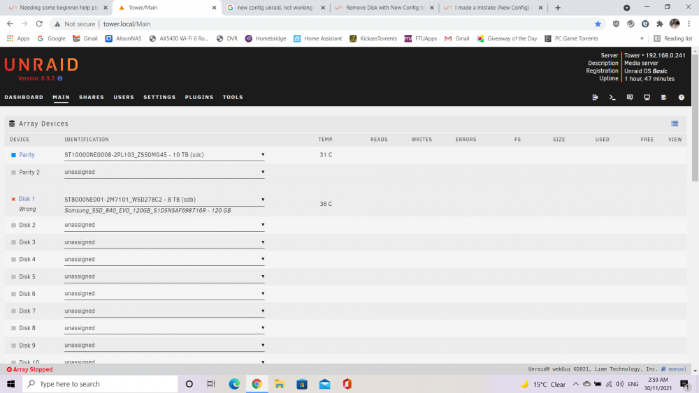

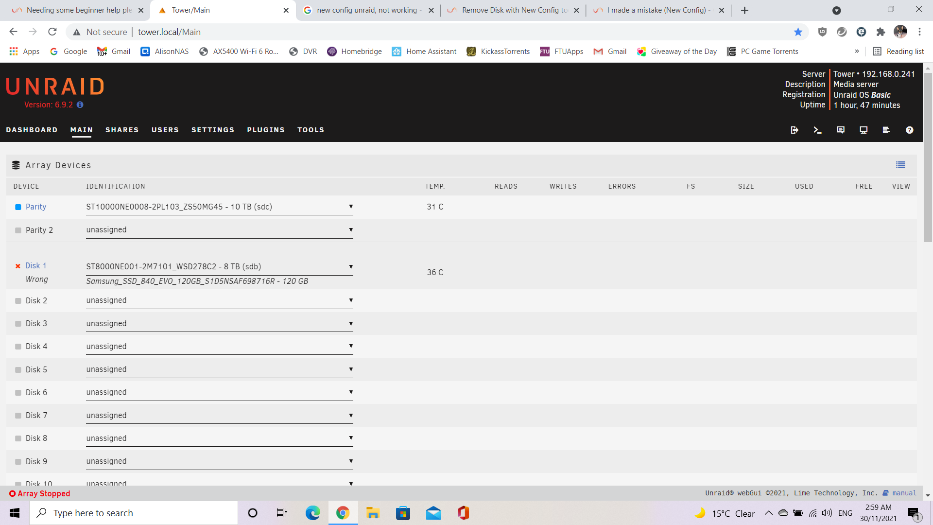

  17. Thank you, the reboot worked. I have been able to set the 10 TB in Parity 1 and 8 TB in Disk 1. However, I still have no Cache Disk section to be able to assign the SSD.

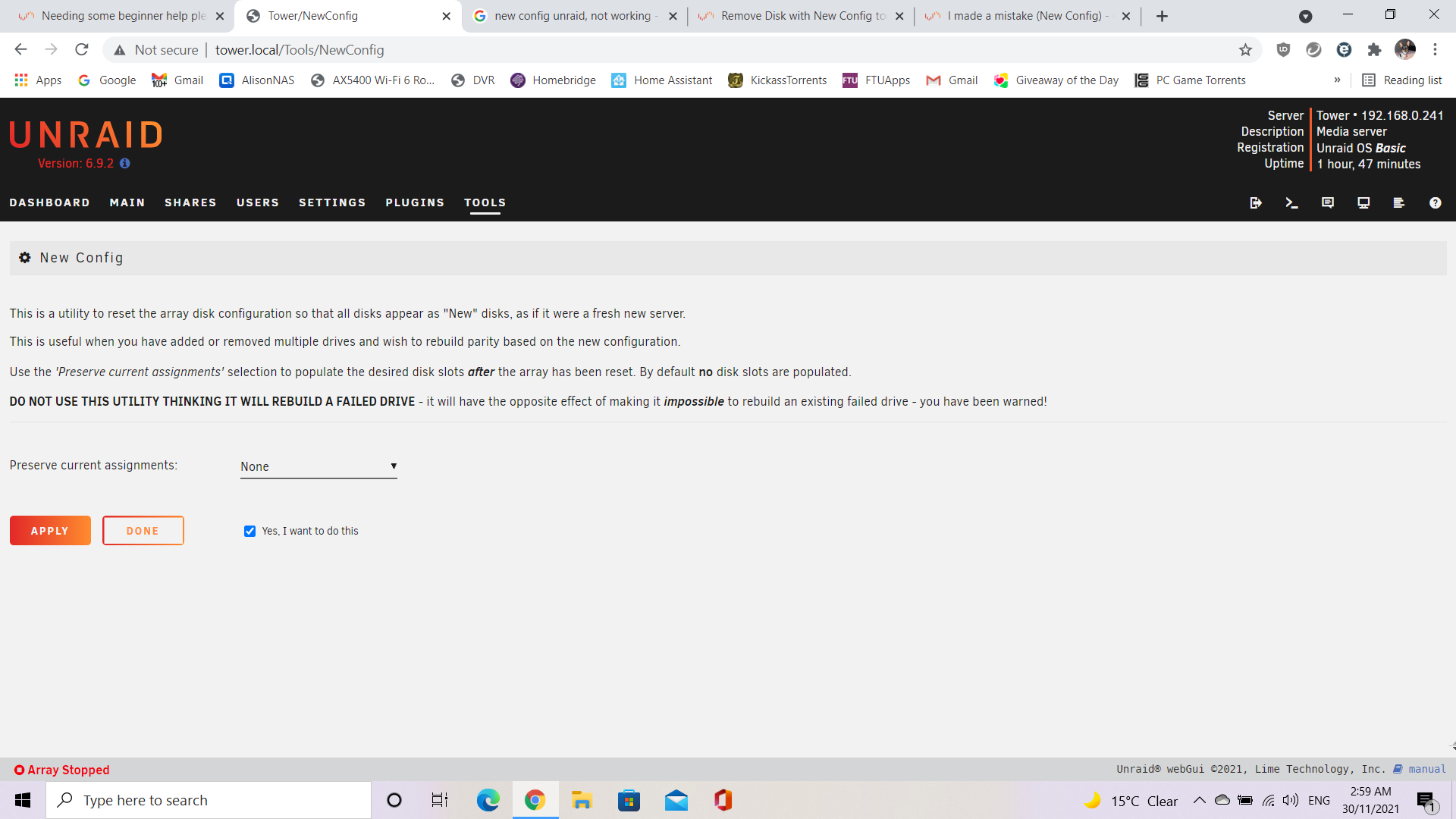

  18. Yes I did. I selected the right tick option to confirm I wanted to do this. Then selected apply, then done. But I didn't see nothing occur. I would think there would be some visability acknowledging it was happenng.

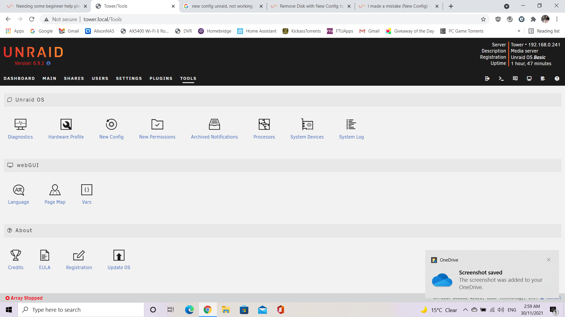

  19. I don't know why, but it literally will not let me set it how I would like. I have tried using New Config, no change.

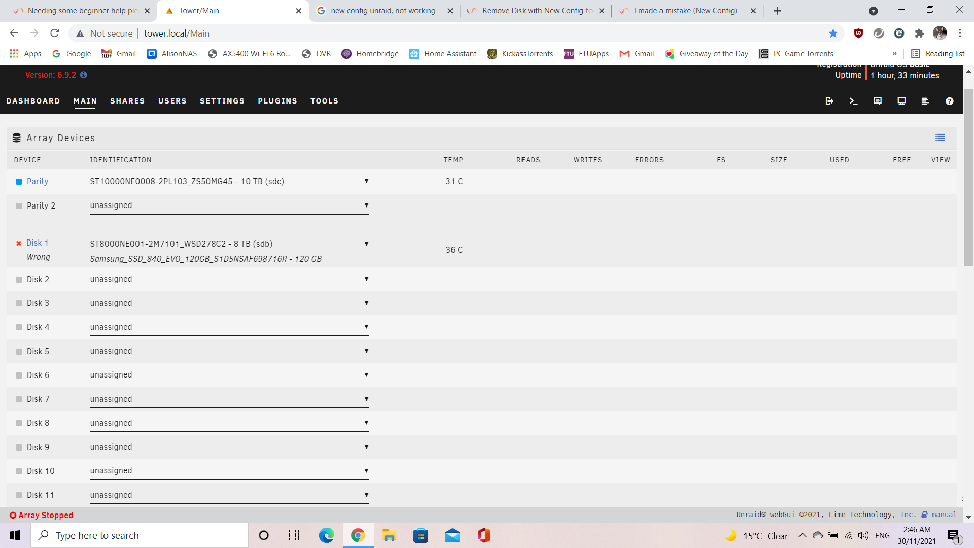

  21. I have only just started using NAS systems. I was using a QNAP NAS prior to now, but I wanted some more flexibility when it comes to the amount of drivers etc. I currently have 3 Drives installed in my Chasis. 1 is a 10 TB HDD and another is a 8 TB HDD, the 3rd is a 280 GB SSD. I would like to have the SSD for a cache drive and the 10 TB as the Parity drive, while using the 8 TB HDD as the storage drive things are copied to and read from. The problem I am having is being able to configure the setup correctly. It allows me to set the 10 TB as the parity, but it keeps making me select the SSD as disk 1. I would like the SSD as a chache and as I understand it, I cannot have that assigned to a drive slot if I want to do that. If I leave it unassigned and put the 8 TB in disk 1 spot, it tells me wrong disk, but not much more information. I am having some difficulty formatting too, I can't seem to locate it and I suspect it has to do with the drive issue. I cannot start the array either. I am completely new to UNRAID and currently own a Basic liscence. I learn fast when given the right help, hopefully this can get resolved quickly. I will post the logs. Thank you. tower-diagnostics-20211130-0200.zip
