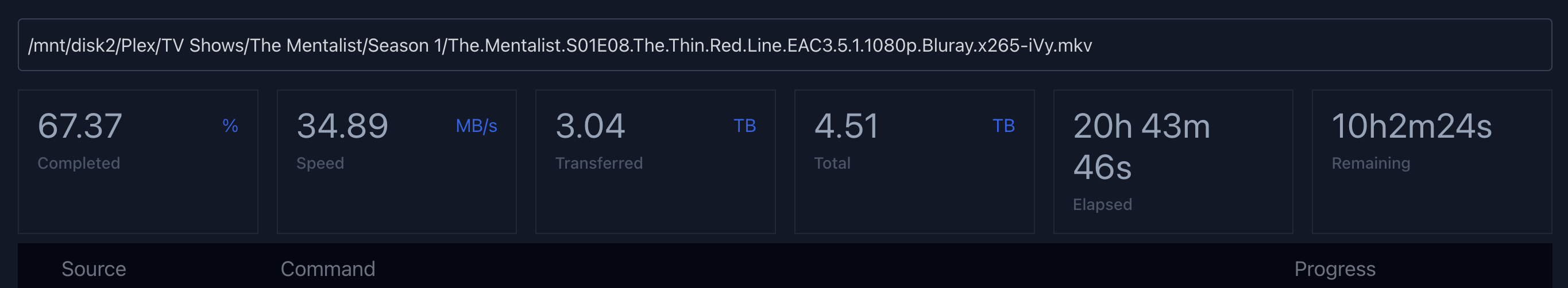

  3. I made my array out of ZFS drives and am wanting to go back to XFS. Currently I’m transferring data off ZFS into XFS and using unbalanced. Last night I started the unbalanced move of the contents of my almost full 4tb drive onto a 6tb drive. I can’t say for certain since I have the memory of a fish but I’m pretty sure I didn’t notice the total being over 4tb last night. Checked on the progress just now and noticed it says 4.5 and I don’t understand how when I only selected data from one disk that’s 4tb. Any ideas?
