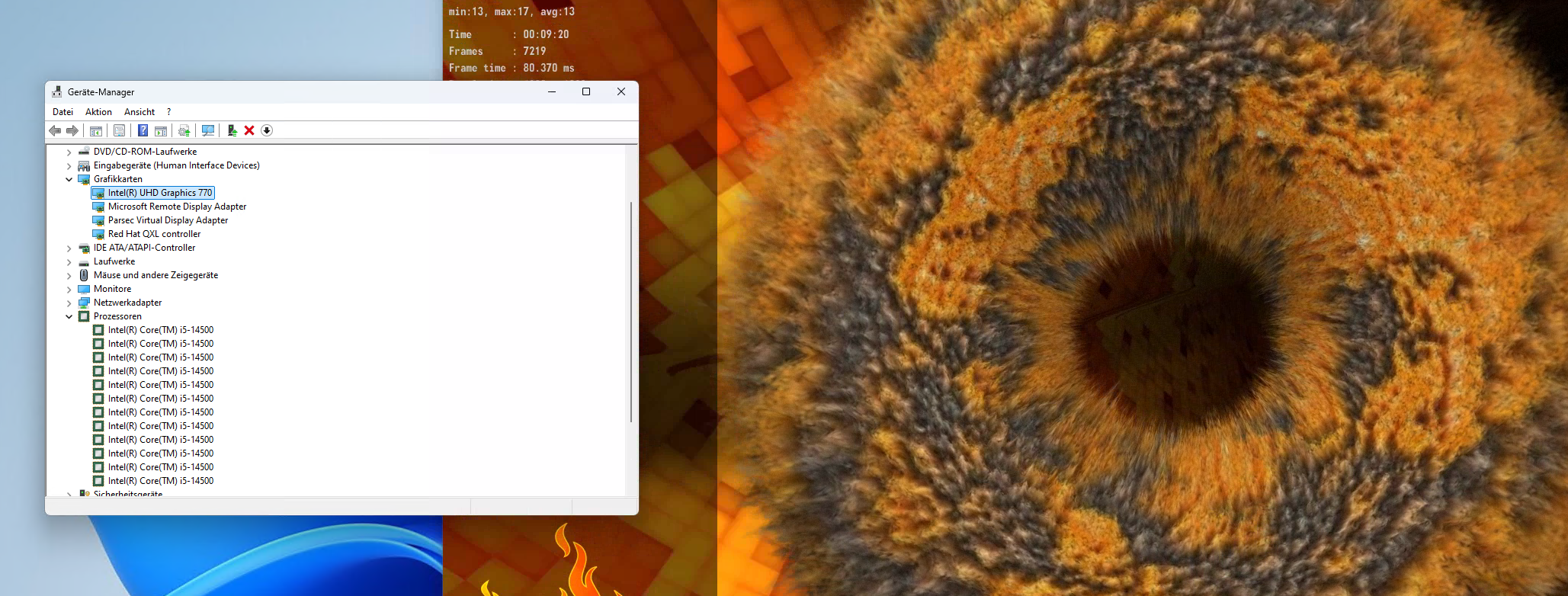

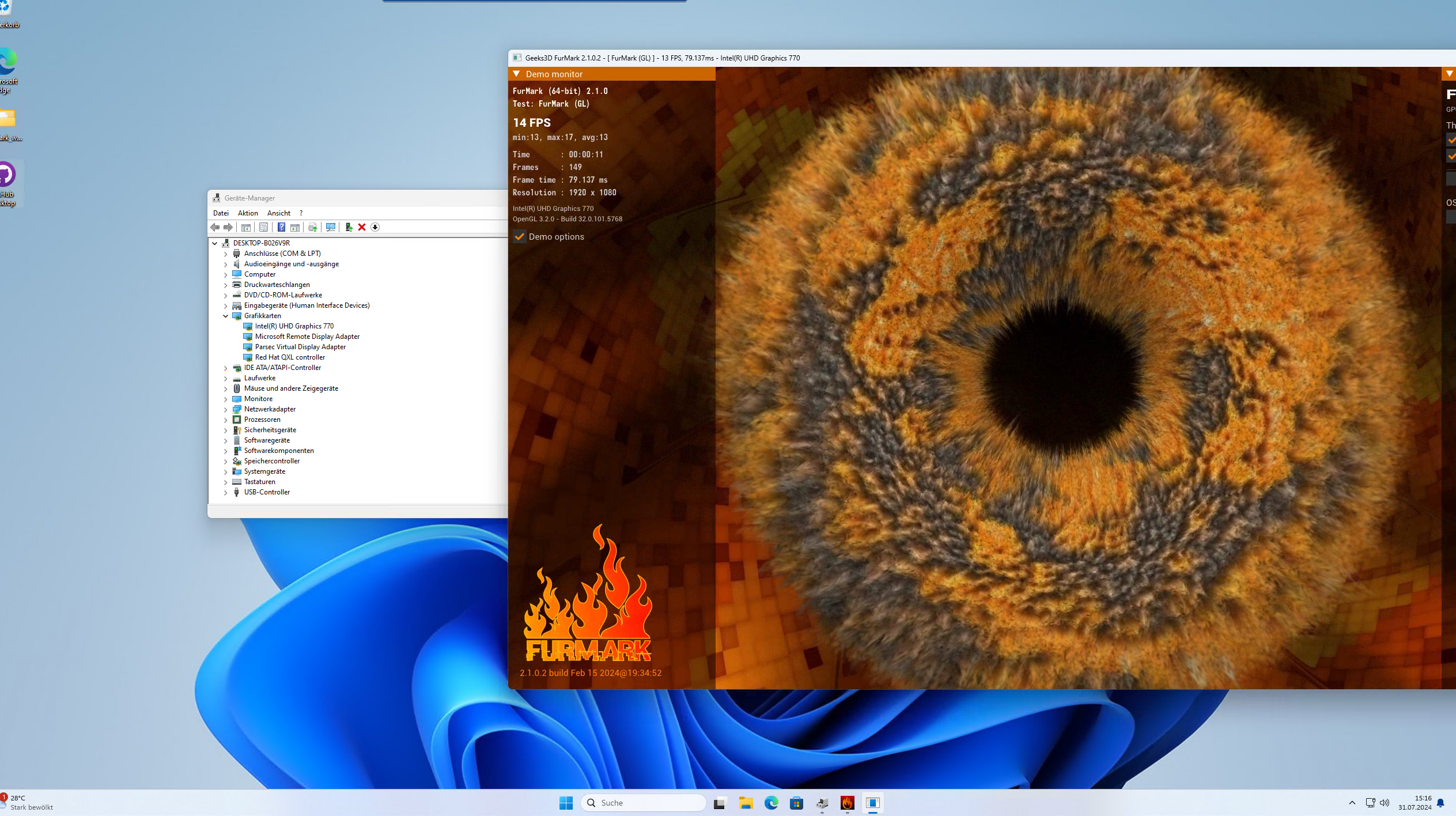

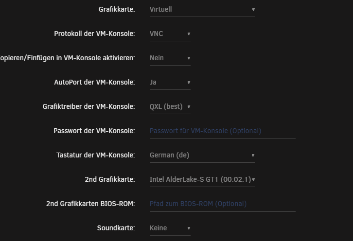

  1. will this work now on 7.3 with i5 14500 ? if i passtrough it to my windows guest, i can install the intel display driver, devicemanager shows all ok, but parsec still uses software renderer and can run furmark etc. edit: ok, worked, but my whole igpu crashs after VM shutdown .. need to do : echo 1 > /sys/bus/pci/rescan in unraid shell + add VFs back (no restart nessesary , worked again after) but after each VM reboot / shutdown, the igpu crashs and i need rescan and readd the VFs, any solution for this?

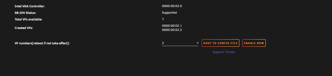

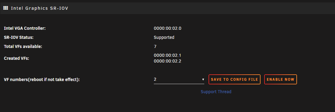

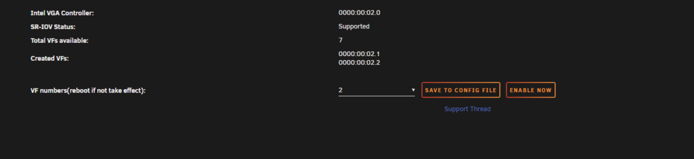

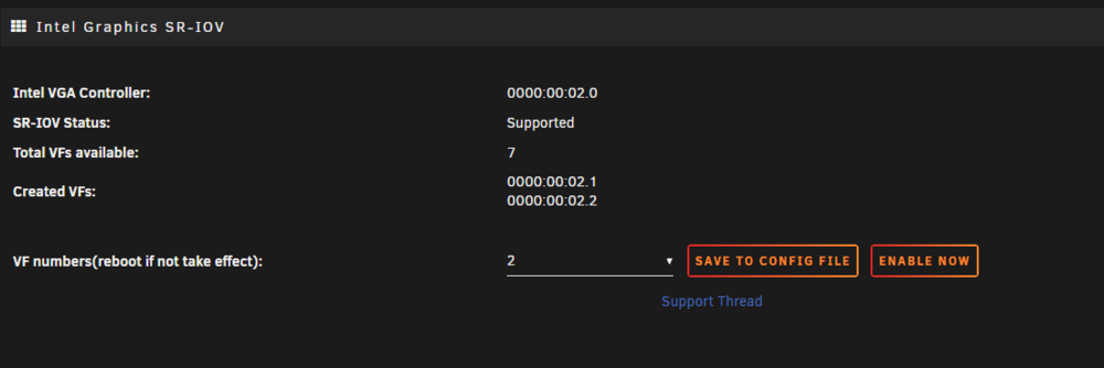

  4. on latest BETA 7.1 (Beta 1) plugin seems broken. no virtual gpus can be created, stays at 0 if i set for example 1 or 2 , the site will "stuck" , if i refresh site, still at 0. uninstall - reboot - reinstall - reboot , didnt fix the issue. i5 14500 update needed?

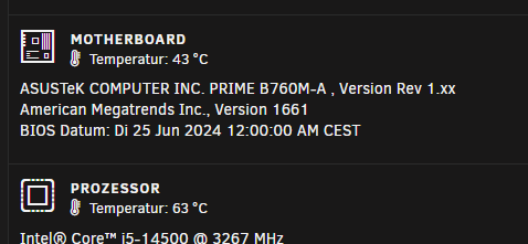

  7. eeeeeeeeeeeeeeeeeeeeeeee @ich777 just tryd now with latest bios update since 30 minutes - all working fine, no magical removed gpu on host system 😮 latest stable unraid, i5 14500 ASUSTeK COMPUTER INC. PRIME B760M-A , Version Rev 1.xx American Megatrends Inc., Version 1661 and i deactivated HD AUDIO + console ports etc on mainboard, powerlimit set to 65W and some fan adjustments, nothing fancy more Edit: Stays stable until i shutdown the VM - after that, GPU disapears. if vm is running -> all good 😮 STRANGE

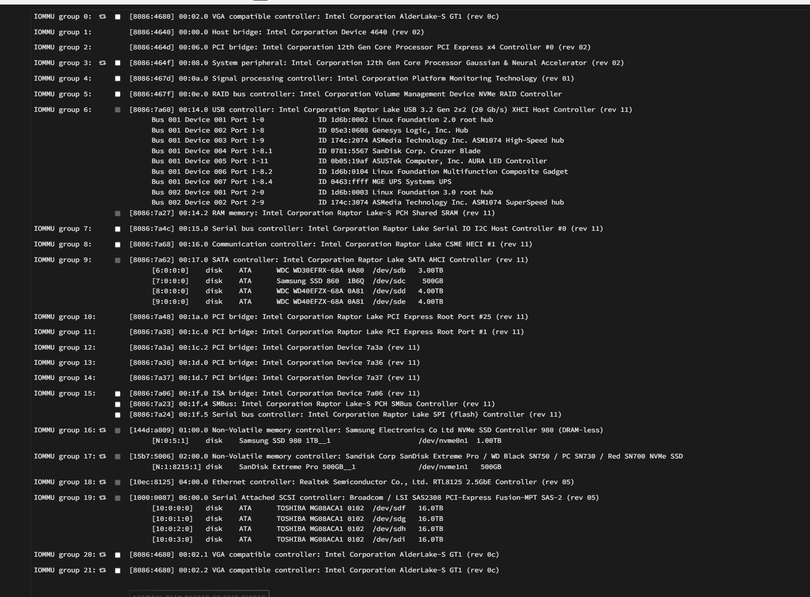

  12. its normal, as i know - same name for me on 14th gen, but transcoding docker jellyfin works fine etc, just sr-iov not working wondering, why its on your 12th gen too. i tested complete fresh unraid usb stick, setted bios/uefi back to default, just enabled virtualisation, iommou groups, sr-iov enabled in bios etc etc. but still same, gpu will be removed from host after like 1 minutes or two , or after reboot, even from host system -> reboot required. hope it will be fixed 2024 or upstreamed to kernel trough intel self.

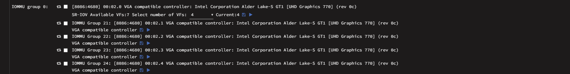

  13. Using latest Unraid i5 14500 B760M-A Motherboard downloaded plugin, activated plugin etc. created the virtual gpus, passtrough it to the vm - so far so good BUT after the vm starts 1-2minutes or if i shutdown the vm, the GPU disapears, even from the host iteself and i need to reboot host machine to bring it back Jun 3 14:05:57 NAS kernel: i915 0000:00:02.0: [drm] GT0: GuC firmware i915/tgl_guc_70.bin version 70.13.1 Jun 3 14:05:57 NAS kernel: i915 0000:00:02.0: [drm] GT0: HuC firmware i915/tgl_huc.bin version 7.9.3 Jun 3 14:05:57 NAS kernel: i915 0000:00:02.0: [drm] GT0: HuC: authenticated for all workloads! Jun 3 14:05:57 NAS kernel: i915 0000:00:02.0: [drm] GT0: GUC: submission enabled Jun 3 14:05:57 NAS kernel: i915 0000:00:02.0: [drm] GT0: GUC: SLPC enabled Jun 3 14:05:57 NAS kernel: i915 0000:00:02.0: [drm] GuC RC: enabled Jun 3 14:05:57 NAS kernel: mei_pxp 0000:00:16.0-fbf6fcf1-96cf-4e2e-a6a6-1bab8cbe36b1: bound 0000:00:02.0 (ops i915_pxp_tee_component_ops [i915]) Jun 3 14:05:57 NAS kernel: i915 0000:00:02.0: [drm] Protected Xe Path (PXP) protected content support initialized Jun 3 14:05:57 NAS kernel: [drm] Initialized i915 1.6.0 20201103 for 0000:00:02.0 on minor 0 Jun 3 14:05:57 NAS kernel: ACPI: video: Video Device [GFX0] (multi-head: yes rom: no post: no) Jun 3 14:05:57 NAS kernel: input: Video Bus as /devices/LNXSYSTM:00/LNXSYBUS:00/PNP0A08:00/LNXVIDEO:00/input/input7 Jun 3 14:05:57 NAS kernel: i915 0000:00:02.0: 7 VFs could be associated with this PF Jun 3 14:05:57 NAS kernel: ata6.00: Enabling discard_zeroes_data Jun 3 14:05:57 NAS kernel: sdc: sdc1 sdc2 sdc3 sdc4 Jun 3 14:05:57 NAS acpid: input device has been disconnected, fd 11 Jun 3 14:05:57 NAS kernel: pci 0000:00:02.0: Removing from iommu group 0 any way to fix this? iommou 0 is the intel gpu tested with passtrough 0000:00:02.1 and 0000:00:02.2 and with the gpu itself (thats the log file, but same issue if i use .1 and .2 - just tested all i can... this are the last lines if using 0000:00:02.2 (group 21) --ignore the filesystem on my ssd n 3 14:48:37 NAS kernel: vfio-pci 0000:00:02.2: vgaarb: changed VGA decodes: olddecodes=io+mem,decodes=io+mem:owns=none Jun 3 14:48:37 NAS kernel: br0: port 4(vnet2) entered blocking state Jun 3 14:48:37 NAS kernel: br0: port 4(vnet2) entered disabled state Jun 3 14:48:37 NAS kernel: device vnet2 entered promiscuous mode Jun 3 14:48:37 NAS kernel: br0: port 4(vnet2) entered blocking state Jun 3 14:48:37 NAS kernel: br0: port 4(vnet2) entered forwarding state Jun 3 14:48:39 NAS kernel: device-mapper: ioctl: 4.47.0-ioctl (2022-07-28) initialised: [email protected] Jun 3 14:48:39 NAS kernel: ata6.00: Enabling discard_zeroes_data Jun 3 14:48:39 NAS kernel: sdc: sdc1 sdc2 sdc3 sdc4 Jun 3 14:48:40 NAS kernel: i915 0000:00:02.0: VF2 FLR Jun 3 14:48:41 NAS kernel: i915 0000:00:02.0: VF2 FLR Jun 3 14:48:41 NAS unassigned.devices: Disk with ID 'Samsung_SSD_860_EVO_500GB_S3Z2NB0K660578V (dev2)' is not set to auto mount. Jun 3 14:48:41 NAS unassigned.devices: Disk with ID 'Samsung_SSD_860_EVO_500GB_S3Z2NB0K660578V (dev2)' is not set to auto mount. Jun 3 14:48:41 NAS unassigned.devices: Disk with ID 'Samsung_SSD_860_EVO_500GB_S3Z2NB0K660578V (dev2)' is not set to auto mount. Jun 3 14:48:41 NAS unassigned.devices: Partition '/dev/sdc2' does not have a file system and cannot be mounted. Jun 3 14:49:34 NAS kernel: ata6.00: Enabling discard_zeroes_data Jun 3 14:49:34 NAS kernel: br0: port 4(vnet2) entered disabled state Jun 3 14:49:34 NAS kernel: device vnet2 left promiscuous mode Jun 3 14:49:34 NAS kernel: br0: port 4(vnet2) entered disabled state Jun 3 14:49:34 NAS kernel: sdc: sdc1 sdc2 sdc3 sdc4 Jun 3 14:49:34 NAS kernel: i915 0000:00:02.0: VF2 FLR Jun 3 14:49:36 NAS unassigned.devices: Disk with ID 'Samsung_SSD_860_EVO_500GB_S3Z2NB0K660578V (dev2)' is not set to auto mount. Jun 3 14:49:36 NAS unassigned.devices: Disk with ID 'Samsung_SSD_860_EVO_500GB_S3Z2NB0K660578V (dev2)' is not set to auto mount. Jun 3 14:49:36 NAS unassigned.devices: Disk with ID 'Samsung_SSD_860_EVO_500GB_S3Z2NB0K660578V (dev2)' is not set to auto mount. Jun 3 14:49:36 NAS kernel: vfio-pci 0000:00:02.2: vgaarb: changed VGA decodes: olddecodes=io+mem,decodes=io+mem:owns=none Jun 3 14:49:36 NAS kernel: i915 0000:00:02.2: Running in SR-IOV VF mode Jun 3 14:49:36 NAS unassigned.devices: Partition '/dev/sdc2' does not have a file system and cannot be mounted. Jun 3 14:49:36 NAS kernel: i915 0000:00:02.2: [drm] GT0: GUC: interface version 0.1.4.1 Jun 3 14:49:36 NAS kernel: i915 0000:00:02.2: [drm] VT-d active for gfx access Jun 3 14:49:36 NAS kernel: i915 0000:00:02.2: [drm] Using Transparent Hugepages Jun 3 14:49:36 NAS kernel: i915 0000:00:02.2: [drm] GT0: GUC: interface version 0.1.4.1 Jun 3 14:49:36 NAS kernel: i915 0000:00:02.2: GuC firmware PRELOADED version 1.4 submission:SR-IOV VF Jun 3 14:49:36 NAS kernel: i915 0000:00:02.2: HuC firmware PRELOADED Jun 3 14:49:36 NAS kernel: i915 0000:00:02.2: [drm] Protected Xe Path (PXP) protected content support initialized Jun 3 14:49:36 NAS kernel: i915 0000:00:02.2: [drm] PMU not supported for this GPU. Jun 3 14:49:36 NAS kernel: [drm] Initialized i915 1.6.0 20201103 for 0000:00:02.2 on minor 2 Jun 3 14:49:36 NAS usb_manager: Info: rc.usb_manager vm_action Windows 11 stopped end - Jun 3 14:49:37 NAS kernel: i915 0000:00:02.0: vgaarb: changed VGA decodes: olddecodes=none,decodes=none:owns=io+mem Jun 3 14:49:37 NAS kernel: i915 0000:00:02.2: vgaarb: changed VGA decodes: olddecodes=io+mem,decodes=none:owns=none Jun 3 14:49:37 NAS kernel: pci 0000:00:02.1: Removing from iommu group 20 Jun 3 14:49:37 NAS kernel: i915 0000:00:02.0: vgaarb: changed VGA decodes: olddecodes=none,decodes=io+mem:owns=io+mem Jun 3 14:49:37 NAS kernel: pci 0000:00:02.2: Removing from iommu group 21 Jun 3 14:49:38 NAS kernel: i915 0000:00:02.0: Disabled 2 VFs Jun 3 14:49:38 NAS kernel: Console: switching to colour dummy device 80x25 Jun 3 14:49:38 NAS acpid: input device has been disconnected, fd 11 Jun 3 14:49:38 NAS kernel: pci 0000:00:02.0: Removing from iommu group 0 nas-diagnostics-20240603-1411.zip
