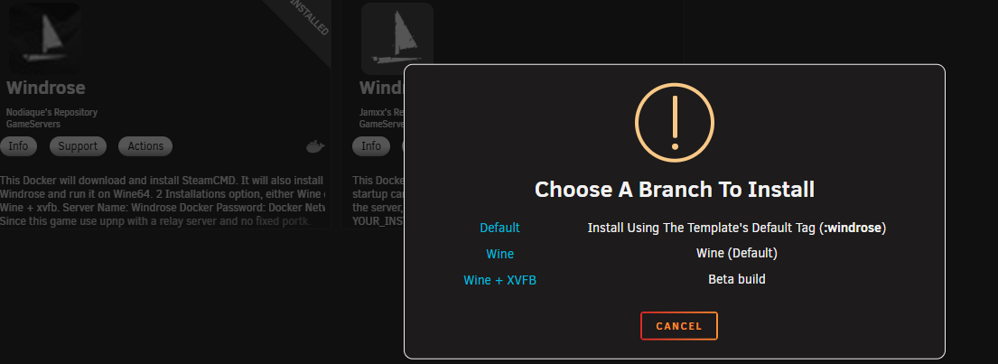

  6. You can try to force the update using the tip in post #2. Maybe it will clear it. I just tried installing the docker and it worked no problem. There's also a new docker using wine 11 instead of wine 10, tag windrose-beta instead of windrose. Might help with performance

  8. windrose-beta is brand new from today, using a different wine. You have to manually input this in the repository to use it. You can revert to windrose or windrose-xvfb if that's the case. Although I didn't had your issue with windrose-beta
  9. hmmmm the docker itself was updated only 3 days ago. Can you check under repository what you have?
  10. is that on windrose or windrose-xvfb, or windrose-beta? I do see a wine error like if it doesn't have permission to access file. Can you chmod and chown your appdata to be sure it's properly set?
  11. I've pushed a new docker nodiaque/steamcmd:windrose-beta. The main difference here is wine 11.0 vs wine 10.0. It was suggested to update wine to latest version to fix some problem. If someone want to test, simply change the repository and run. I strongly suggest doing a backup of the appdata before just in case.
