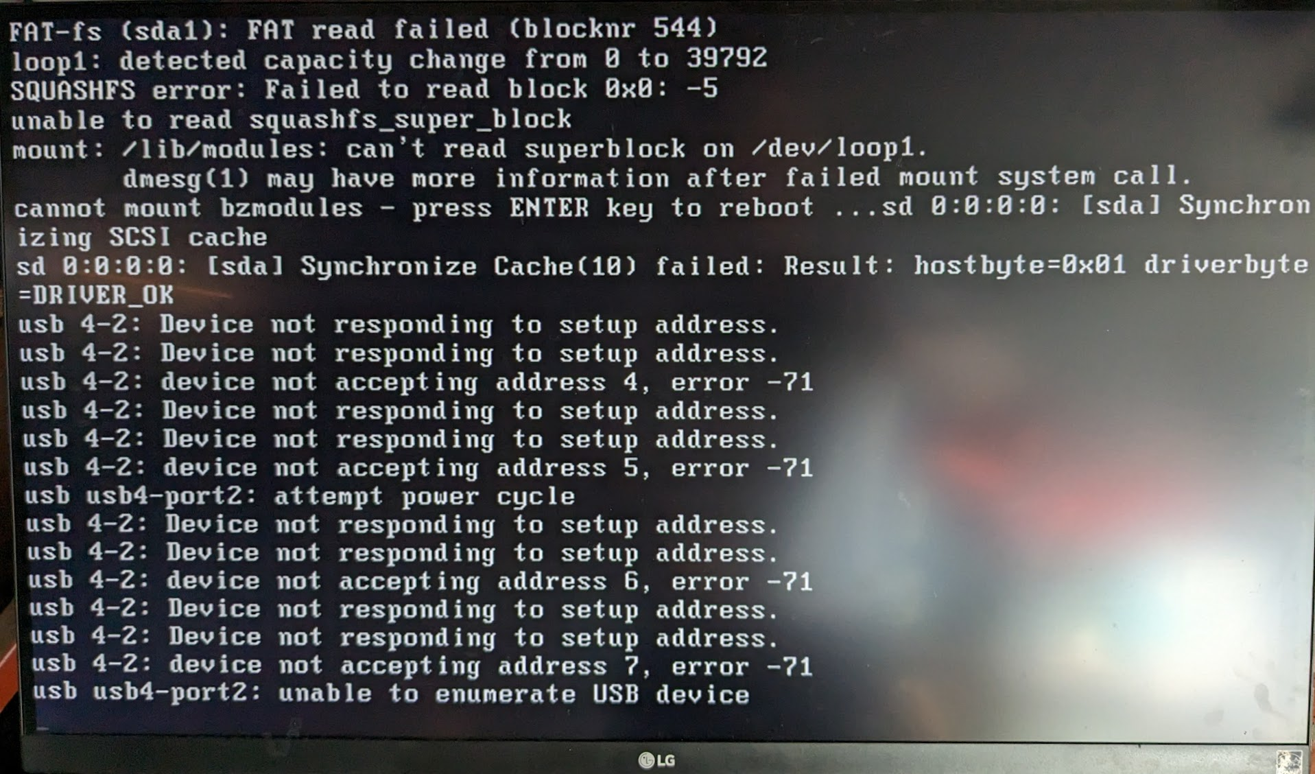

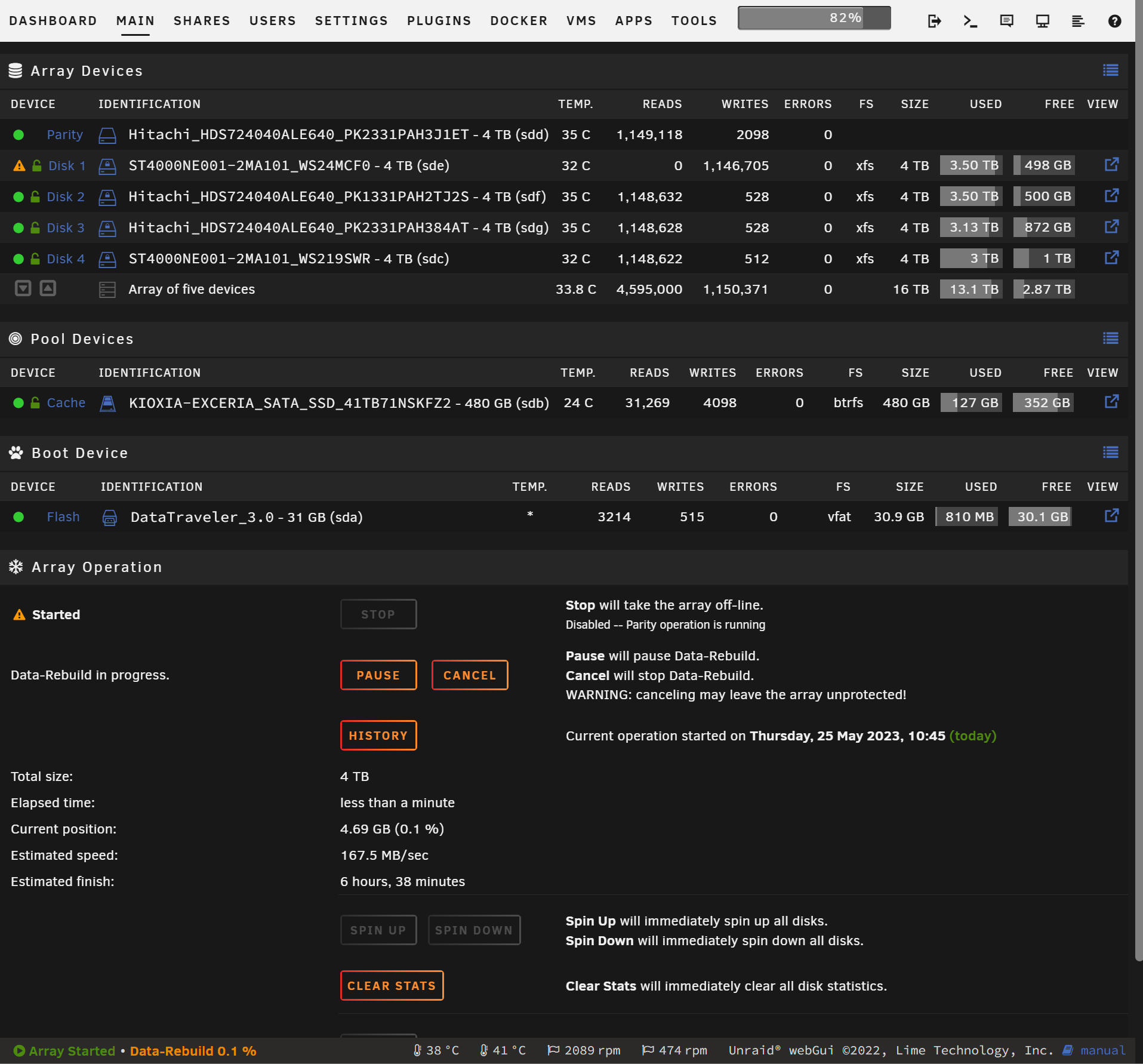

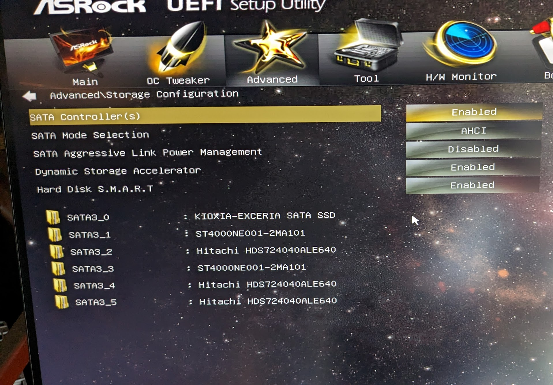

  4. I have four 4 TB drives plus parity and a cache drive. One of the drives has been reported hundreds of errors recently so I bought a replacement and put it in according to this guide. I checked in the BIOS that the new drive was connected OK with this: When I boot the server though I get this screen: What does this mean? Not sure what to do next.

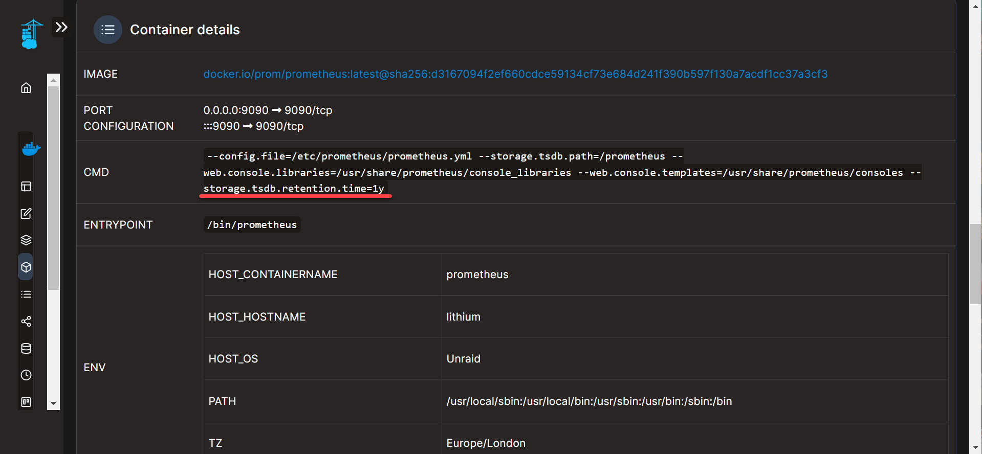

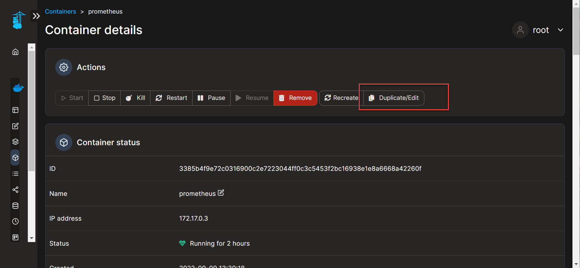

  5. I want to run prom/prometheus in a container in UNRAID. I have added this to keep one year of metrics data to the docker run command: --storage.tsdb.retention.time=1y If my container gets updated by unraid, will it pull down a new image and remove this? I updated the container in portainer using Duplicate/Edit but I'm worried the setting will get lost. Here's the RUN command

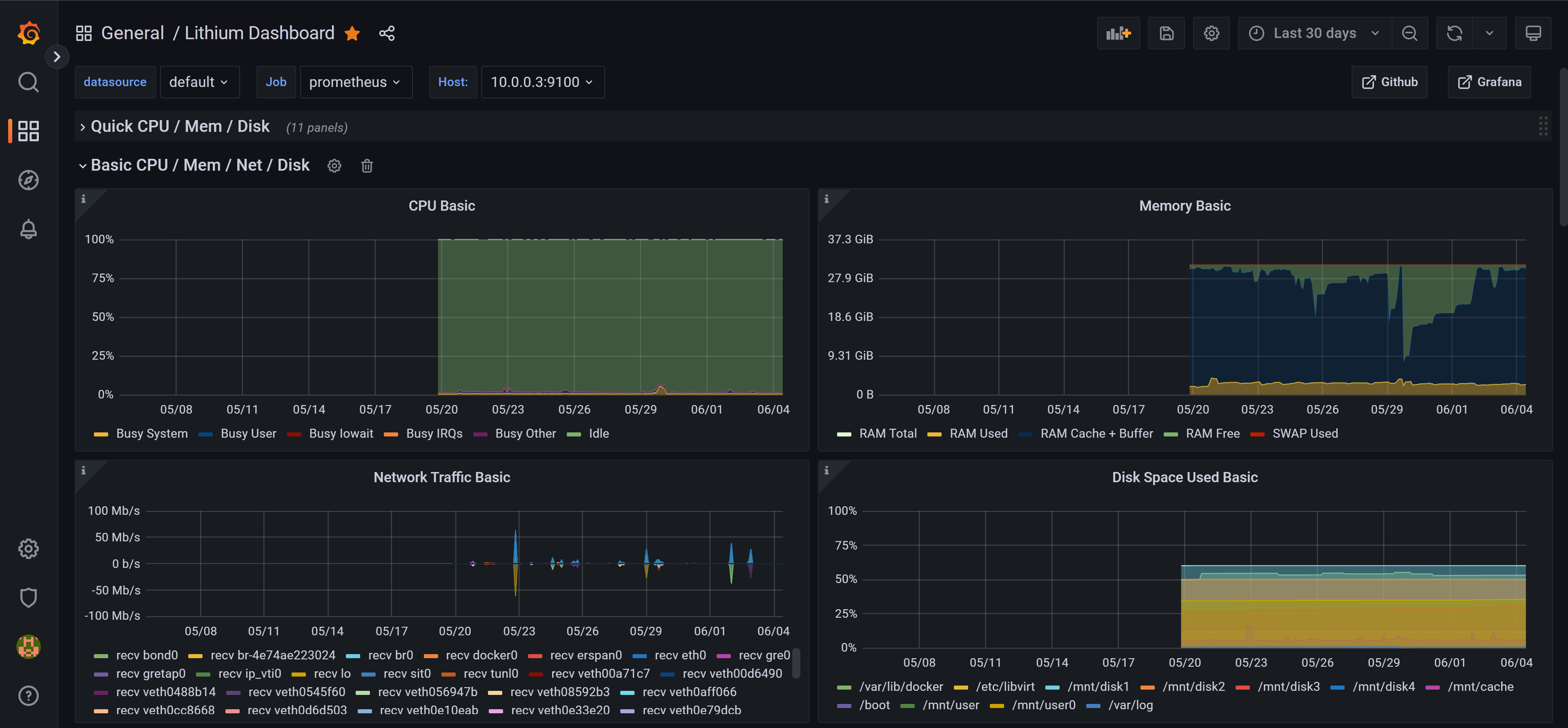

  6. I have prometheus and grafana running to record performance metrics for my unraid system according to this guide https://unraid.net/blog/prometheus I can only see 15 days history though, how can I extend that? Where is it configured? I had a look in the prometheus and grafana settings but couldn't find anything.

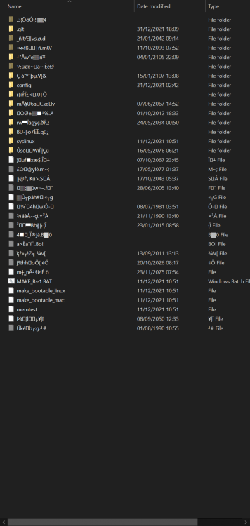

  8. My server was rebooted today and it gets to the Lime Technology Screen, and I select Unraid OS as the boot option but nothing happens. No errors, but not booting either. Automatic boot just goes in a loop. The only option that works on that screen is the Memtest86+ option. Do I need to restore my flash drive? I'm still on the trial period. Thanks. UPDATE I put the flash drive into Windows and Windows reported that there are problems with the drive. Windows could not repair it. When I look in the folders it looks like this: I had automatic backups switched on but can't find where to restore them. Could someone point to me where I can download the automatic flash backups files? UPDATE2 I can recover the config folder from the USB drive. I have a backup from 12th Dec but I've added a cache drive and another HDD since then so need to copy over the config? Still can't find where to download my USB Flash drive automatic backups.

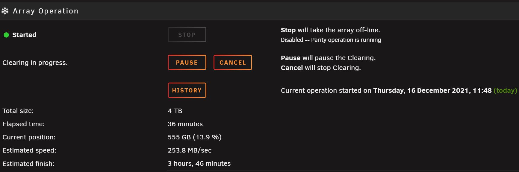

  12. Maybe I'm misunderstanding something but I ran the preclear docker script on my new 4 TB disk. Next day I added it to the array and now UNRAID is telling me it's clearing. Just wondering what the point of preclear is if UNRAID does it anyway?

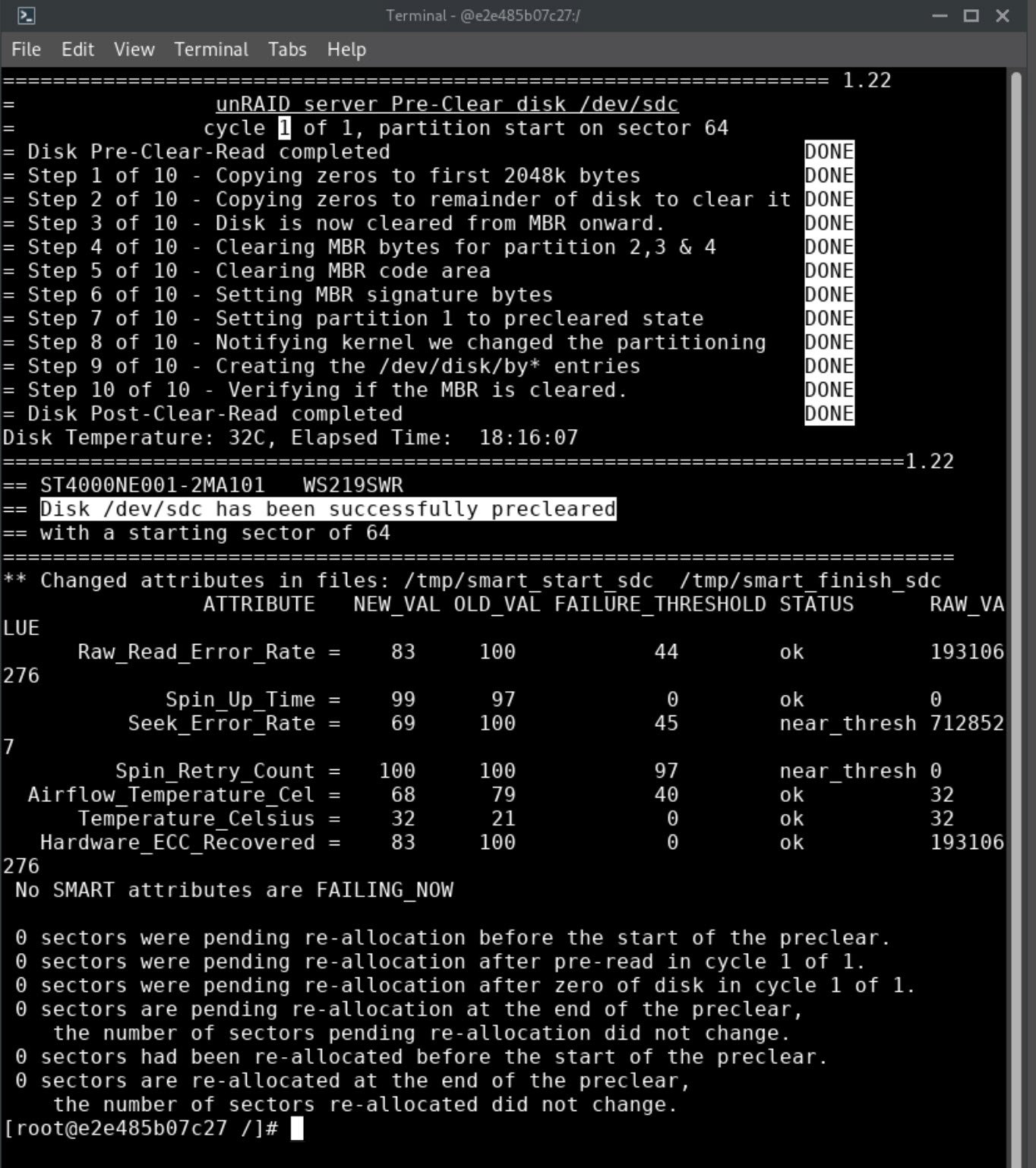

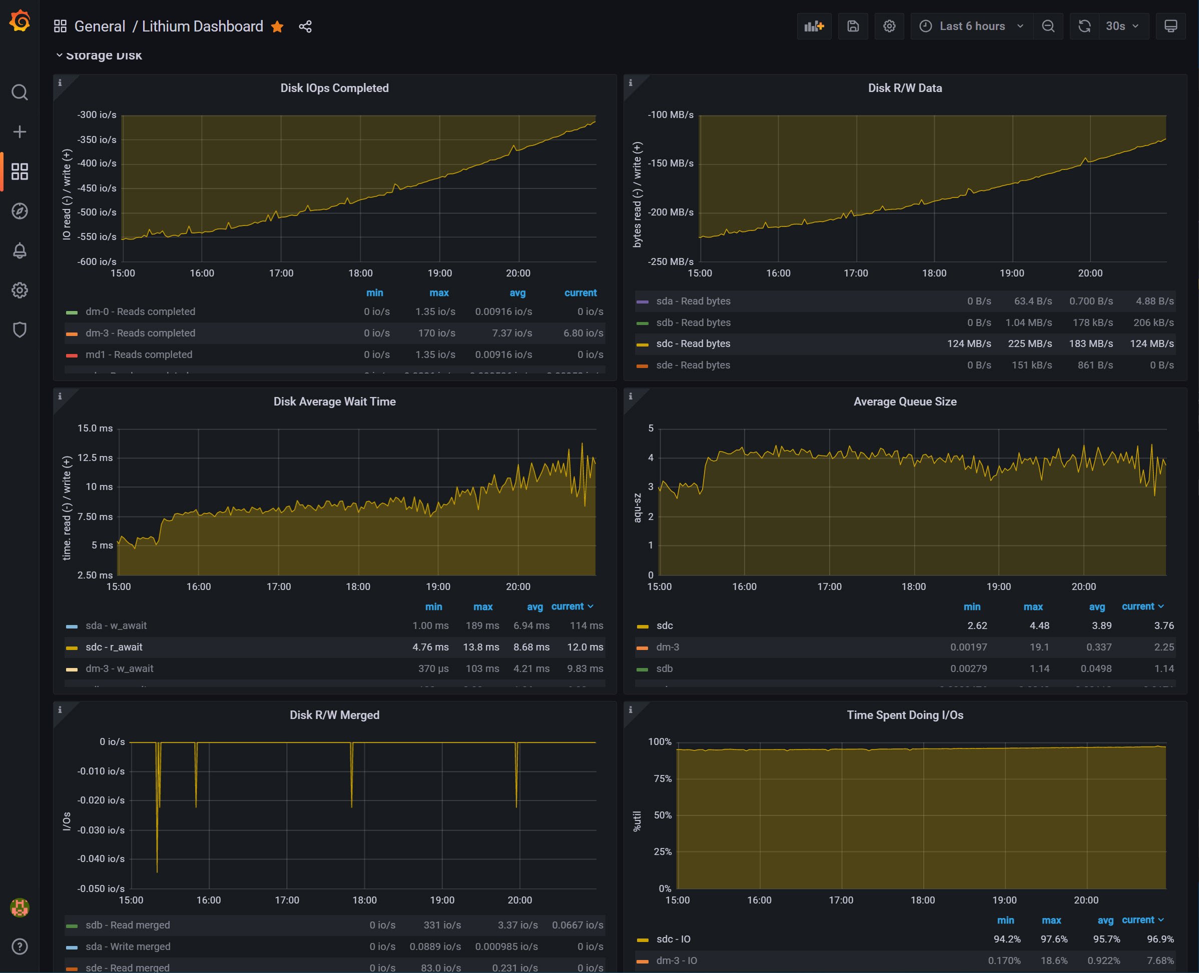

  14. I put a new Seagate Ironwold Pro drive into my server today and ran preclear. It took six hours to run but slowed down over time. I'm wondering why this might be, perhaps starting at the edge of the disk and moving inwards to the centre? Io/s and throughput almost halved towards the end.
