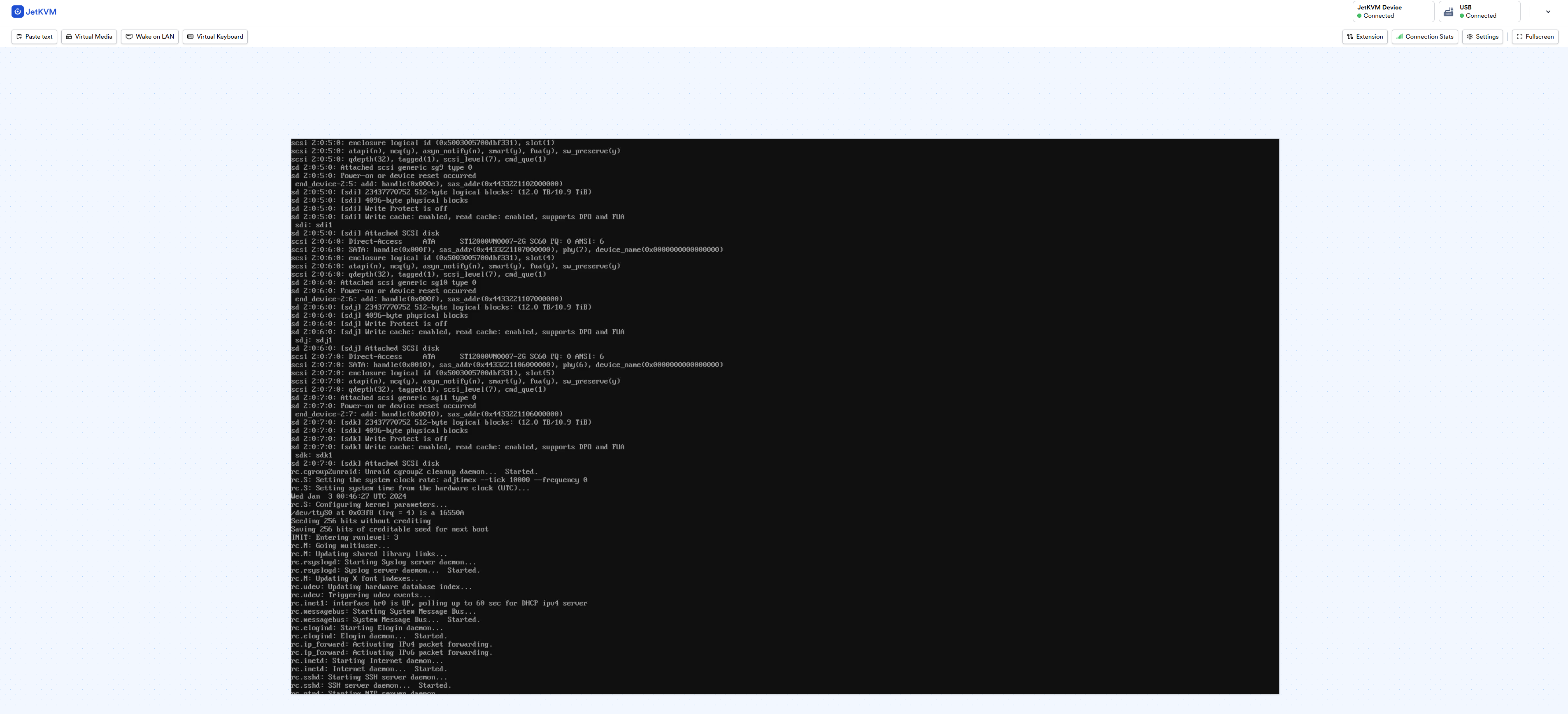

  5. This isnt related to the laptop resolution. I have the same issue on my 4k monitor and my 1440p laptop. Is there a solution in sight? As of now the JetKVM is not usable together with Unraid to work directly in the Unraid Shell :/
