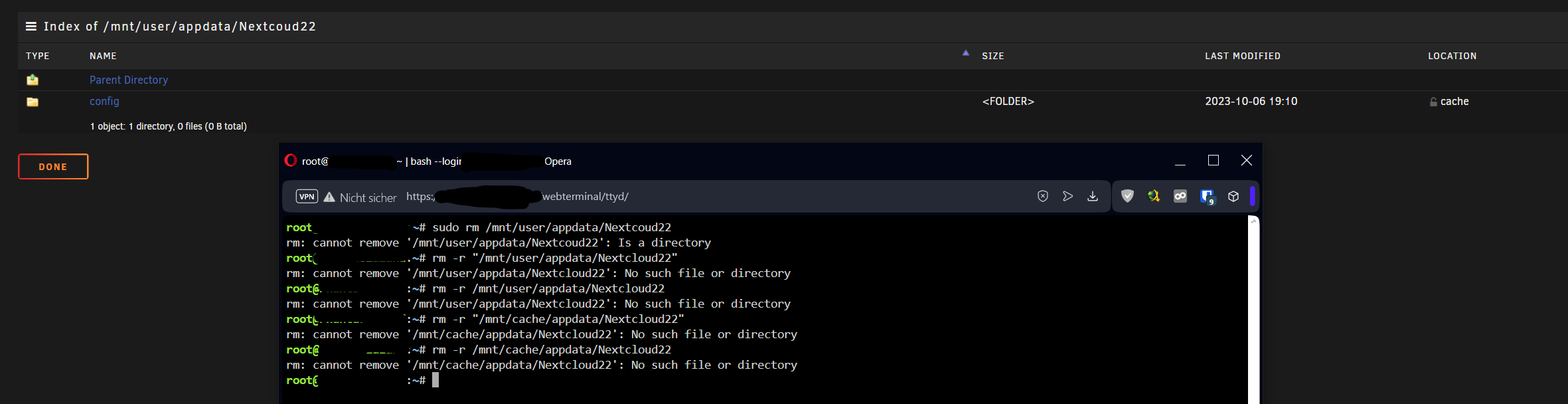

  4. ok, wow. i did not know, i have to care about large and lower letters. im sorry and thanks for your help, very much appreciated!
  5. yes you are right again But then the first command line should have worked right? without the "l" i just tried: sudo rm -r /mnt/cache/appdata/nextcoud22 and sudo rm -r /mnt/user/appdata/nextcoud22 and still same error. Still cannot delete it via Krusader...
  6. Thanks for the reply. You are right, i miswrote it in the first line. However the command sudo rm /mnt/user/appdata/nextcloud22 also has the same output: rm: cannot remove '/mnt/user/appdata/nextcloud22': No such file or directory And i dont know why, because the directory exists...

  8. Hello guys, i want to delete a folder with some files in it. Its no longer in use (Nextcloud and MariaDB are no longer installed). But i cannot delete it via krusader nor terminal/console. I tried the following. Any ideas what i am doing wrong? I created a folder on /appdata and deleted it successfully. I am on OS v6.12.5.

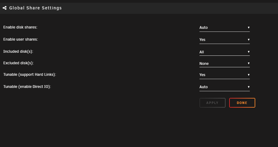

  10. Hallo, ich bin durch Suche auf diesen Thread aufmerksam geworden und mich würde interessieren, wo man den min free space des Cashe erhöhen kann? Habe das Array gestoppt und unter den Global Share Settings finde ich dazu keinen Punkt? Beste Grüße
