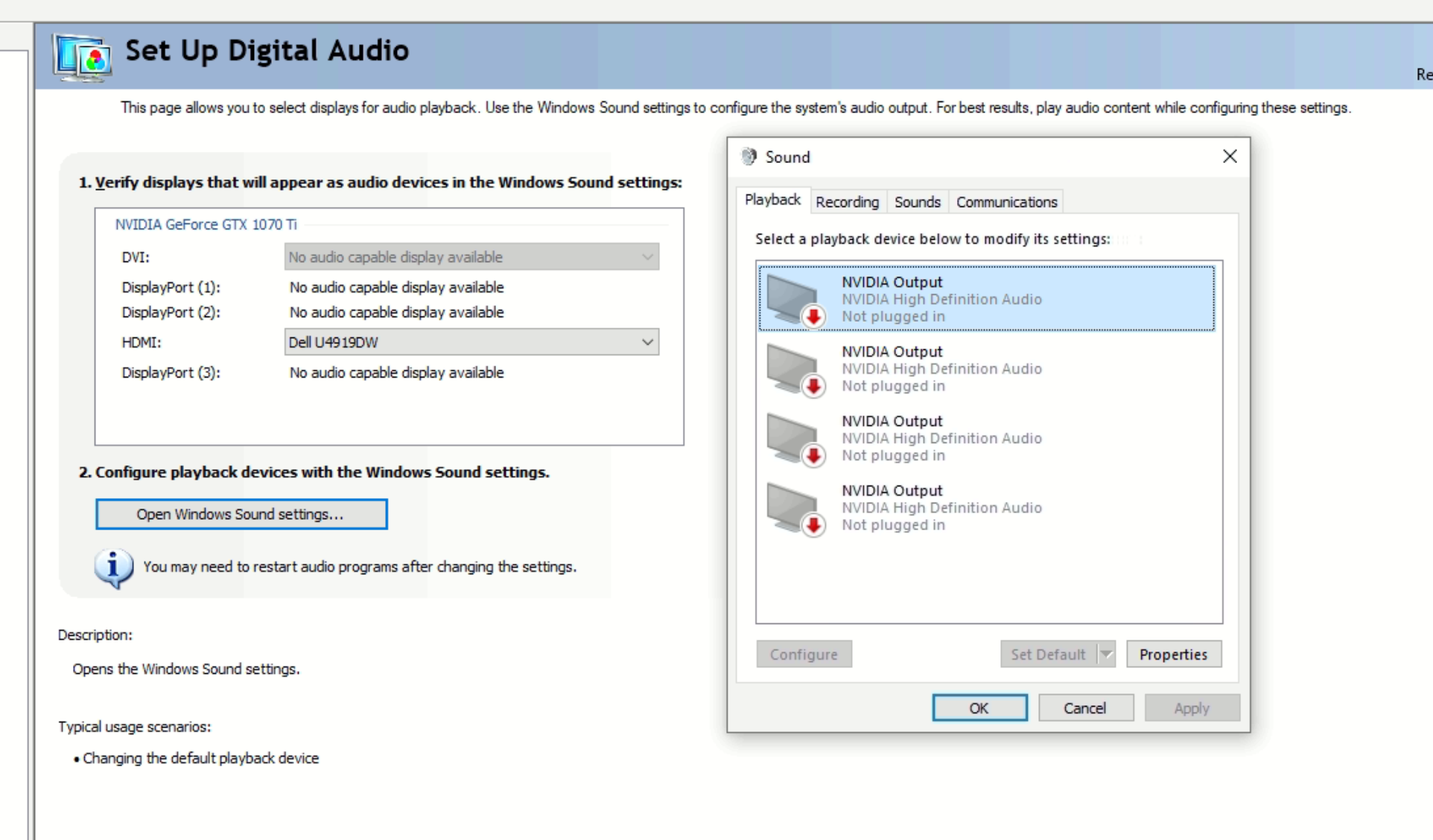

  5. Once I switched to a monitor with optical out, the system detects an output. So there was no issue here, just no output device present in my first monitor's EDID. Thanks to both of you for the suggestions; I learned some things!

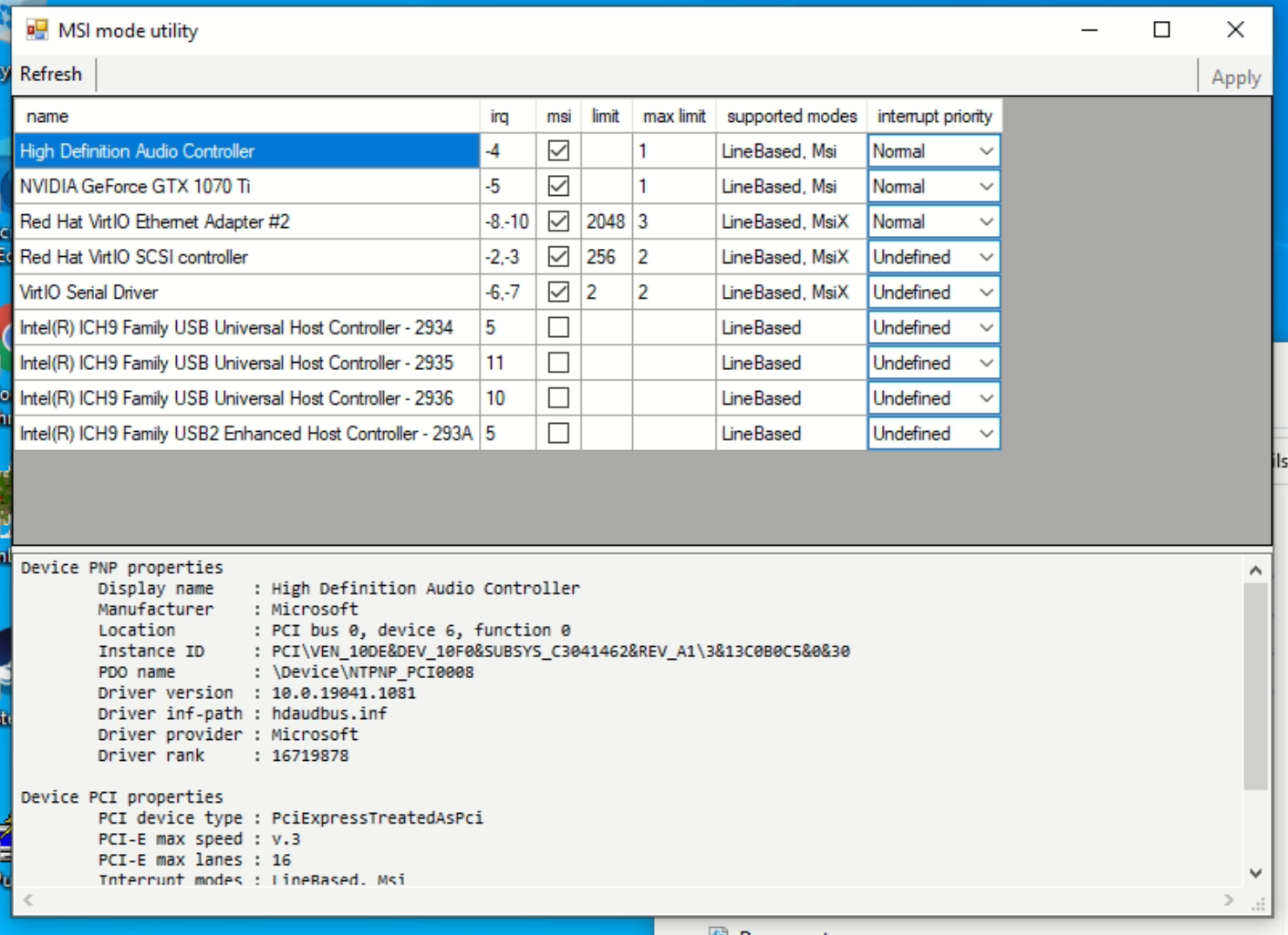

  6. ... yet I don't see a specific Nvidia soundcard in the MSI interrupt list. Just this Microsoft HD Audio controller and driver. Both GPU and sound card seem to be properly selected in the VM config... Thanks for any insights!

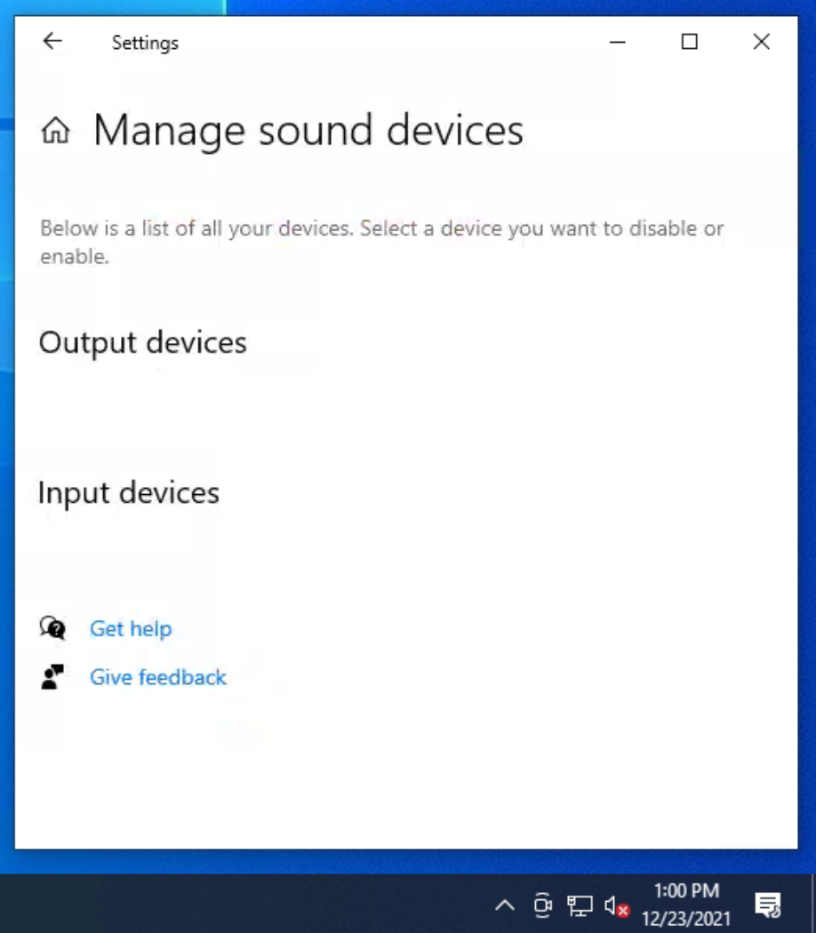

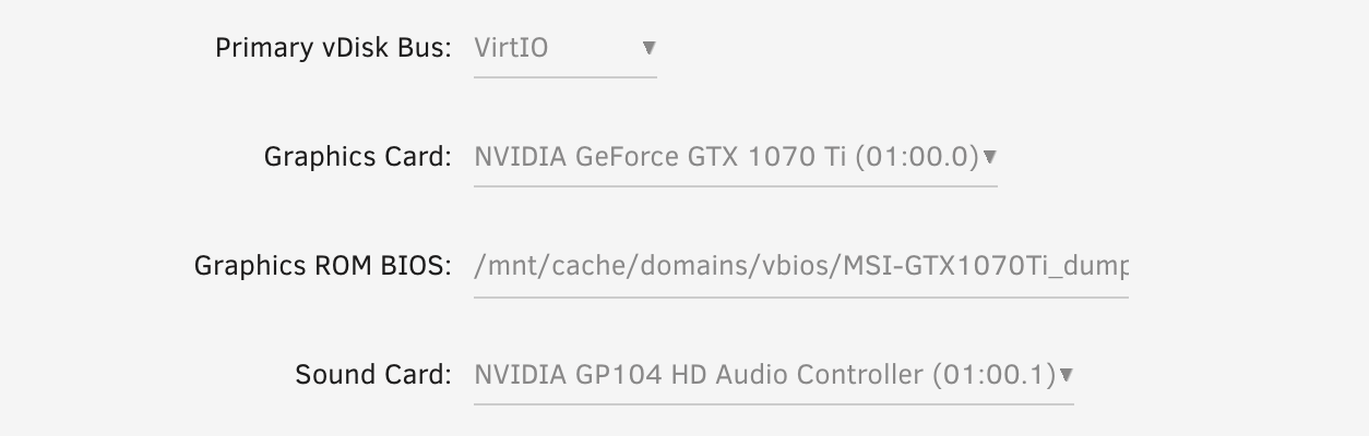

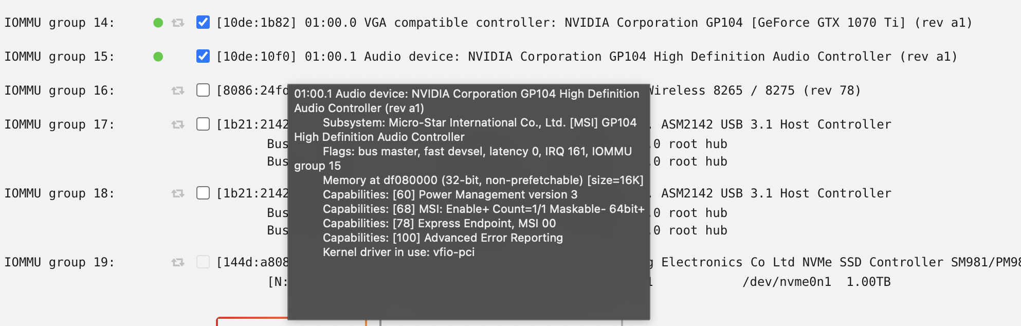

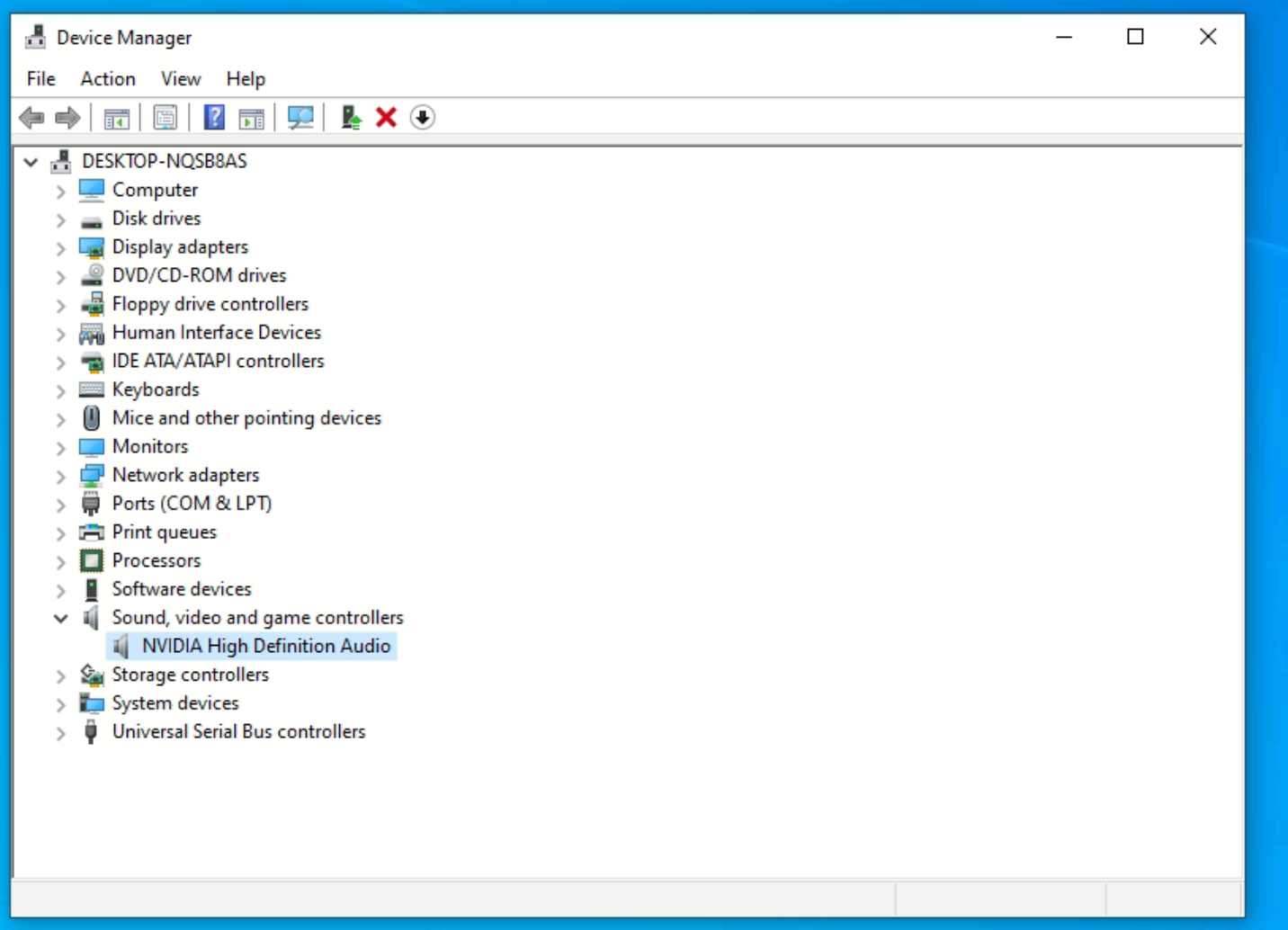

  7. What else might be preventing nvidia from being detected as a sound output device? I have passed through my 1070ti gpu and sound card, and have enabled MSI interrupts. Device Manager shows the NVidia HD Audio, but windows does not detect an output device.
