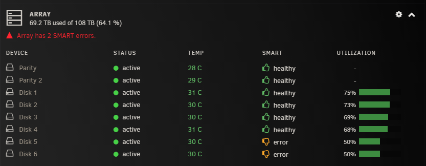

Alright, so things seem to be stable. I ended up replacing the SATA cables as per your suggestions. Thank you all for your continued support. Marking this as solved.

Ok, so more updates. The drive in question doesn't seem to be spitting out any UDMC CRC errors after moving it to another bay slot (confirmed under the warning notification history page as well); however, is it normal for it to continue showing as a drive with errors on the dashboard (see below for reference)? I assume it has to do the smart attribute being stored and read by unraid and still being shown as a drive with errors? Further to that, I seem to have 1 more drive that's showing similar errors. I'll try do what @JorgeBrecommended and report back.

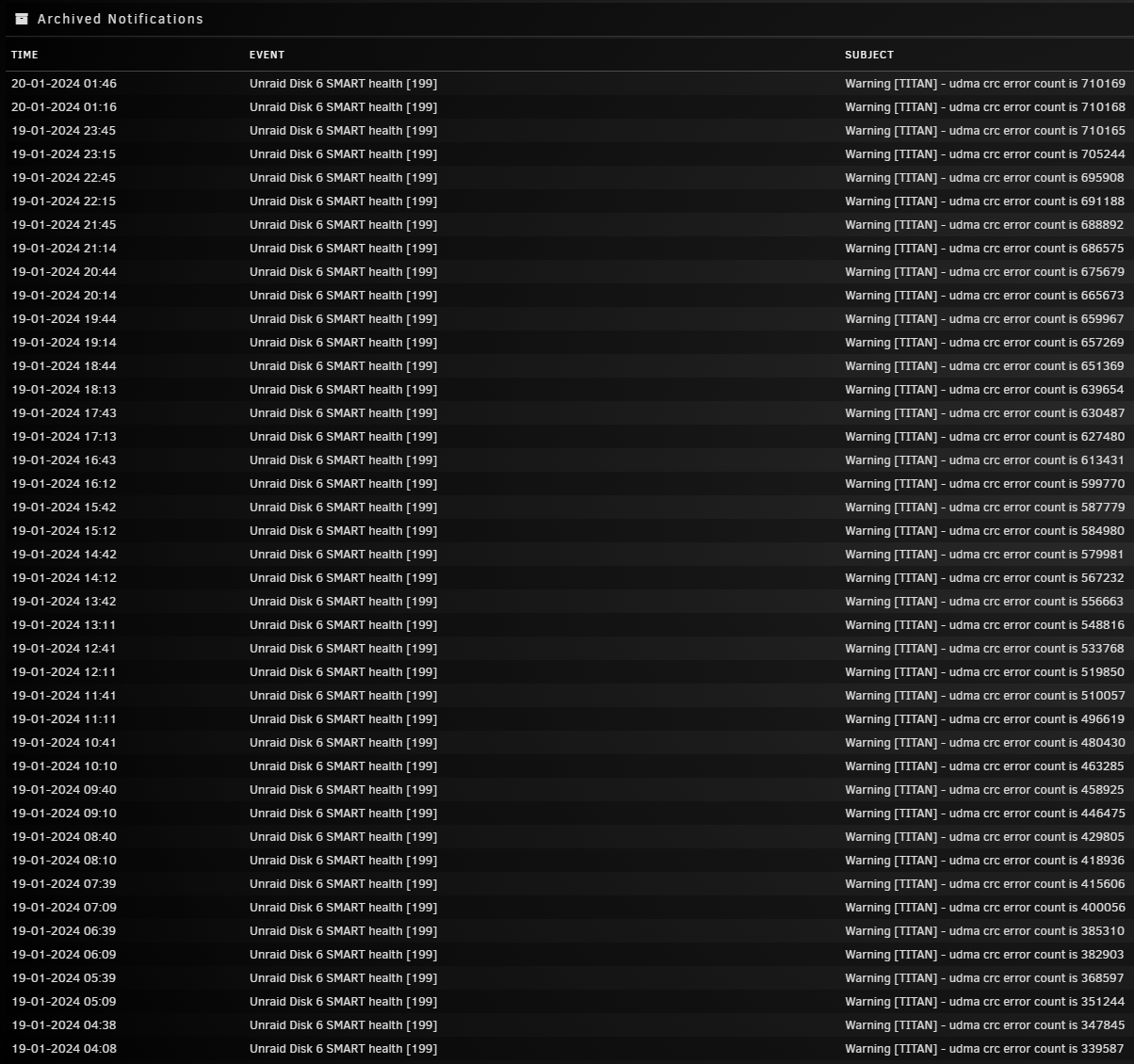

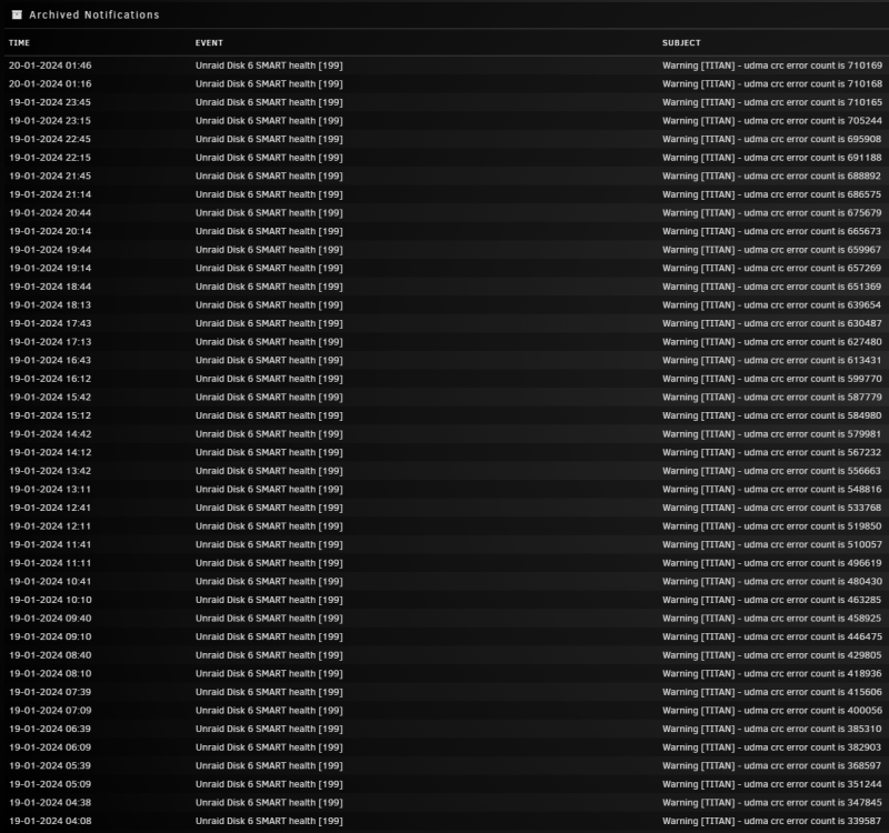

My Unraid server is seeing an increased number of udma crc errors for one of the disks. Please see attached for reference. I've tried reseating the SATA cables yesterday per some suggestions on this forum and the error count is still increasing. I'm currently running an extended self test on all my drives and will report back with the results (hopefully in a day). In the interim, I've included the diagnostics file - hoping someone can help me out. Much appreciated in advance. titan-diagnostics-20240120-0208.zip
