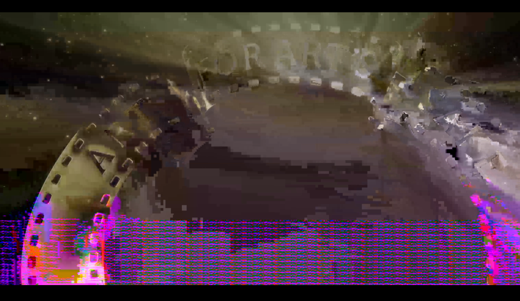

  8. Thats awesome!! This just solved nearly all of my issues!

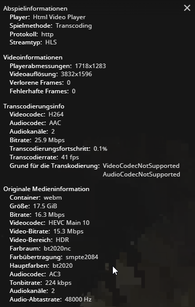

  9. Damn.. so no chance atm to play these videos, unless encoding is disabled.
  10. Nice to know! Thank you! Same problem on phone and tablet.
  11. Thank you very much! I'm not sure, but video detail display h264..
  12. Yes HDR content. Encoding is working fine with 1080p H264 SDR but all of my H264 Files have HDR.....
  13. Like 98% of my media is H264 / HEVC. Wasnt able to play any media file! UPDATE After completly uninstall and manualy removing all config files, I was able to activate decoding. Video Playback seems to be working, but not that right..
