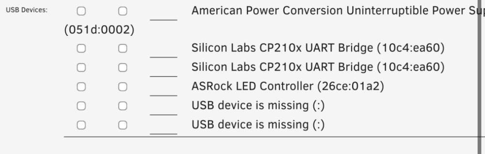

  1. Aeotec Zwave HUB Skyconnect zigbee hub for PC hardware: ASRock B550M Steel legend Ryzen 5 5500 both connected to the motherboard

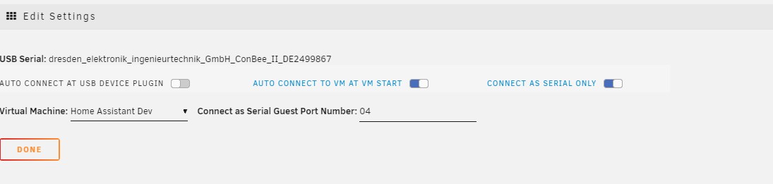

  2. Connected directly to the motherboard. no changes in the last year. I shutdown unraid and changed the USB device ports and same issue.

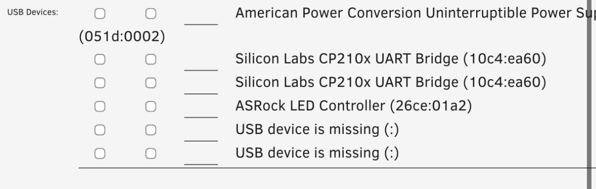

  3. Version 6.12.9 I have two USB devices (Zwave and a Zigbee hub) plugged into unraid and they are assigned to my VM. Last two days unraid will stop remembering I have two USB devices plugged in. They won’t appear in system devices, usb manager will not see them, and they will not appear under USB devices in VM edit. if I restart unraid, the USB devices will reappear and work for around 8 hours. even after restarting, under the USB device section for a VM, I will see two “USB device is missing” even though both are showing. Also for some reason unraid keeps naming my silicon lab USBs all the same. They appear different in USB manager.
  4. Even when doing this, I still don't have any sound drivers on my my Windows Vm. Even if I try to do multifunction='0'
  5. Yep that's the way I'm setup. Almost identical on the HA side. Update: I just installed an USB extender and that was the issue. It was too close to my Z-Wave USB and possibly too close to the computer for it's liking. This was the reason why it was failing the radio setup thanks for your help though!

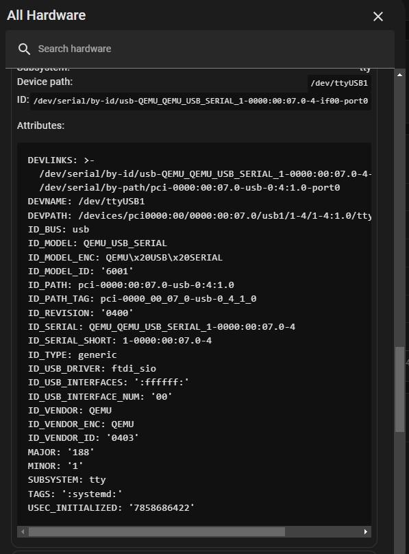

  6. I'm trying to understand this to see if I can do the same. Can you explain this deeper?
  7. When I select keep radio network settings it will finish the setup but not work, and if i select erase network settings and form a new network, it says failed.
