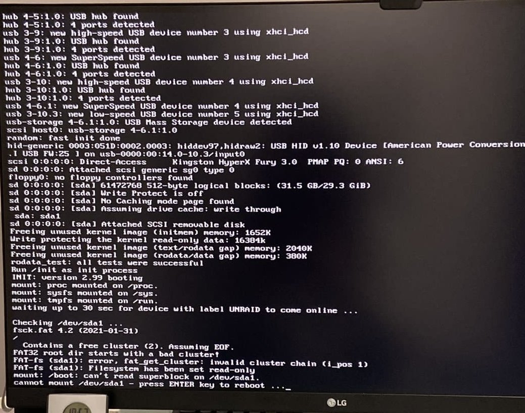

  18. Ok, so I’ve run chkdsk /f and /r and it solved an error on the usb drive. Now the servers boots again. I’ll check the performance and come back to tell the news. thanks
  19. Ok so I think my usb drive just died. Here what I did, following this guide: https://wiki.unraid.net/Console#To_cleanly_Stop_the_array_from_the_command_line Stopped mover Stopped docker Stopped Samba umount /dev/md1 umount /dev/md2 (only 2 disk + parity in the array) /root/mdcmd stop reboot Now the server refuses to boot. I do have a backup of the usb drive using the my server plugin, but I’m not sure how to proceed.
