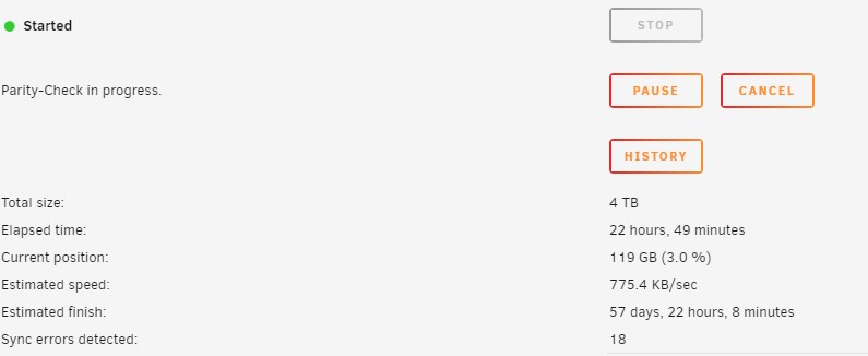

Well, that seems to have done it. ETA is a more reasonable 9 hours, disk error are zero at the moment on both drives. Have included diags as requested just the same. A big thanks JorgeB, Much appreciated. diagnostics3.zip syslog3.zip

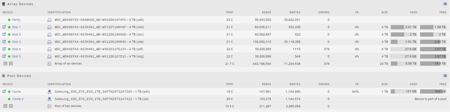

Might be getting ahead of myself here, but if I am to replace a HDD, there is something about my drives that have to be considered. Appart from the cache pool which are both SSD, the other drives (both storage and parity) are all WD Red's. These feature SMR (Shingled magnetic) recording technology, as oposed to WD Red Plus, which are CMR (Conventional Magnetic) recording technology. One of the reasons I adopted Unraid instead of TrueNas, is that the latter's file system (ZFS) does not play nice with SMR drives. So my question is, is it ok to replace a defective SMR drive in Unraid with a CMR drive, with the understanding that I maintain my Unraid's current file system as xfs ?

Greetings everyone. My system is attempting to run a parity check, but the eta is way out there (57 days). The parity check has been running closed to 24 hours and was at 3% completed. I have since aborted the parity check. It had found 18 errors at the time. (Also note the 576 errors on disk 4, however Smart Test (included) isn't showing anything out of the ordinary I believe) Sounds like a failing drive but....? I looked at other similar posts but not sure I have the same situation. All the drives seem to be functioning (no drives with a red "x"). I will include my system log along with a couple of screen caps. (If you need the diagnostics zip, let me know) Any assistance would be greatly ap preciated. syslog.zip Smart_Test_Disk4.zip diagnostics20232509.zip
