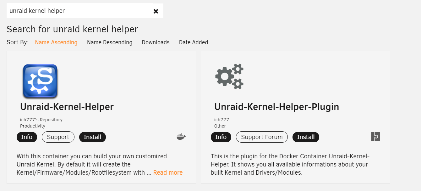

  9. Huge thanks @ich777 for the amazing effort. Nevermind this question found the answer in the description after installing the plugin "If you haven't created your own Images yet, you can do that by downloading the Docker Container 'Unraid-Kernel-Helper' from the CA App." ___ One simple (potentially dumb) question, when I searching the community applications I see both a plugin and doctor, which is the right one to use ? I'm looking to patch amd reset bug with this Thanks a ton !
