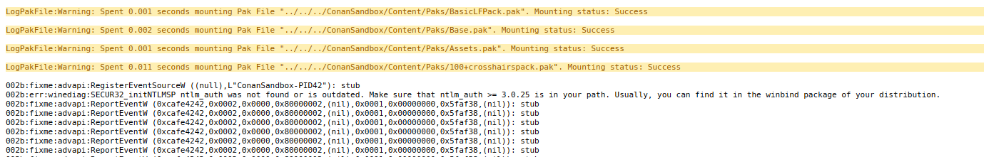

  5. Interesting. The server does appear to be running now. I believe your suggestion to delete WINE64 did it, but the docker log shows all those errors still. The Conan log appears to show the server is up an running and I can now see it is online and connect. I restored the original game data directory and deleted the WINE64 directory and both servers are now back and connectable again. As you suggested, seemed like an issue with WINE. Worth noting that the docker logs used to show Conan server events and information, but now they do not and I can only find that info in the game server logs directly. Thanks for your help!

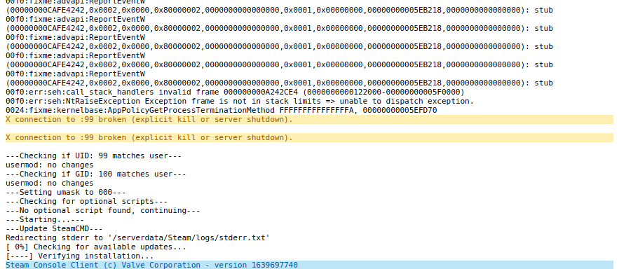

  7. I see that some people have been having issues since the recent update. I too am having an issue with the Conan Exiles container. I'm getting the following error: This just repeats indefinitely. Both my Conan Exiles containers are doing the same thing since the update. So I stopped the container, renamed the server data volume so the container starts as if it was new. It downloaded the game, but it never came online. I just continued to throw these same errors as it did before.

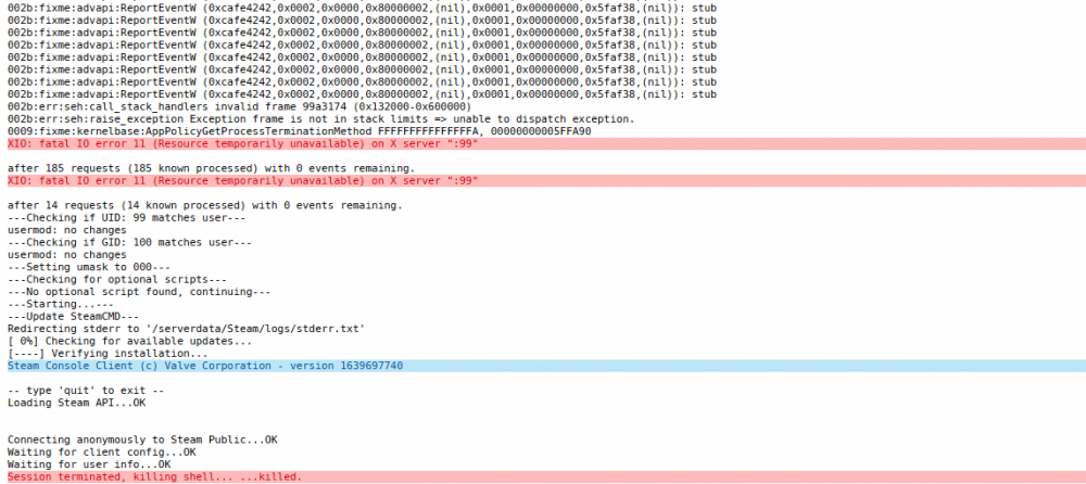

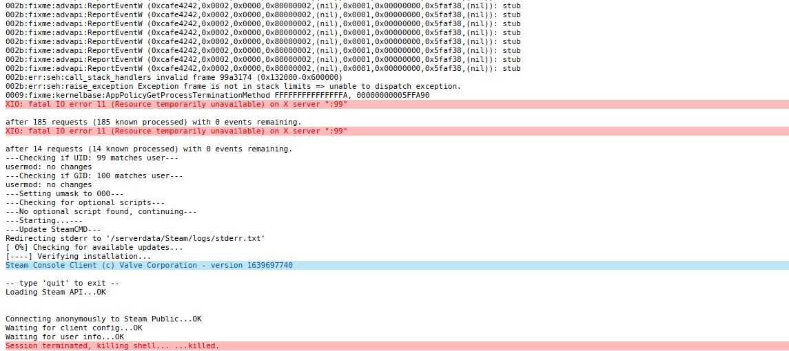

  17. Yes 10TB Yes the appdata pool is set to Prefer Cache. I've got the minecraft basic server up and running with the same /mnt/cache/ path and no issues. I was even able to install fabric loader and several mods to it without issue. This conan exiles one has me stumped though. I'm not even sure what this invalid frame error means. That seems to be where it fails. call_stack_handlers invalid frame 99a3174 (0x132000-0x600000)\n","stream":"stderr","time":"2022-01-10T00:58:52.643899651Z"} {"log":"002b:err:seh:raise_exception Exception frame is not in stack limits =\u003e unable to dispatch exception.\n","stream":"stderr","time":"2022-01-10T00:58:52.643916235Z"} I've pulled the docker log for the container if it'll help at all. conanexiles.log Is there any other things I might be able to try? I've never run a memtest on this machine but I haven't had any issues since I disabled HDR mapping in Plex (which was causing the server to crash). I'm not sure this error is a memory error though as I would expect it to cause issues outside of just this docker container if it was. Worst case I just end up installing a Windows server VM and run the conan server there. That's how I have it configured on a Dell R510 I've built this unraid box to replace.

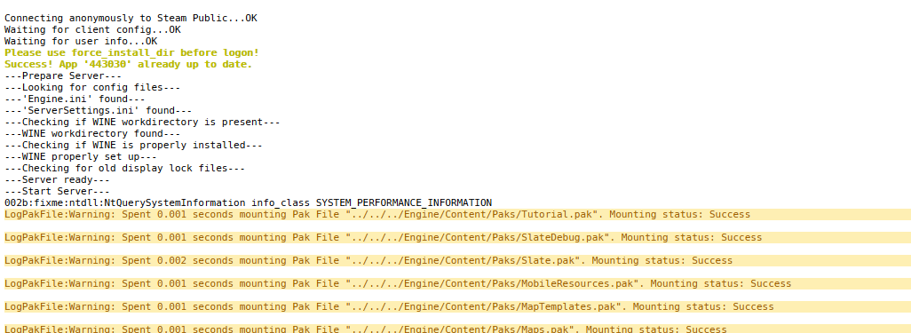

  19. I'm experience an issue attempting to get Conan Exiles up and running. I left the container configuration the same except I changed /mnt/cache/appdata to /mnt/user/appdata. I've attempted with and without Workshop mod IDs and I get the same error. The game seems to download correctly, then I see this: A couple hundred of the yellow lines warning me of time mounting Pak files.... Then finally it hits a fatal error, dies, then the process restarts again. I have to kill the container manually.
