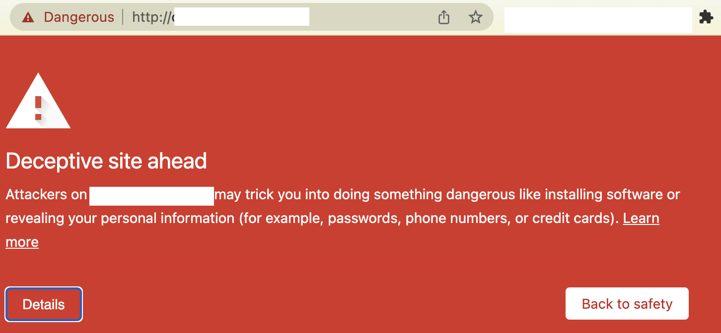

  5. Same here. Just started happening recently. See attached image of Chrome's red warning screen. My first thought was a bad certificate but it's not that (cert is valid). Google has decided the site is unsafe for some reason. It's interesting there are two of us reporting this in one day when thread has been quiet for almost 6 months. It could be the Chrome/Google rolled out a stronger rule or policy. But I'm also worried that somehow my box has been hacked. For now I've reported it as incorrectly flagging my <domain>.com site at this "Report Incorrect Phishing Warning" page. Does anyone know how secure the "NginxProxyManager" docker is? Forwarding ports 80 and 443 to it certainly exposes it to the open internet where it could be compromised.
