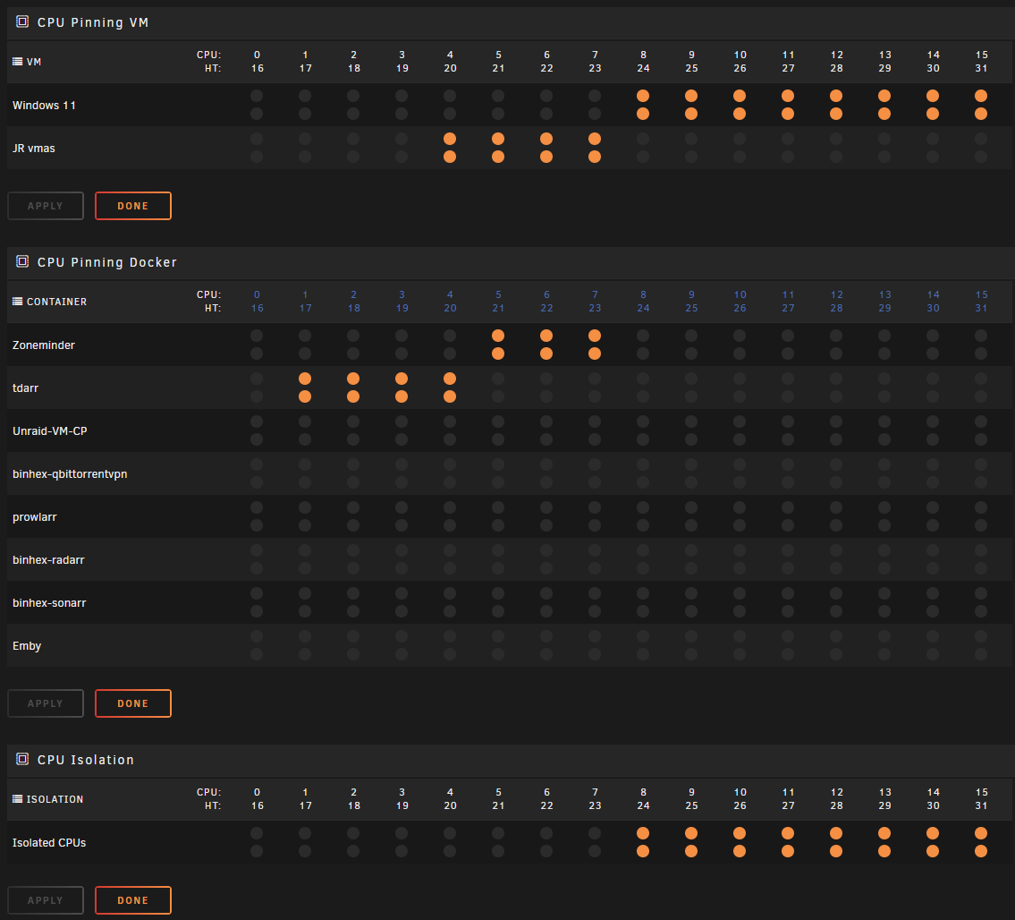

  19. I made the change and the notification still popped up whe I entered the page. root@DataServer:~# cat /proc/cmdline~ cat: /proc/cmdline~: No such file or directory root@DataServer:~# cat /proc/cmdline BOOT_IMAGE=/bzimage initrd=/bzroot isolcpus=11-15,27-31 root@DataServer:~# cat /boot/syslinux/syslinux.cfg default menu.c32 menu title Lime Technology, Inc. prompt 0 timeout 50 label Unraid OS menu default kernel /bzimage append initrd=/bzroot isolcpus=11-15,27-31 label Unraid OS GUI Mode kernel /bzimage append initrd=/bzroot,/bzroot-gui isolcpus=11-15,27-31 label Unraid OS Safe Mode (no plugins, no GUI) kernel /bzimage append initrd=/bzroot unraidsafemode label Unraid OS GUI Safe Mode (no plugins) kernel /bzimage append initrd=/bzroot,/bzroot-gui unraidsafemode label Memtest86+ kernel /memtest root@DataServer:~# cat /tmp/reboot_notification cat: /tmp/reboot_notification: No such file or directory root@DataServer:~# cat /tmp/reboot_notifications CPU Isolation: A reboot is required to apply changesroot@DataServer:~#
  20. From my personal experience you can switch out stream settings. Had the same problem on HLS and it stopped when I switched to Poseidon. Also you are better of defining audio coded instead of copy. Shinobi is a bug riddled mess but the UI is still better then ZoneMinder... Wish this could get updated to the latest version of shinobi...
  21. Before entering /Dashboard/Settings/CPUset root@DataServer:~# cat /boot/syslinux/syslinux.cfg default menu.c32 menu title Lime Technology, Inc. prompt 0 timeout 50 label Unraid OS menu default kernel /bzimage append initrd=/bzroot isolcpus=11-15,27-31 label Unraid OS GUI Mode kernel /bzimage append isolcpus=11-15,27-31 initrd=/bzroot,/bzroot-gui label Unraid OS Safe Mode (no plugins, no GUI) kernel /bzimage append initrd=/bzroot unraidsafemode label Unraid OS GUI Safe Mode (no plugins) kernel /bzimage append initrd=/bzroot,/bzroot-gui unraidsafemode label Memtest86+ kernel /memtest root@DataServer:~# cat /proc/cmdline BOOT_IMAGE=/bzimage initrd=/bzroot isolcpus=11-15,27-31 root@DataServer:~# cat /tmp/reboot_notifications cat: /tmp/reboot_notifications: No such file or directory After Entering root@DataServer:~# cat /boot/syslinux/syslinux.cfg default menu.c32 menu title Lime Technology, Inc. prompt 0 timeout 50 label Unraid OS menu default kernel /bzimage append initrd=/bzroot isolcpus=11-15,27-31 label Unraid OS GUI Mode kernel /bzimage append isolcpus=11-15,27-31 initrd=/bzroot,/bzroot-gui label Unraid OS Safe Mode (no plugins, no GUI) kernel /bzimage append initrd=/bzroot unraidsafemode label Unraid OS GUI Safe Mode (no plugins) kernel /bzimage append initrd=/bzroot,/bzroot-gui unraidsafemode label Memtest86+ kernel /memtest root@DataServer:~# cat /proc/cmdline BOOT_IMAGE=/bzimage initrd=/bzroot isolcpus=11-15,27-31 root@DataServer:~# cat /tmp/reboot_notifications CPU Isolation: A reboot is required to apply changes Attached diagnostics after clean boot before entering the page (no notification) and after (with notification). Before: dataserver-diagnostics-20250120-2223-Before.zip After: dataserver-diagnostics-20250120-2228-After.zip

  23. root@DataServer:~# cat /boot/syslinux/syslinux.cfg default menu.c32 menu title Lime Technology, Inc. prompt 0 timeout 50 label Unraid OS menu default kernel /bzimage append initrd=/bzroot isolcpus=8-15,24-31 label Unraid OS GUI Mode kernel /bzimage append isolcpus=8-15,24-31 initrd=/bzroot,/bzroot-gui label Unraid OS Safe Mode (no plugins, no GUI) kernel /bzimage append initrd=/bzroot unraidsafemode label Unraid OS GUI Safe Mode (no plugins) kernel /bzimage append initrd=/bzroot,/bzroot-gui unraidsafemode label Memtest86+ kernel /memtest root@DataServer:~# cat /proc/cmdline BOOT_IMAGE=/bzimage initrd=/bzroot isolcpus=8-15,24-31 Diags in previous post.

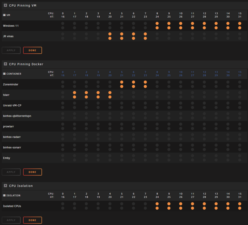

  24. I have a verry similar issue in 6.12.14. When I visit cpu pining page (Dashboard/Settings/CPUset) and change docker pinning it prompts me to restart even though I do not touch Isolation... Is this normal behavior? I had the verry same kind of problem with VM manager where enterring the page would also cause the message to instantly pop up. The cause was either 'PCIe ACS override' or 'VFIO allow unsafe interrupts' setting once I removed them it solved the issue. Problem is I need CPU isolation x docker pinning so it would be annoying having this message show up every I change docker pinning... dataserver-diagnostics-20250116-0341.zip
  25. All my changes were done with GUI. Apparently the cause was PCIe ACS override or VFIO allow unsafe interrupts. Once I dissabled these the message no longer appears. These were left over from pfsense VM with mobo ports passed through to it. I forgot to remove them once I got a physical machine for pfsense. No idea why the message kept appearing though...
