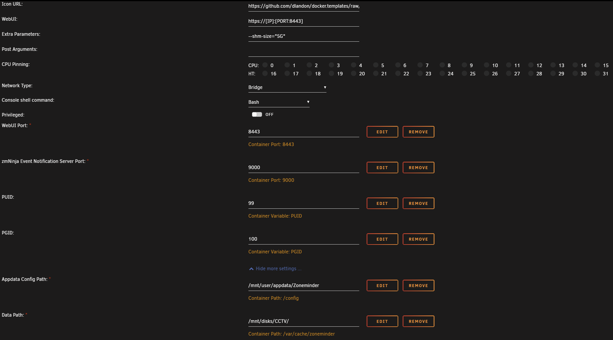

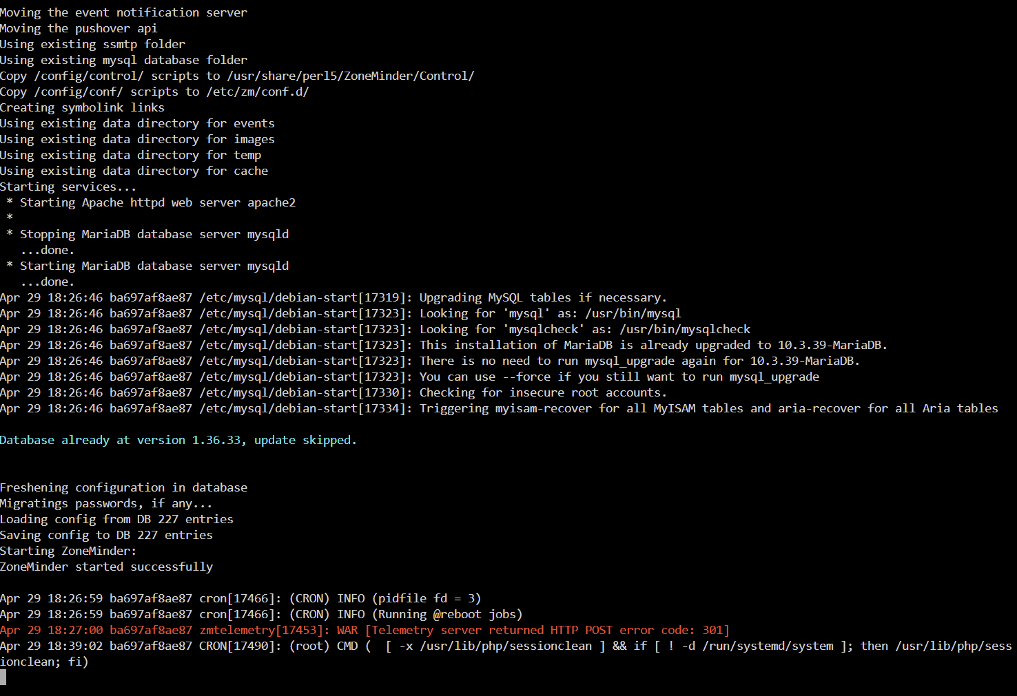

  5. Hello, I am trying to install this docker and get it to work with my TP-LINK c430 camera. This is my 1st time setting up CCTV so I am just experimenting with every setting. Now some weird thing happened. Here is the story. I was able to install the container and run it as network type: bridge. I was able to access its webUI and tweak camera(monitor) settings. Yet I was not abble to get it to connect to my camera. My bright idea was that maybe docker bridge is isolating the container from my external network thus I switched to Custom: br0 - This should expose the container to the network. Container worked fine. But no camera access same as before. Lots of tweaking and curisng TP-link for not using default ONVIF or webui ports later I found the correct URI for ONVIF and RTSP. Yay everything works - I see my camera and can record. Hello World! But then I had this bright idea: Wait... Maybe the problem was actually the URI and ports instead of the network type? Lets Test! Switched back to bridge... RIP... No more web UI... Now it redirects to my login screen. BUT WHY?! Found that in the advanced settings for container the WEB UI url was set to https://[IP]:[PORT:443]/zm instead of https://[IP]:[PORT:8443] for bridging the ports? Fine fixed that now. Still nothing... And this is where my ideas ended. I see this error in logs as well: These are my container settings: I realize I might be doing something stupid and completely unrelated to this container but maybe some one can spot what it is?

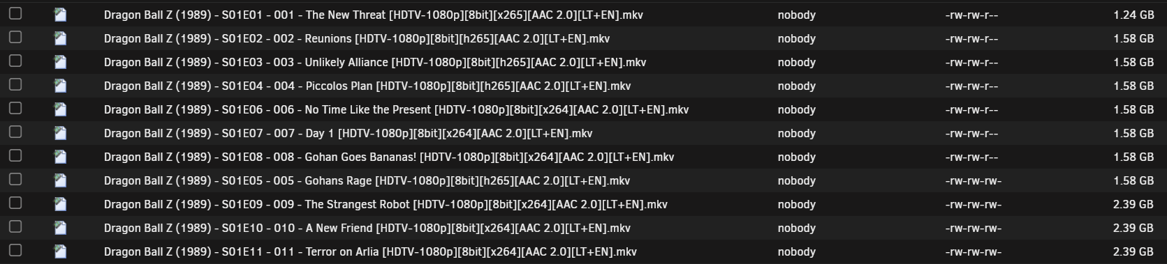

  14. Hello, Why does tdarr change permissions of transcoded files? I am doing a few test runs before letting it rip on my full library but I noticed this permission change from -rw-rw-rw- to -rw-rw-r--. I tried adding Tdarr_Plugin_0800dCTlb Set File_Permissions_For_UnRaid but this just errors out with 'Operation not permitted'. Any suggestions how to keep default permissions after Tdarr?
