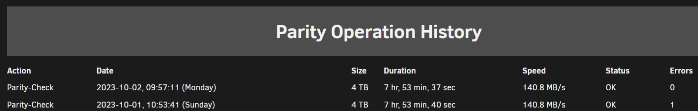

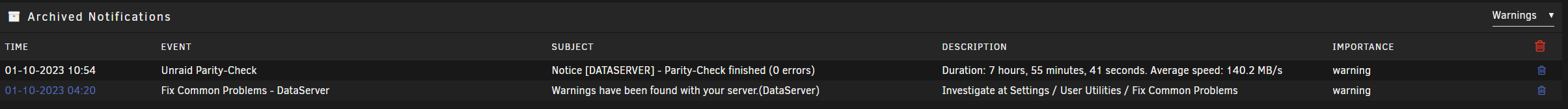

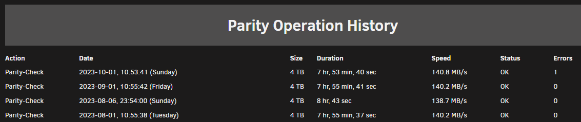

  6. I ran a correcting check but it came back with 0 errors... Notification also consistently shows the previous parity checks result I really have to wonder where this 1 error came from...
  7. Yes. I checked. It says I have 1 error. What should my next steps be as it was a non correcting parity check that found it? I'd like to identify the cause. Attached diagnostics. dataserver-diagnostics-20231001-1517.zip
  8. Hello, I ran into this weird situation where notifications say that my parity check came out clean yet the parity history says I had 1 error. Notifications: Parity history: I wonder what should I believe... Notification seems to be reporting last parity check instead of the current one (speed and time difference)? I run non correcting parity checks monthly. Had no issues for ~1 year. But now since 1 error came up I wonder how should I correctly handle it or identify which drive it came from? There are no smart errors logged from any of my drives... Or should I just run a correcting parity check and forget about it?
