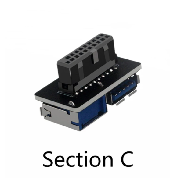

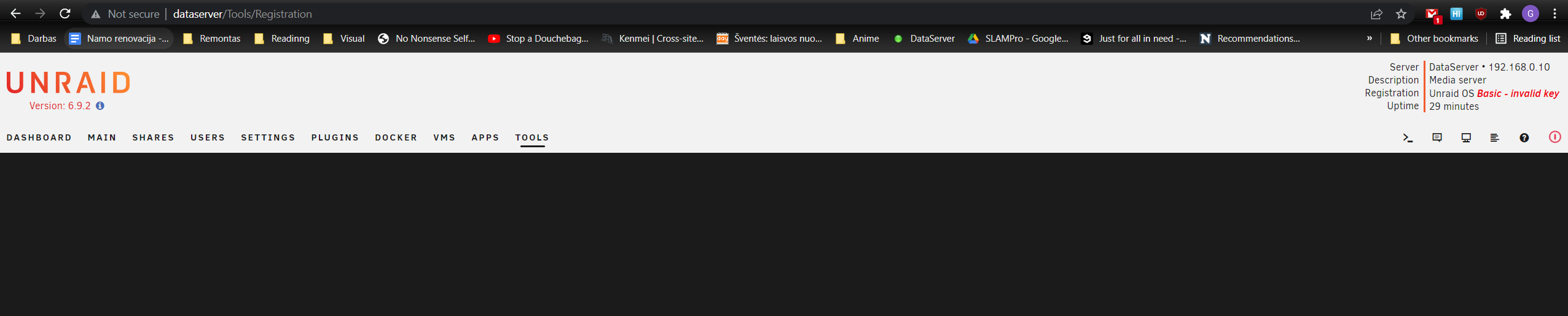

Hello, I just replaced my unraid USB stick. My old one got fried as I tried to install an internal USB3 adapter... I got my backup from unraid forums my servers tab. Everything booter up and now I need to replace my key, but as I enter the registration page I am greeted with a blank page: Attached diagnostics. Some more details: Installation on my new stick was only successful trough running make bootable after copying everything from the backup zip. PS: I really need to have this server up by morning... dataserver-diagnostics-20220318-0112.zip
