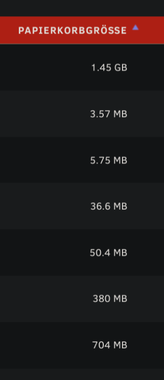

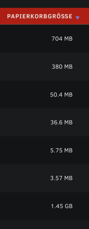

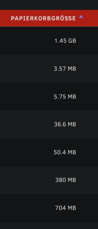

  15. Very Sad! I hope, NFS implemented this in the future. Yes, 1,45 GB must the first or the last Entry. He is bigger than 704 MB.
  16. Can you fix the Sorting? Is NFS working or add NFS Support?
