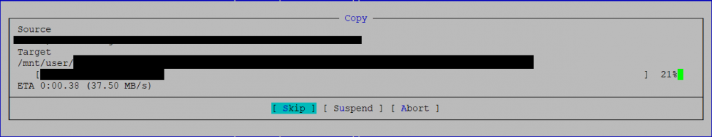

Hi, when I'm copying between one user-share (only on one disk) to another user-share (splitted over serveral disks) I get only about 15 to 35 MB/s. Tried with Windows (SMB) and Midnight Commander directly on the server. When I am copying directly from my Windows machine to the user-share I get full speed (around 160 MB/s as the Windows machine is an VM with virtio network driver). Reading speed from source user-share is also fine. Why does unraid is doing this?

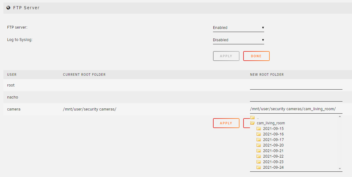

FTP server in 6.9.2 allows write access to shares it shouldn't.
Is there anything what we (users) can do to push this topic on github?
