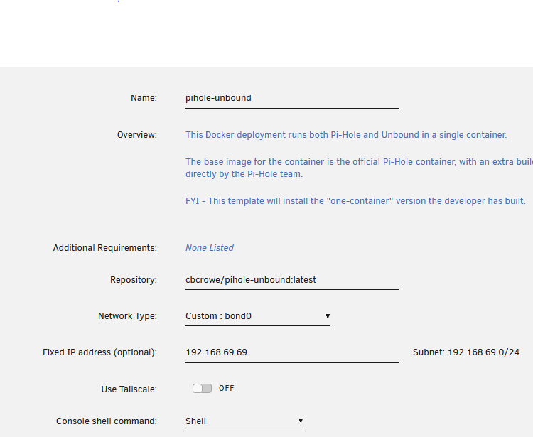

No IP assigned for br0(docker) containers
I can change it back. Since I posted about this, I changed the docker custom network type to macvlan since I saw that they fixed it. That changed my network to bond0. But I didn't get an IP assigned regardless. I'm now switching back.
Ahh, I'm sorry that I did not make that clear. That was already filled out. I am able to reach my pihole through that IP. But neither my pihole or my swag container are getting IP leases from my router. I even added the lease using the container MAC but nothing.
Here are my diagnostics if this helps. I checked out ifconfig but did not see anything listed for the ip address that shows in the Docker tab for my container. tower-diagnostics-20250115-2142.zip
I have searched the internet and no one seems to have the same issue. I hope I'm wrong and someone can steer me to where others have gone before. My docker containers that are on the custom br0 network do not get assigned an IP from my router. These are the ONLY things on my network that are not automatically assigned. Unraid gets an IP just fine. I have Home Assistant running in a VM - it gets an ip. I have SWAG and PiHole setup on br0. Neither gets an IP assigned from my router. Both are reachable by ping through their IP addresses set in the container themselves. Docker settings: Docker custom network type: ipvlan Host access to custom networks: Enabled Network settings: Enable Bridging: Yes
