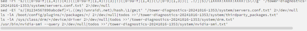

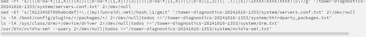

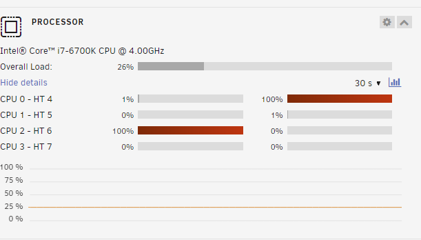

  3. I had a chance to bring the array down and try the nvidia install again, which worked fine. Like last time the diagnostics froze on 'nvidia-smi --query 2' command. I ran it manually within the console and it also hung up. Two CPU cores were pegged at 100% during both of these. And because I like poking my tongue on a painful tooth, I also tried going to Settings->Nvidia, which froze UNRAID again. I hard reset it, removed the nvidia driver, and restarted the array without issue. I'm beginning to think that I damaged the GPU during my work on the chassis last week. I tried going to the root of the flash to find the temporary diagnostic folder the diag operation makes, but it got deleted with the reboot. Other diags still exist on boot/logs.

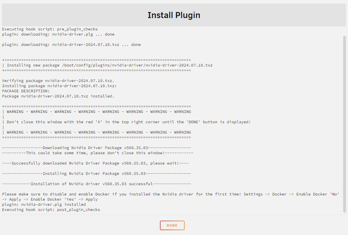

  6. I had this running great, following these instructions. I was trying to upgrade my RAM and ran into a cascade of problems, one of which is now any attempt to reinstall the NVIDIA driver causes my entire system to freeze, requiring a hard reset. I had to remove & replace the GPU to get to the RAM slots. UNRAID sees the device, the install works fine, but when I go to look at the NVIDIA driver information under settings, the entire system freezes within 20 seconds, and I never get any the NVIDIA driver page to come up. Any help would be appreciated. PLEASE NOTE: All equipment in my device is the same as it was before, when the GPU was humming along. The only difference is I had to replace my parity drive. Parity has been re-written, and parity check has run a few times. I had a massive Docker issue at the same time I was wrestling with the GPU, which required me to reinstall the docker.img file hwProf.xml tower-diagnostics-20241014-1006.zip
