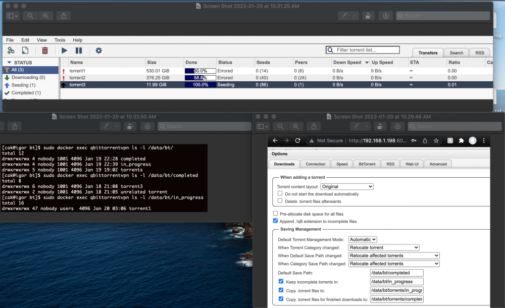

  2. The errored state seems to have been an unrelated issue. I restarted the container and then restarted those torrents and they were able to download without issue. Moving them all into the container at /tmp didn't make a difference except maybe with transfer speed because of the kind of drive it was using. I moved everything back to where it was and I am getting good download speeds. I'm not sure which change made the difference, but the completed torrent that I am seeding is now uploading very slowly, less than 50 KiB/s. The other two still show zero. I can check my router's bandwidth monitor to this device. When the torrents are paused there is zero activity in either direction. When they resume the bandwidth monitor reports about 10-100x the transmission in both directions than the torrent client does. 5-10 Mb/s upload instead of 50 KiB/s. 300 Mb/s download instead of 30 Mib/s. This seems like a whole lot for protocol or encryption overhead. Any idea why this might be?

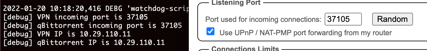

  3. I think this is everything you've asked for. There's a screenshot that verifies the ports matching, one that confirms the directory structure, and the logs from the most recent run of qBittorrent. In all cases torrents were anonymized with inspect element/manually editing output. Do I need to do anything with port forwarding in my home router settings? Or is that all managed by PIA? qbittorrent.log
