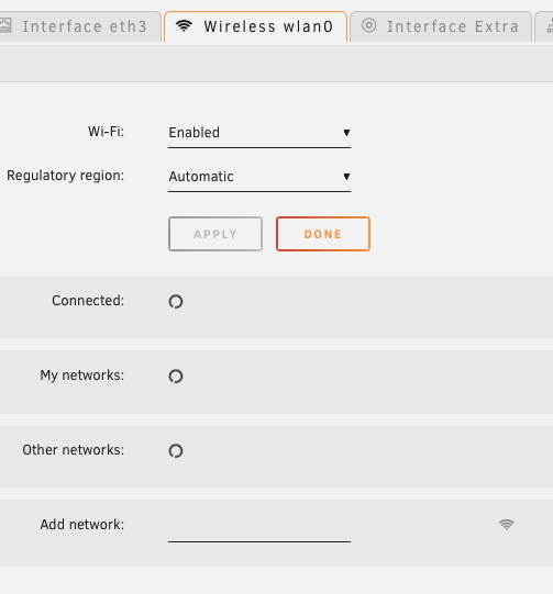

WiFi list keeps empty and the wheel is spinning and spinning 7.1.0 rc1
Hey @JorgeB, I set my region to Germany but the lists remain empty (cirlcing without seeing any wireless network). Also tried to add a Network by my own but not possible. Please find attached the diagnostics file. Let us continue here: Thanks a lot. unraid-diagnostics-20250416-1201.zip
Hey @JorgeB, Even after entering the Network I cannot save it
Hello all, I run now Unraid 7.1.0 rc1 and wanted to test the Wifi connectivity but the only thing I see are spinning wheels. I also checked lspci and it seems the WiFi card recognized just fine. 5c:00.0 Network controller: MEDIATEK Corp. MT7922 802.11ax PCI Express Wireless Network Adapter Any idea what it could be? Cheers
