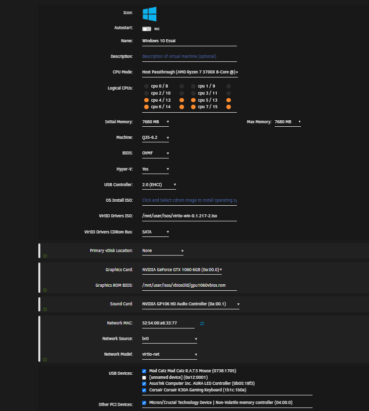

  6. Hello ghost82, thanks for the answer. I've attached the full diagnostics. This should be the symptom that the gpu is in use by the host. Sorry for my lack of knowledge, but how can I find if the GPU is in use by the host and how can I fix it? mydeedee-diagnostics-20220604-2007.zip
  7. Hello guys, I have got a MSI GTX 1060 6g that I want to passthrough with bare metal Win 10 Pro. Wathever I've tried, the graphic card returned the error 43. Win 10 works fine. I've already follow this threads without success: I've looked for some common problem and don't worked for me: - I've looked for some virtualization problem in my BIOS. - I've tried Q35 or i440fx machine. - I've tried to disable Hyper-V - I've followed the SpaceInvaderOne tutorial for GPU passthrough and edited my XML. - I've tried dumping my vbios with SpaceInvaderOne script but it crashes with the 6.10.x unraid version. So I've tried to use a working Vbios I've allready done and tested. Any help will be appreciated 🙂 VM WIN10Pro.txt Logs.txt
  8. Thanks a lot ghost82. Replacing the seabios was the solution, I've reach Windows with VNC. I hope seabios will be update soon in unraid stable distro. Well done
